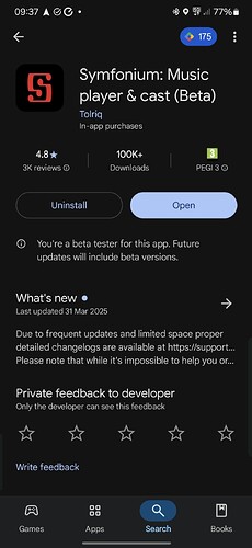

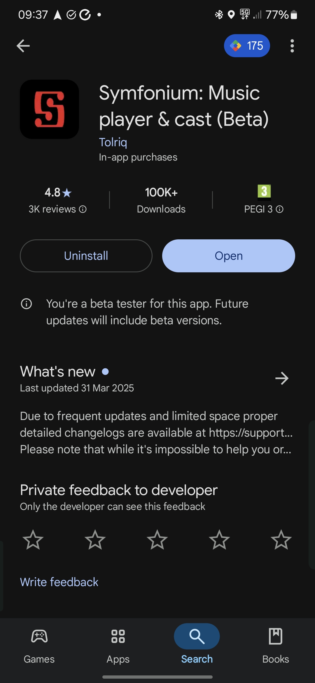

Any thoughts on my ongoing issue
Try with the beta version.
The last update is from yesterday so have you tested with the new version and still have the issue and provided new logs ?

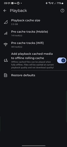

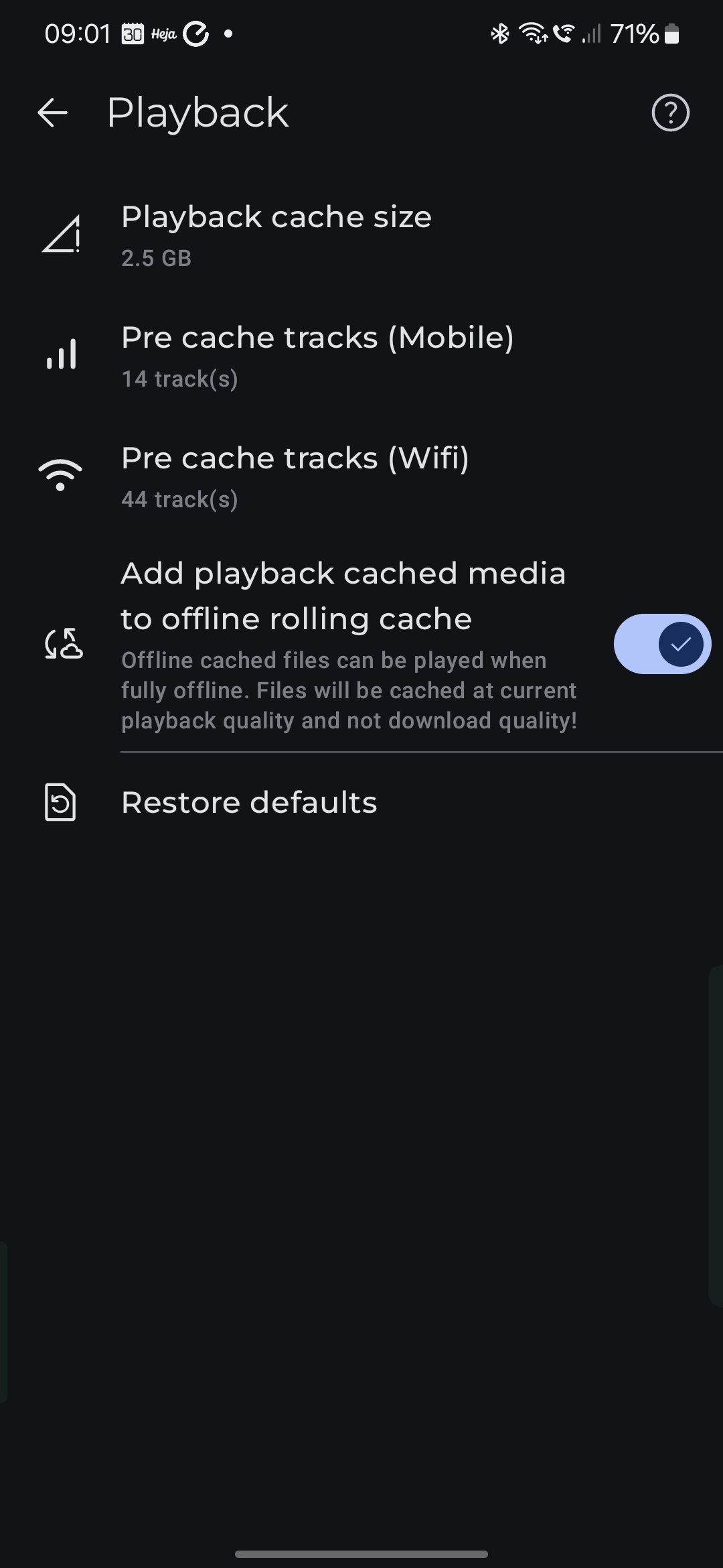

To be sure you should try to clear playback cache too.
