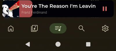

Hi,
My player seems to alternates between two tracks.

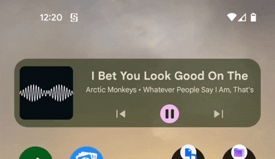

The tracks only skips visually, not the audio, but it sometimes plays the second track twice. It happens with the widget too. I don’t know how to describe this in details, I made gifs.
It doesn’t happen for a while when I pause and resume or when I skip manually, but it always comes back eventually.
Sorry if this issue has been posted before, I didn’t find anything with the keywords I thought of. The problem might come from Sonos but I wanted to check.
