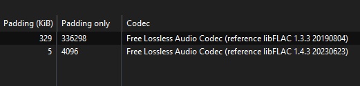

Tags seem fine (except for an excessive padding of 329KB, probably because the file used to have an embedded cover which was later on removed but the excess padding remained).

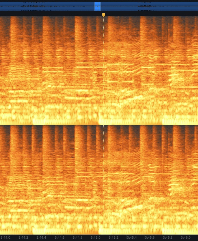

In the video, Symfonium stops playing at 03:45, so I took a closer look at the audio from 03:44 to 03:46, however there’s also no obvious error like missing parts there.

Honestly I can’t find anything wrong with that file except for the not up to date codec (1.3.3 from 2019 vs 1.4.3 from 2023) and the excessive padding, which combined make your file a bit bigger than it needs to be and both of which can easily be fixed by running flacr on it in recompression mode.
padding
Left original, right after recompressing it with flacr.
orig vs flacr
