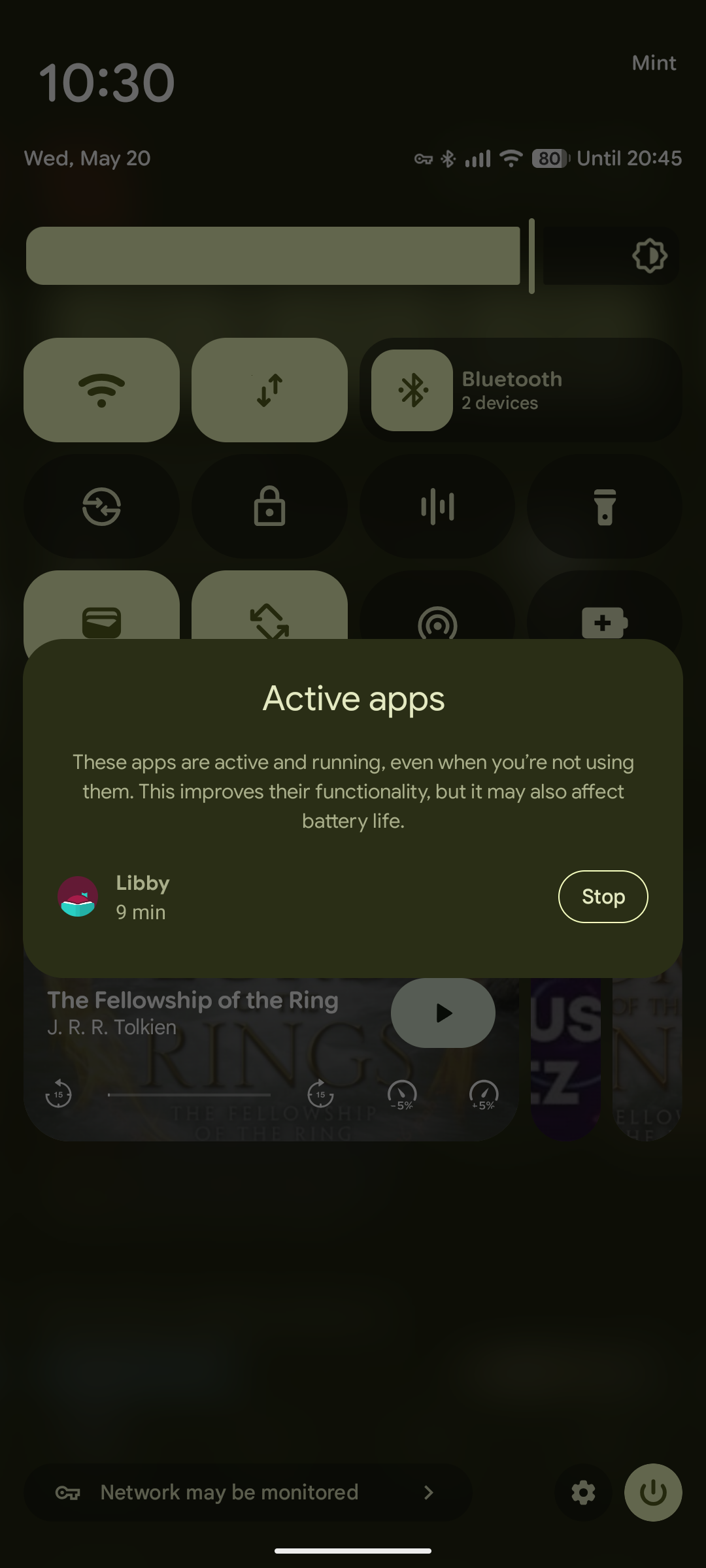

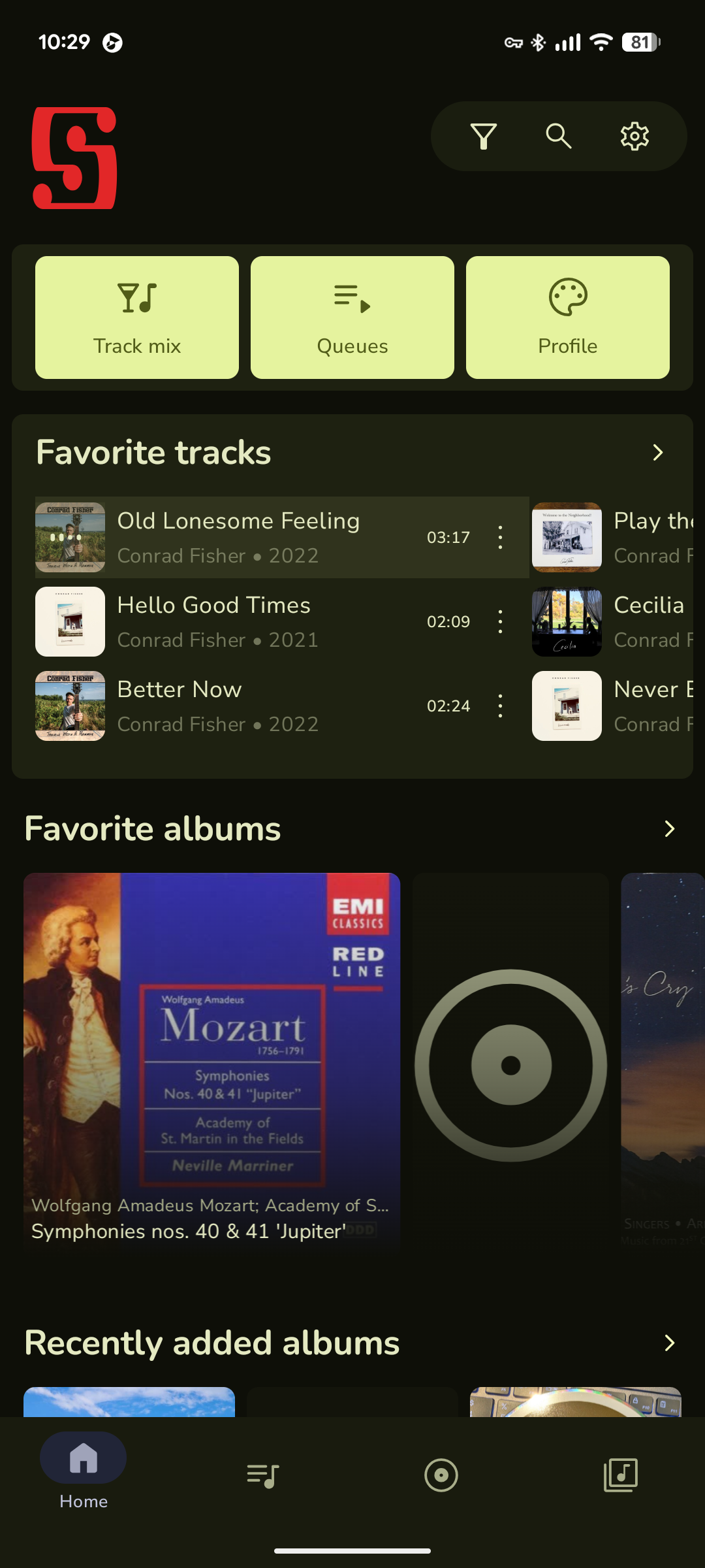

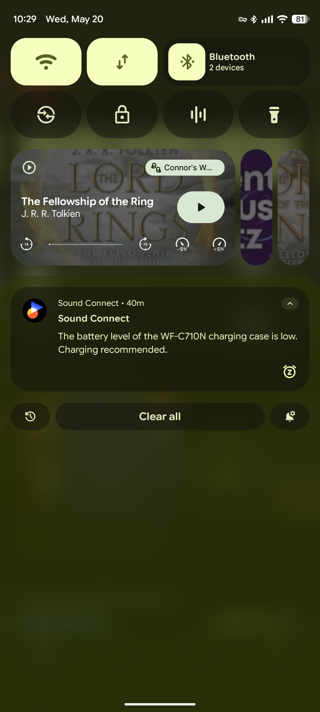

When I play something, whether it is music or an audiobook, the now playing screen in the app does not appear, but audio does play. At the same time there is no media notification/player in my phone’s quick settings. Then approx. 6.5 seconds after I leave the app the audio stops. Also the app doesn’t appear in the “active apps” menu in quick settings like it usually does. It did the same thing with all the media providers I use: Jellyfin, OneDrive, Local, and Audiobookshelf.
This happened after I updated to Android 17 QPR1 Beta 3. I checked and the app still has unrestricted battery usage. I also looked at its permissions and the “music and audio” and “notification” permissions were denied, but allowing them didn’t seem to make a difference. The “nearby devices” permission was partially allowed, but even giving full allowance didn’t make a difference that I could tell.
I’m not sure who’s problem this is exactly, but there are other audio apps that seem to work right.
