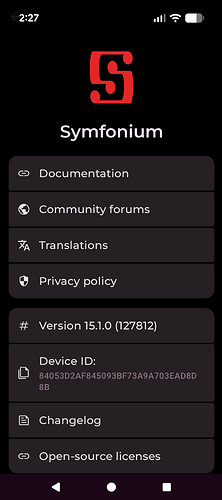

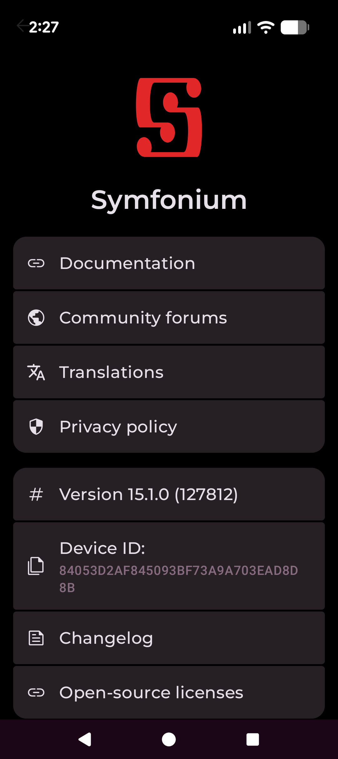

Per previous support response, I have installed newest version, 15.1.0 , and am still unable to have my phone connect to the Schitt Magni amp. Music freezes at 0 seconds. Please see debug log.
  1. Installed 15.1.0 app version
  2. Connected phone to Schitt Magni amp
  3. Select and play several tracks from album
