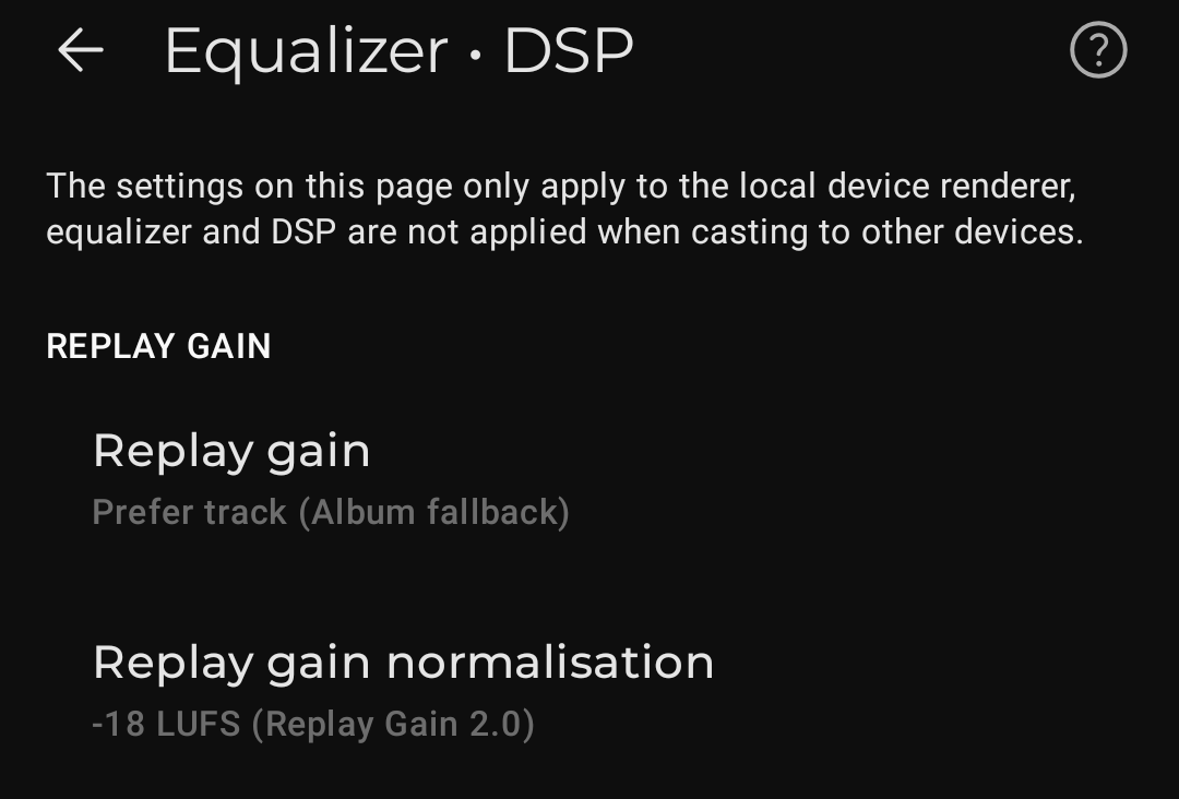

As far as I can tell, this problem still exists. Opus files are still more quiet than other files when using ReplayGain. It would be amazing to get this fixed - it is quite annoying to hear the loudness go up and down across songs simply because some are opus files and others are not.
I am happy to provide new sample files, too.
Thank you!
Do not forget to actually enable normalization;)
It is enabled and works across my non-opus songs!
Then open a proper issue! (See I can put ! too :wink:
But pretty sure you did not actually read the sentence and enabled the actual RG normalization option :wink:
I don’t know what is up with the tone, did I offend you somehow?
I don’t know which settings you are referring to specifically, is it these?
If I need to enable something else, please do tell.

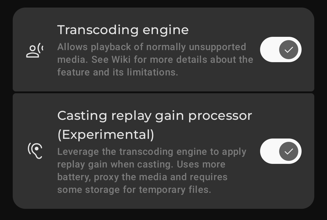

Unfortunately, I can’t help on this matter as I’m not facing the issue anymore, but it may be because I’m transcoding my files with EasyAudioSync, and I’m using this feature: https://i.imgur.com/5oK80j4.png
Because of this feature, I don’t think I need the feature originally requested here and therefore, I can’t tell if Symfonium’s feature works as intended.
As shown in the screenshot, the normalisation was already enabled.
I had it set to -18 LUFS before, and that did not work. Upon further testing, it seems to work correctly when set to -23 LUFS. So either the clipping protection or something like that kicks in, or the -18 LUFS option does not work correctly. In any case, with -23 LUFS it seems to work in my quick tests.
And sure, I will be opening a new issue if the need arises. Since it works with -23 this solves it for me personally anyway.
