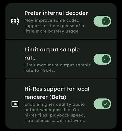

I got very close to a solution, but not quite:
Different combinations of these 3 settings pictured below sometimes worked to remove the distortion. Mostly when they all were turned on, but sometimes when either the sample rate or the Hi-res setting was turned off. I got it to work with a second set of headphones (Sennheiser PXC 550-II). For a while, but then tried it with the jabra and couldn’t get the same result. Then when I tried with the sennheisers again the distortion was back there too, and I could not manage to get it to work there either again. Very finicky.
