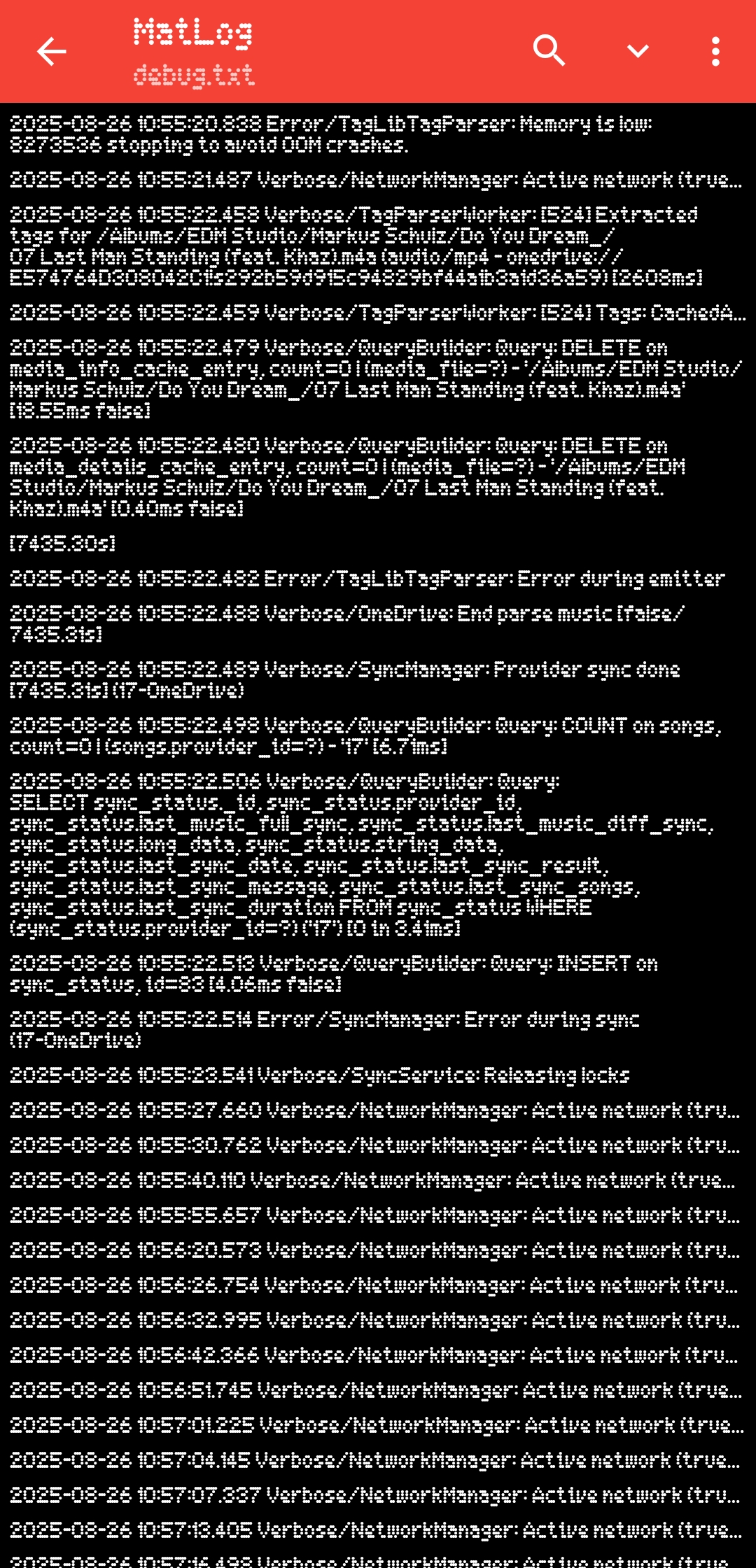

It won’t sync. It gets somewhere around 50k files and then just drops the sync. From my limited knowledge in reading the log it looks like it shows a “low memory” error and shuts down from that but idk what the heck that could be as I have 200gb of free space and my phone has never had this error before about memory.

The only thing I saw in the logs was a memory low error but idk what that means exactly. It also looks like that markus schulz album might be causing a problem. I’m removing it for now just in case.

Well yes there’s not enough memory to finish the sync it seems.

But what does this mean as I have no issue with any other provider? Is it a memory leak while scanning or symfonium holds all the data in RAM until complete and that’s why it’s failing? I guess I’ll have to merge everything back to gdrive for now. That’ll be fun lol - moving 900gb of remote files eesh!

The issue is weird. I don’t understand why the sync process holds up system memory the way it does. It absolutely exhibits signs of a memory leak, my phone starts to slow down and lag like crazy and I have never seen that from a sync ever. I am syncing a lot of small eps and singles so I guess just the sheer amount of files and the like is the problem but I don’t know.

I can’t get it to work anymore. I will say this - when I previously used mp3s in my onedrive it seemed to work OK, meaning small file sizes, now most of my music is a form of lossless and it is 10 times the size of an mp3. All I can guess is that due to the large file sizes and the time it takes to read the amount I have (you said 240 gb, I’m just shy of 2 tb…) it is triggering some time out error or it’s cacheing files faster than it clears them back out of memory causing the slowdown and subsequent failed syncs.
