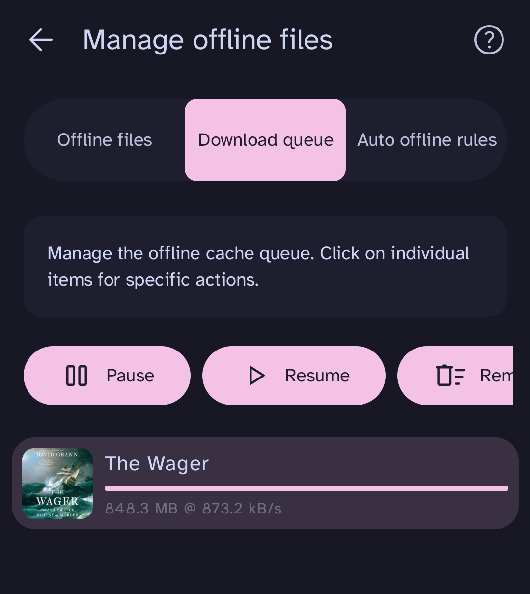

Offline file download continues well past actual file size
Hello! First of all I want to say a big thanks for building such a flexible and easy to use app, its audiobook support far outstrips Plexamp’s and I love being able to tweak it just how I like.
I’ve been having an issue recently whereby when I try to create an offline backup of one of my audiobooks, the download manager just continues endlessly, way past the original file size. I’ve tried getting the exact same file through Plexamp and that seems to work without issue, so I’m wondering if it could be something on the Symfonium side. Logs should hopefully be uploaded - any help will be hugely appreciated!
Upload description: asongtoruin_202531
Attached screenshot is for a 200mb-ish file

The logs does not show the start of the download so hard to tell, but your server is happily sending the data that Symfonium store as received.
Something happens on server side.

Hum you are connected via PlexRelays that enforce a BW limit, and Plex for unknown reasons force transcode to MP3 despite the media being under the limit and then generate a bad mp3.
Lot of strange stuff on Plex side here :frowning:
Do you think you can send me an invite to the server to support at symfonium dot app for just that file so I can try to reproduce and find a workaround ?
