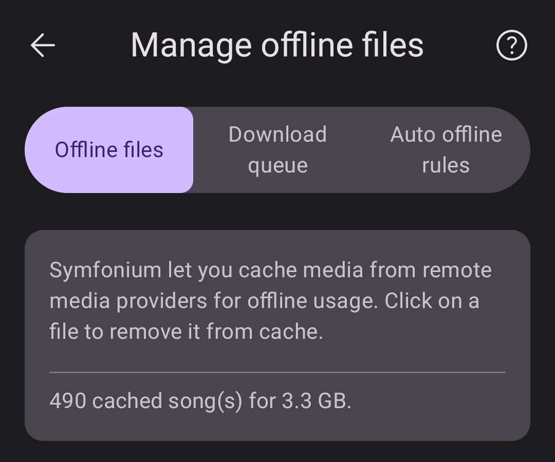

I have 490 offline files. They show up if I turn on airplane mode and start symfonium.

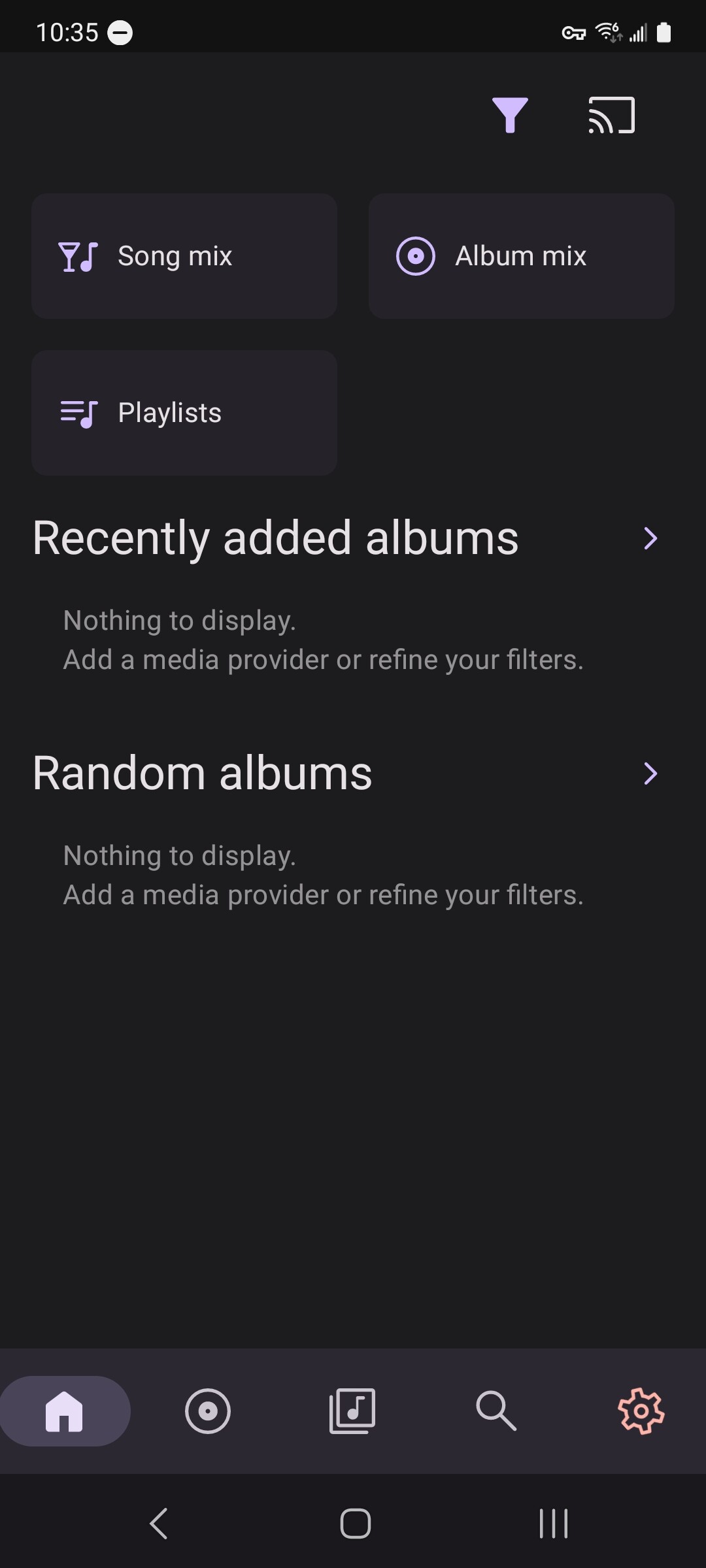

I noticed that the songs appear for about 1.5 seconds and then dissapear once it can’t find the media provider. Here is a screenshot of the page I get.
Please show the content of the filter at the top.
Ahh… I see! The Hide unavailable providers toggle was set to on. I didn’t realize that option even exists. This option persists between restarts and Media available offline does not. Maybe these filters could be arranged to make it more clear.
