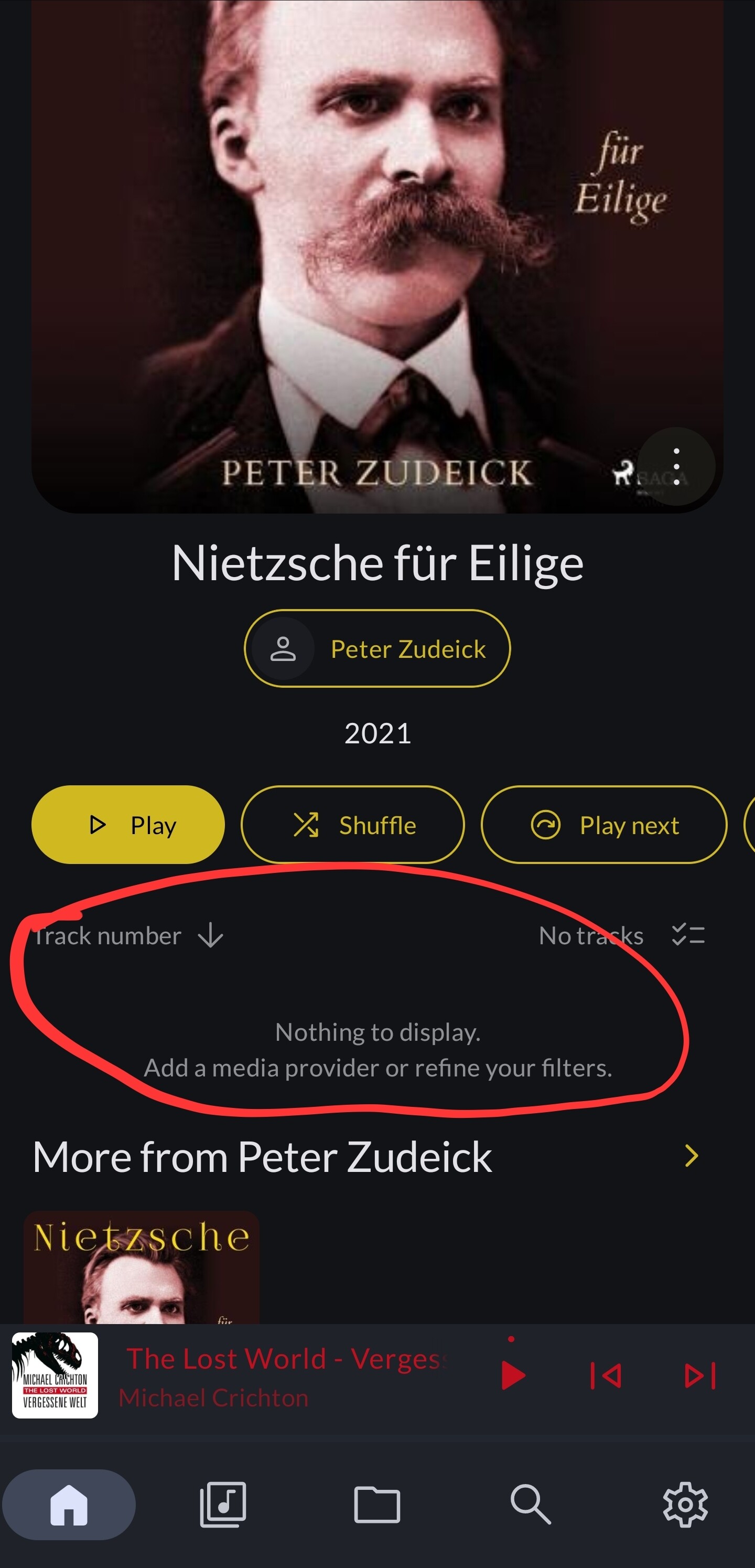

  • The main problem is that there are no tracks listed in any of the albums synced.
  • If I click on the Artists name I can find the tracks available.
  • Below screenshots compared to another Subsonic Music App.
  • I can’t seem to find any setting which provides me the tracks within the album I select.

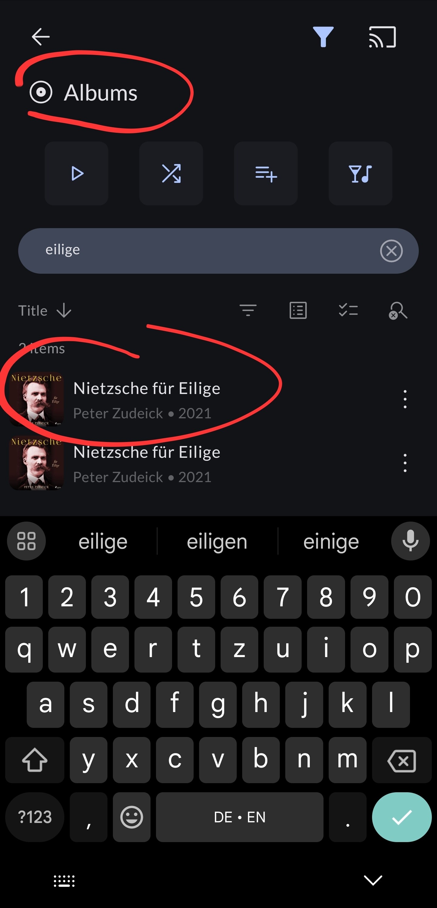

  • Weird is also that there are two albums synced, but imo that’s not correct or I’m just blind, because it’s just one album with that title available, no double on space.

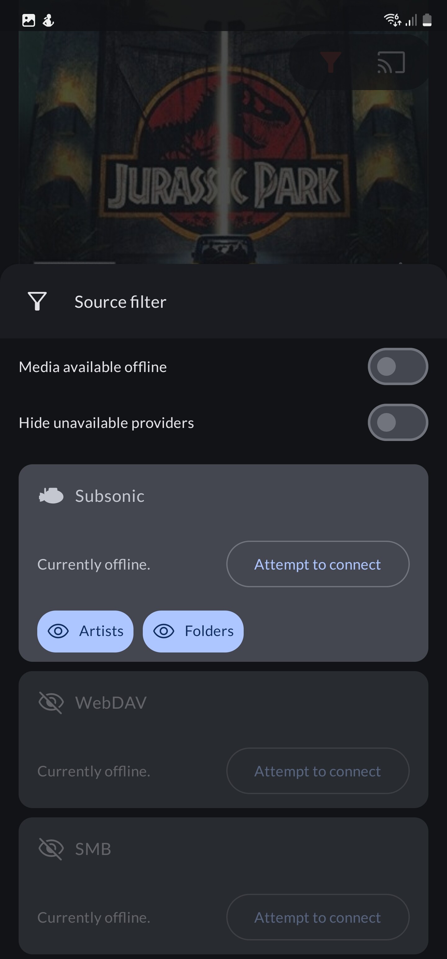

You have a top filter to hide some providers.
Anyway yes your library is small so compat mode is okaish but the author should fix as it says it support the fast mode. Else you’ll need to open an issue on the Music plugin repository.

Edit: no source filter or any provider filter, besides from hiding smb and webdav provider. If you mean that filter as in the screenshot (pls don’t mind the offline state)
