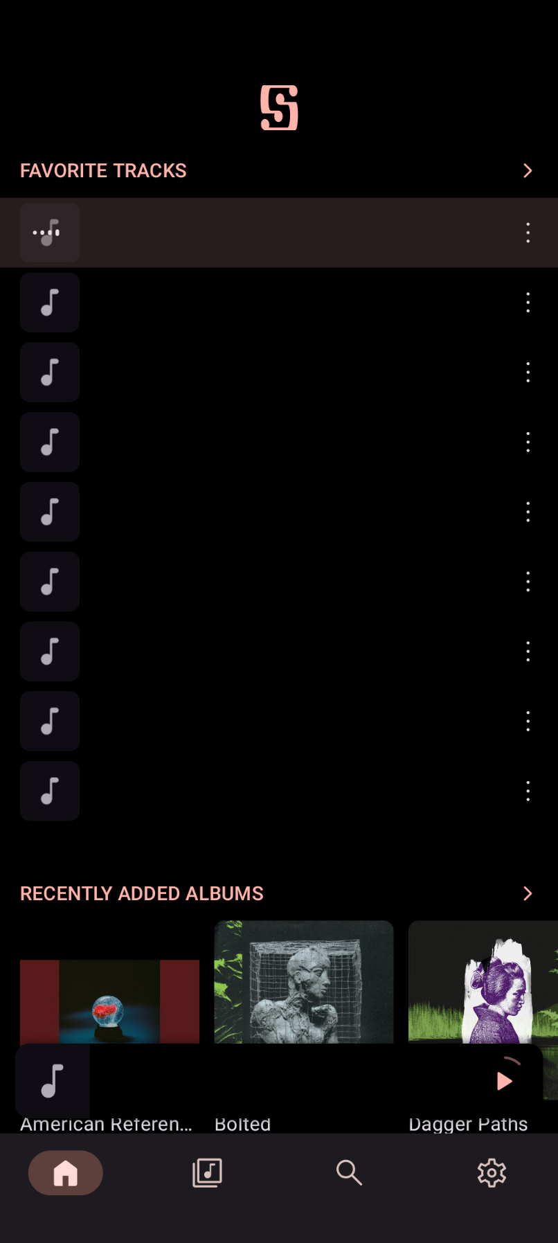

I fixed it. I’m wondering if/how I can restore my favorites? I exported them as a playlist prior to uninstalling but can’t seem to import the playlist, it’s just empty.
They all are in the backup if you made one.
What did you do to fix ? And did you upload those songs as asked because they seemed to be a problem that I need to fix.
I deleted my media folder and re added it to my media provider. Then I uninstalled symphonium and reinstalled it without using my saved backup. Then I did the initial sync and it worked. Can you tell me what you think the issue with the aforementioned songs are? Also the backup didn’t work for my favorites. It just made a list of empty slots.
