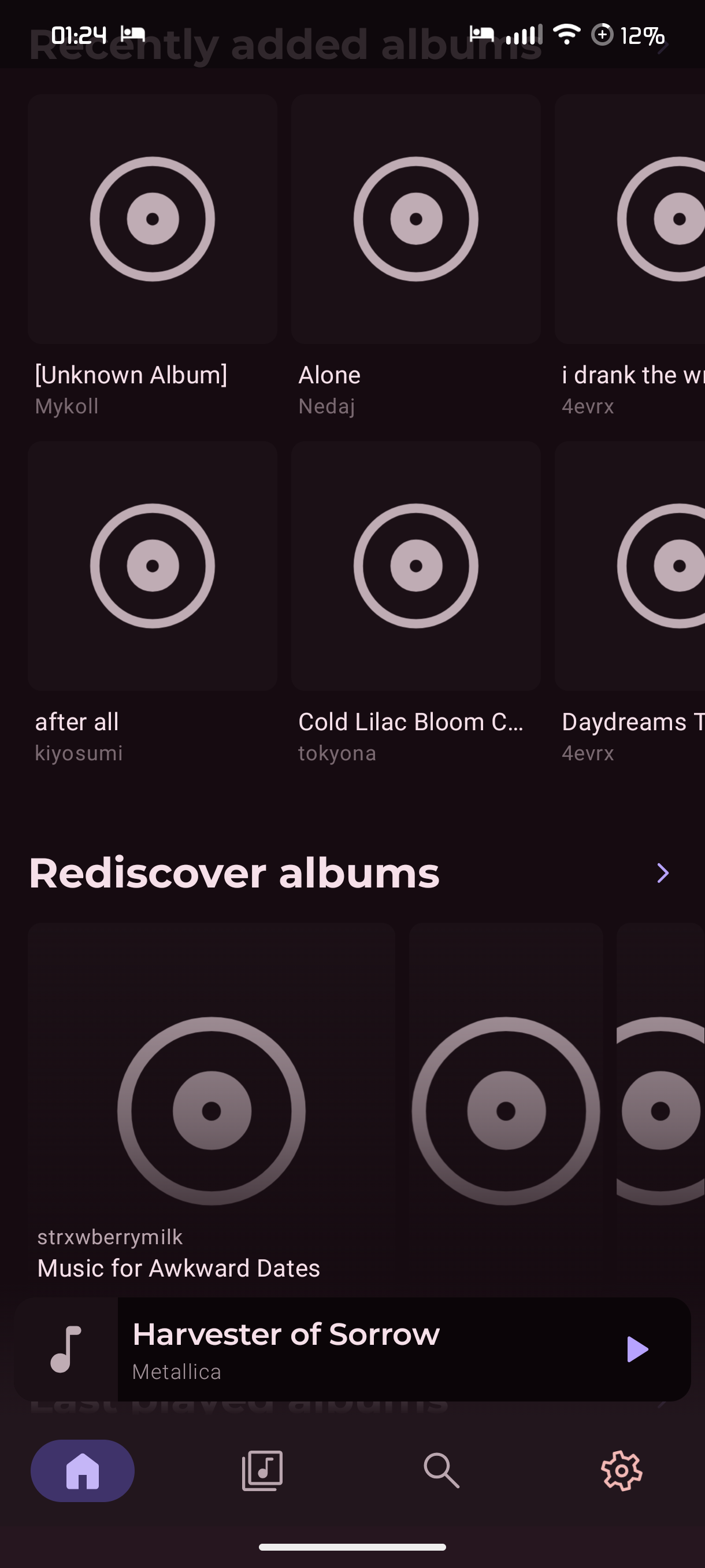

No images for everything
Inside the app, there are no images for tracks, albums and artists, basically everything that has images.
Navidrome
  1. Open the application
  2. Wait for loading to finish
  3. See placeholder images

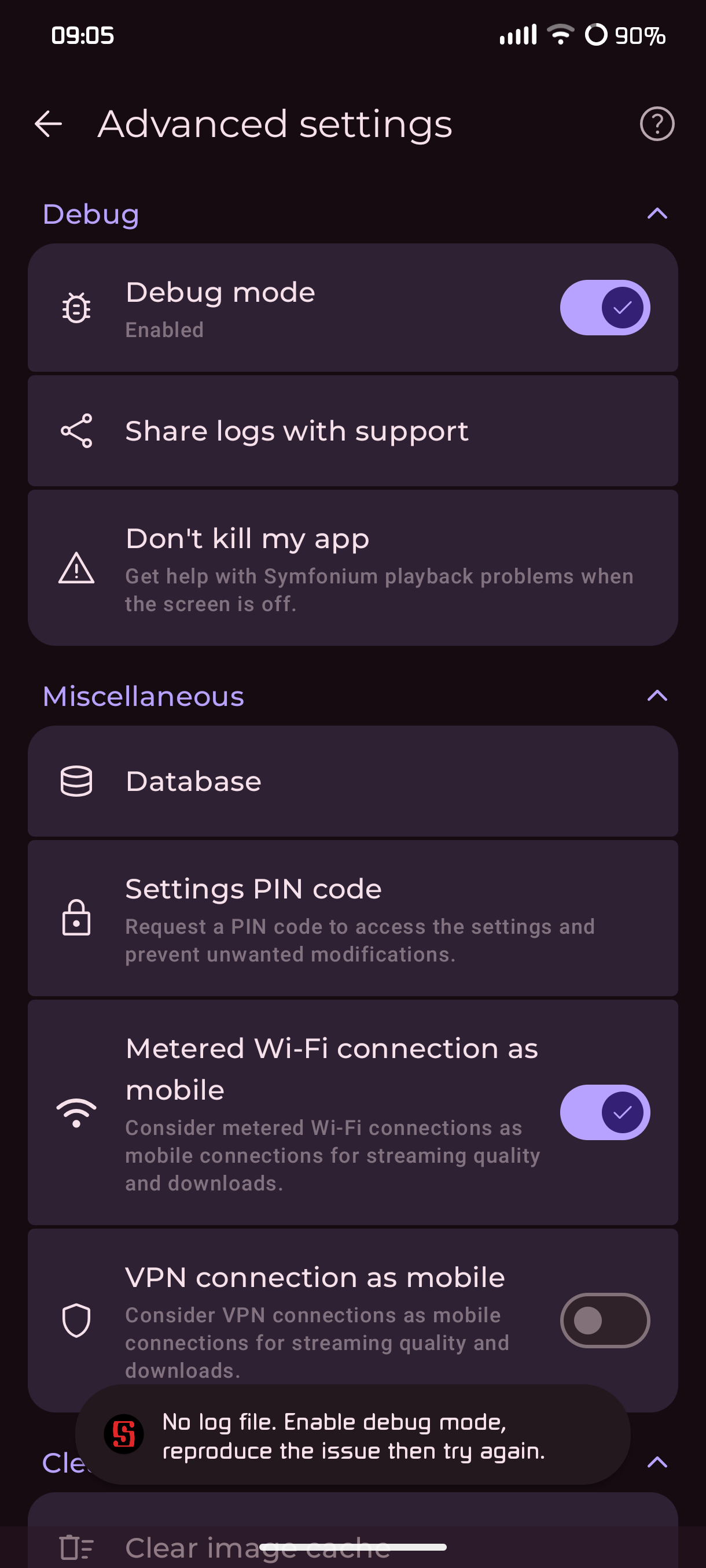

I was not able to create a log as symphonium kept telling me that there were no issues detected.

What did you not understand by your app not providing me the logs. I assume this helps?
You have read the link that the template gives right ?
Explaining you need to reproduce the issue, if you check the box then press share logs there’s obviously no logs generated since you did nothing …
The check box that you check that says logs are mandatory should be a huge hint that they are mandatory and so that it’s probably possible to get them :wink:
So as the template says, enable the debug mode, reproduce the issue by doing a full sync then navigating in the app then upload the logs …
I read that template and I think I’m doing everything correctly but im still not getting logs, here is a video of exactly what I am doing https://imgur.com/a/0ayjr25
And strangely no missing log error :wink: you stop the video too soon, you maybe have an error saying file too big, or something. The link also explains all that and manual upload
