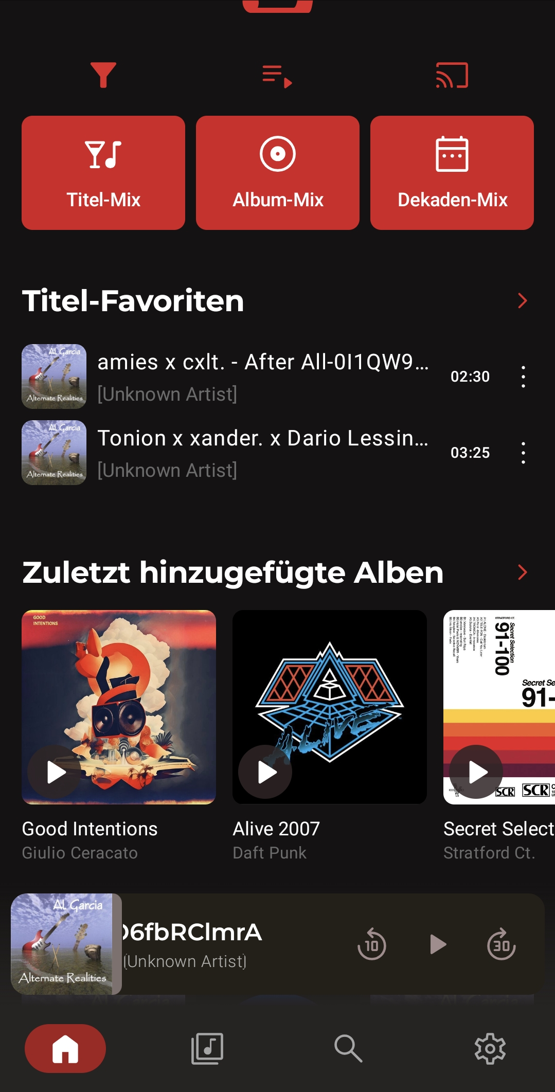

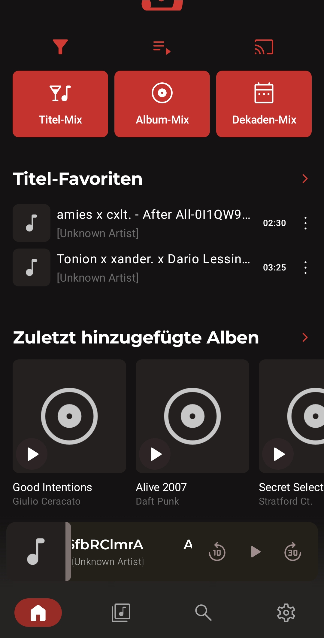

Switch from the admin account to a nonadmin after multilibrary support was introduced in Navidrome. Even though the actual account just changed names and got permission only for the current library, no cover art is displayed in album views even when reenabling admin rights for this account. Changing credentials to the new (actual) admin account reenables album cover art. [Note: A lot of my files dont have cover art, but in this case the ones with cover art dont get displayed album views]

Have Navidrome server with library and admin account. Change name of account, make it nonadmin (with permissions for the library) and create new admin account with the same name and credentials. Check Symfonium: everything is fine. Change Subsonic credentials. Check Symfonium: No cover art in album is displayed (yet it is in Navidromes Web UI)

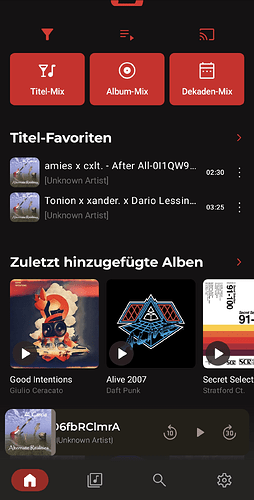

Remove the provider and add it again to remove cached urls that might have issues with the new account.
Then check Navidrome logs.
Thank you very much for your help, that fixed it. Looks like it was due to caches urls, now every cover art is displayed again. I’m sorry for taking up your time with such a simple issue, I should’ve tried this before reaching out.
