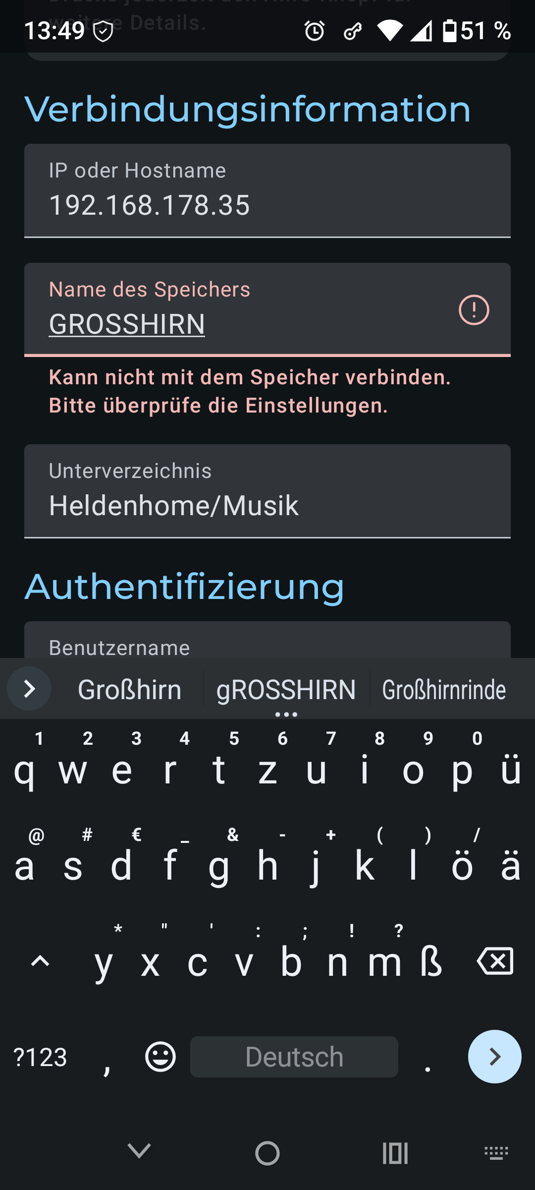

fill out the login data fields. after press add, there is an error.

first field is IP. but I have to enter the form http://192.168.178.35 and not pure IP, if described. otherwise it is rejected.
second field is name GROSSHIRN
third field is a bit tricky. the real path is Heldenhome/Musik. but you don’t describe if you support multiple directories and if a leading slash is needed.

Provide logs when entering just the IP and screenshot of exactly what you enter.
this is the screenshot. in this situation there is no button to activate or send log.
And the message says that the share name does not seem to exist on the server are you sure it’s the actual name of the sahre ?
