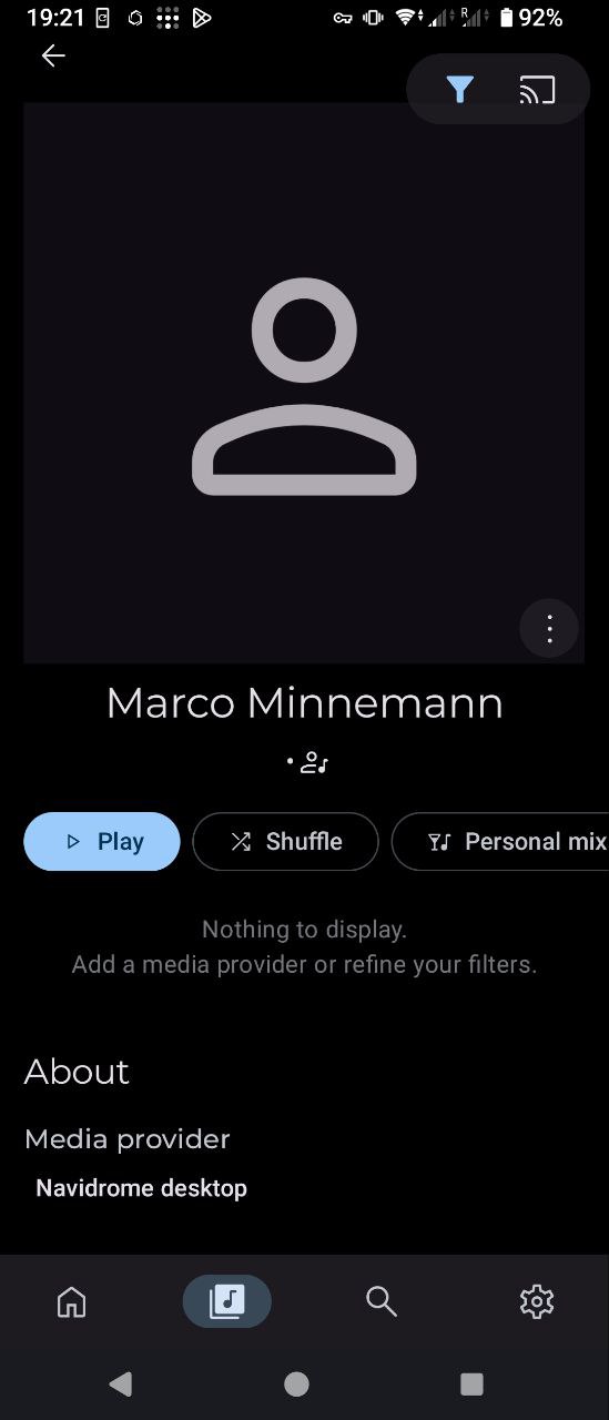

The issue is all these artists are “empty”, no albums or songs are listed when I tap one.
For example, I have an album where artist “Marco Minnemann” is listed as “composer” and “lyricist” on some songs. This artist appears in the “All artists” list, but there is nothing listed on the artist page, and “play” button gives message “No playable media.”

Ok so yes this is normal, Symfonium handle the roles differently.
You can press the artist icon near the . under the name to pass in Composer mode and see where the artist is a composer. You can also browse them from the Composer node and filter them out from the global artist list via the filter.
With that said Navidrome now support also more roles that I do not support yet, I’ll filter them from the sync.
