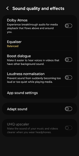

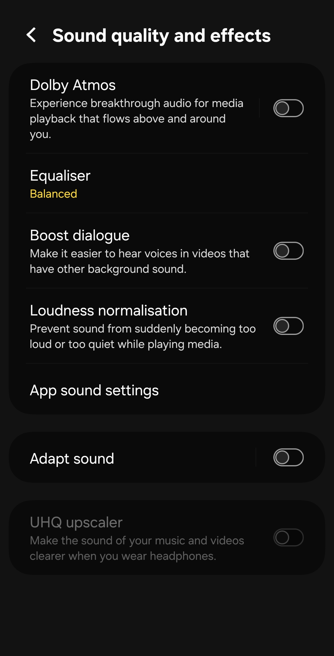

And try to disable all the Samsung dolby stuff.

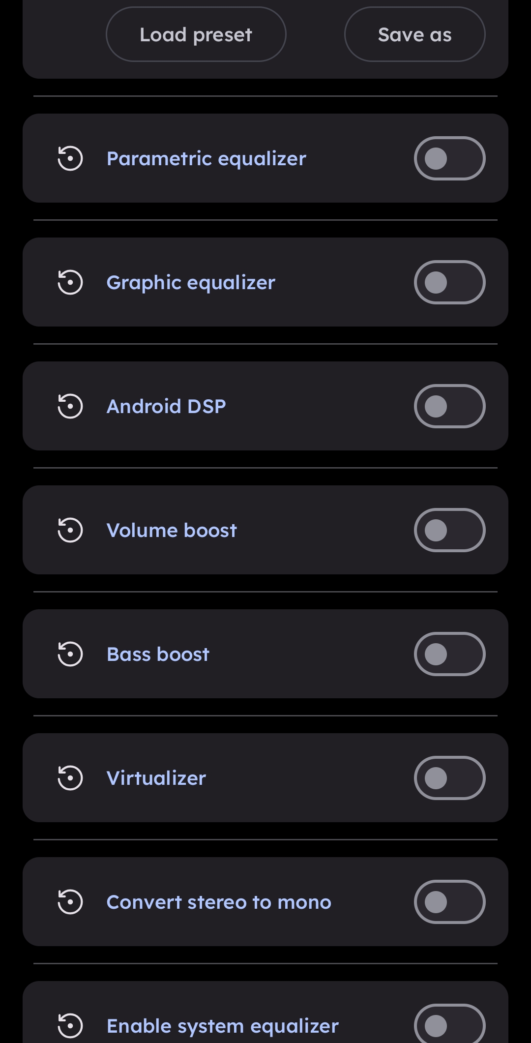

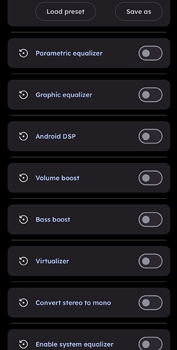

Confirmed using phone speakers. I have disabled EQ and Samsung Dolby Atmos etc. screen shot attached.
