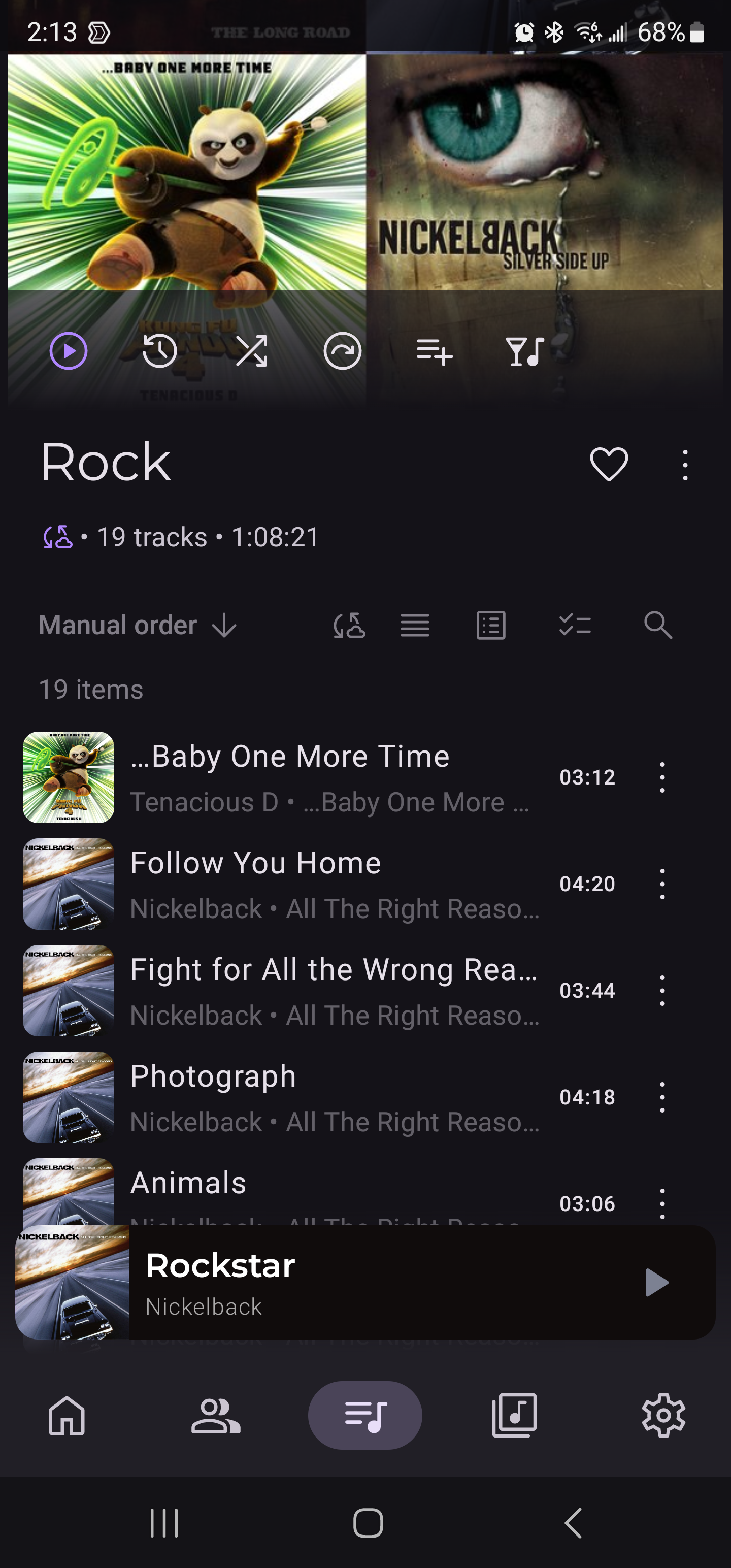

Then your playlists are not online firsts :slight_smile:
Check the icons before the track count.
Is this not an online first playlist?
No it’s not. Import again and be sure to select online first.
Ah okay, understood. I thought when I re-imported them as online-first it would overwrite the old offline-first playlists, so I thought these were online-first.
They are syncing properly now. Thank you.
