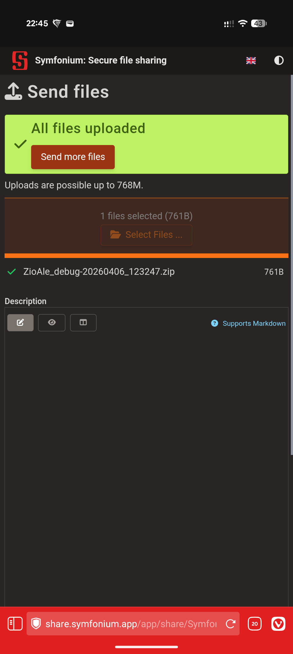

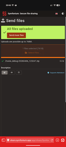

That’s odd. I attempted a new upload just now. See screenshot.
Let me know if it worked this time.
You do not put a description as required and the log is empty and does not reproduce the issue …
I tried to upload again directly from the app, now. It’s a 1.7 MB file (uncompressed). I added as a comment “ZioAle OneDrive streaming issues”.
I also checked the contents and they should be correct.

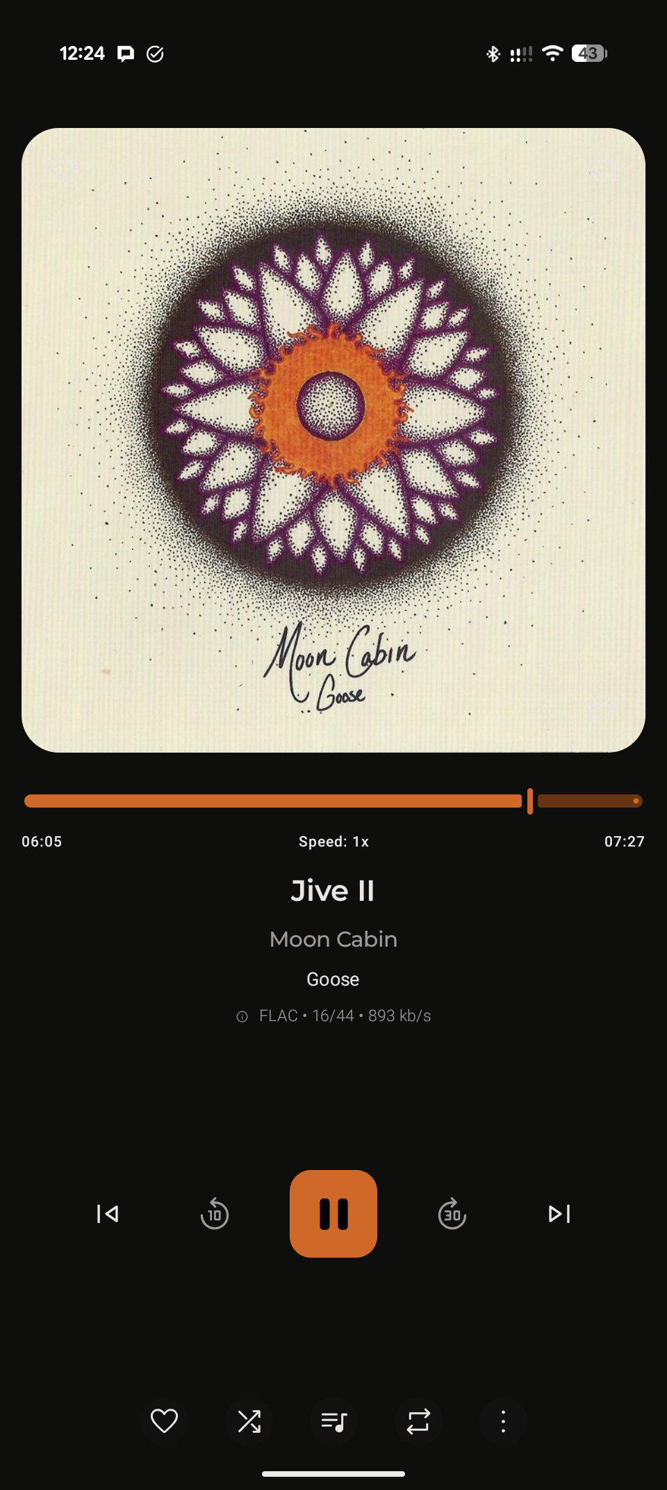

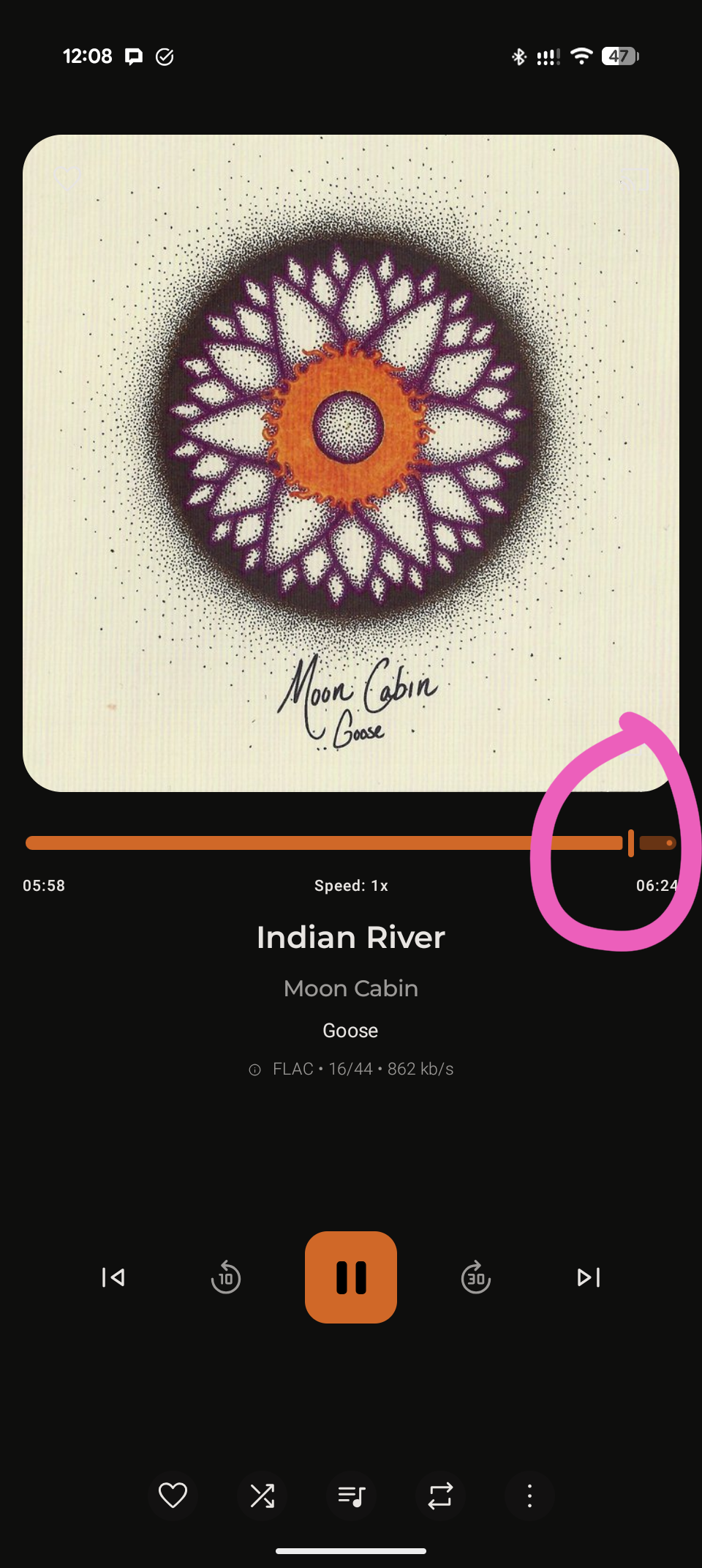

I have been having a similar issue when streaming from OneDrive. The App used to work fine when I initially purchased it, but started freezing playback before the end of songs across my library some months ago. Has this issue made any progress in being solved? Thanks.
I also have this problem - see my issue posted just before this.
As I said in there, if I drag the playback bar back a few minutes, then it plays correctly.
