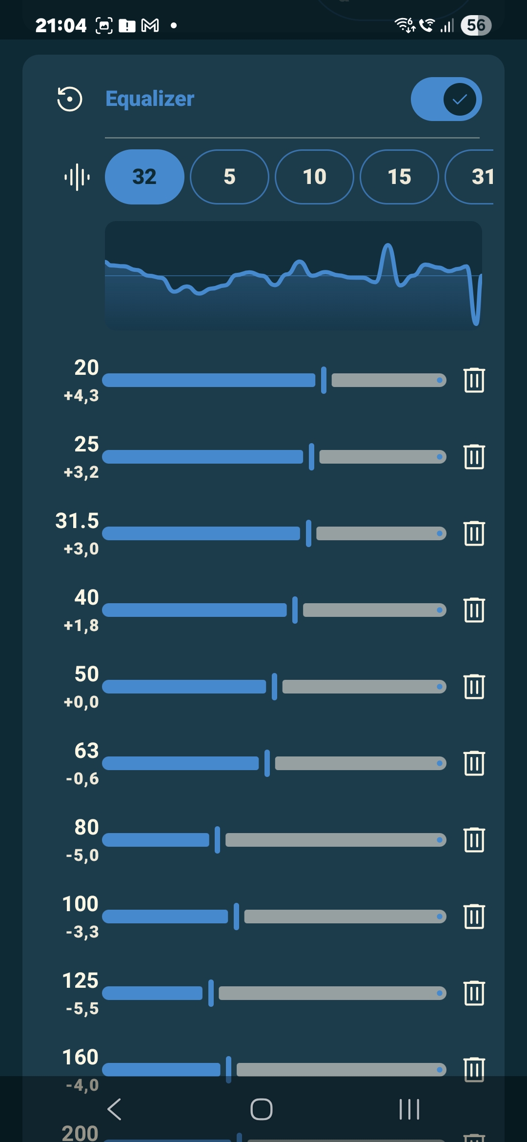

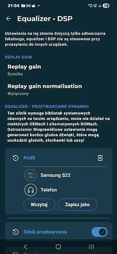

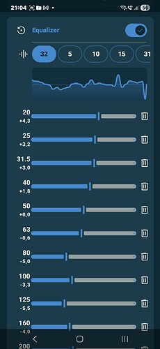

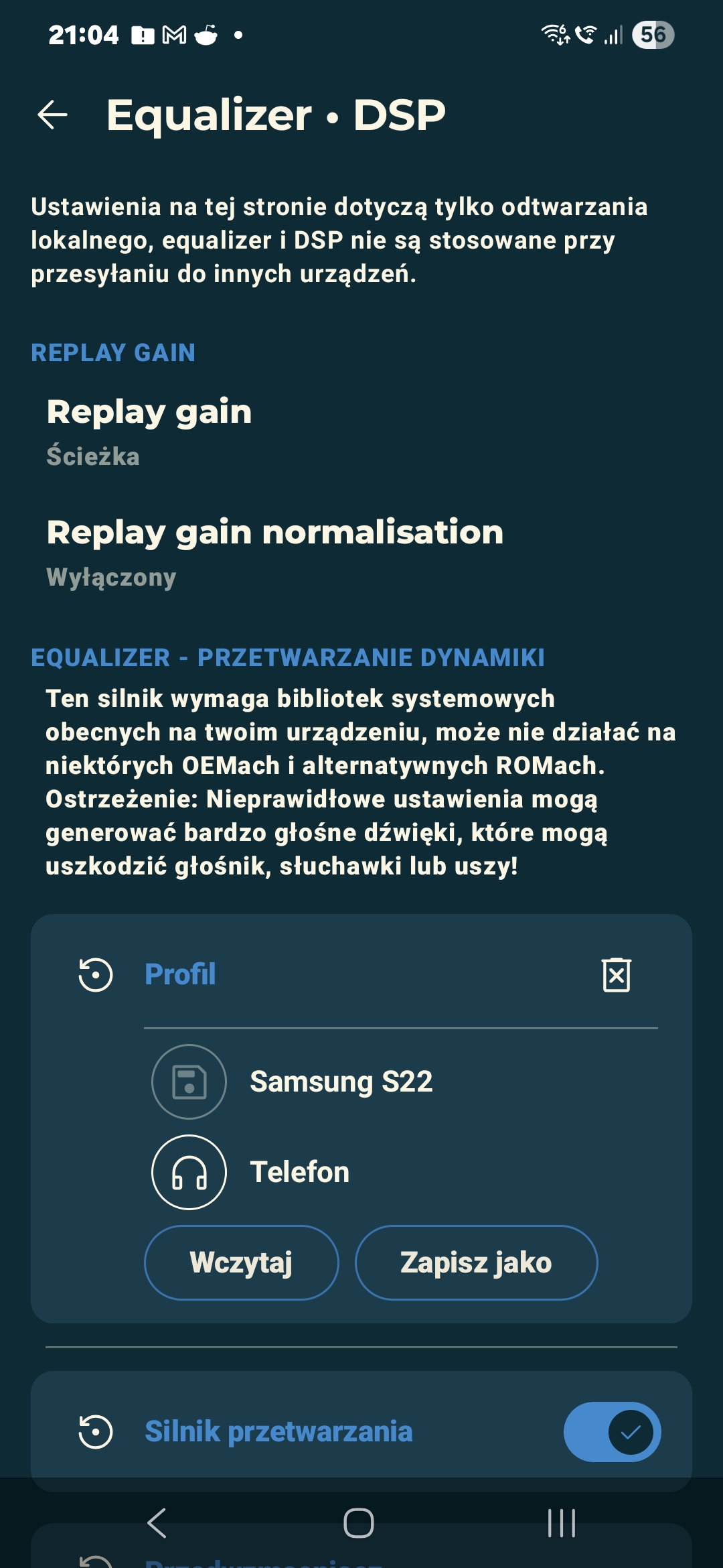

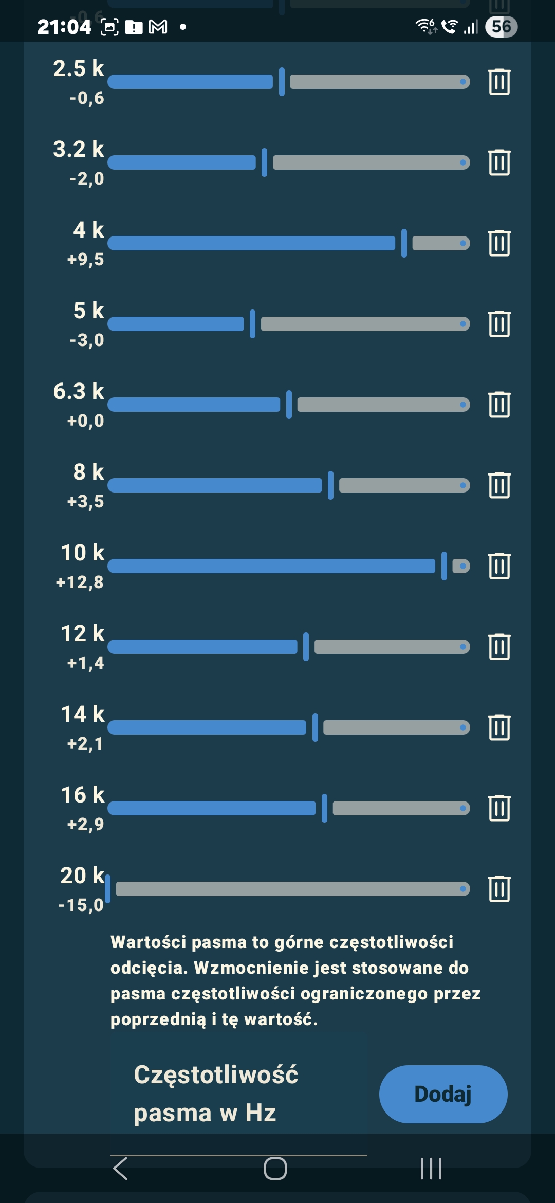

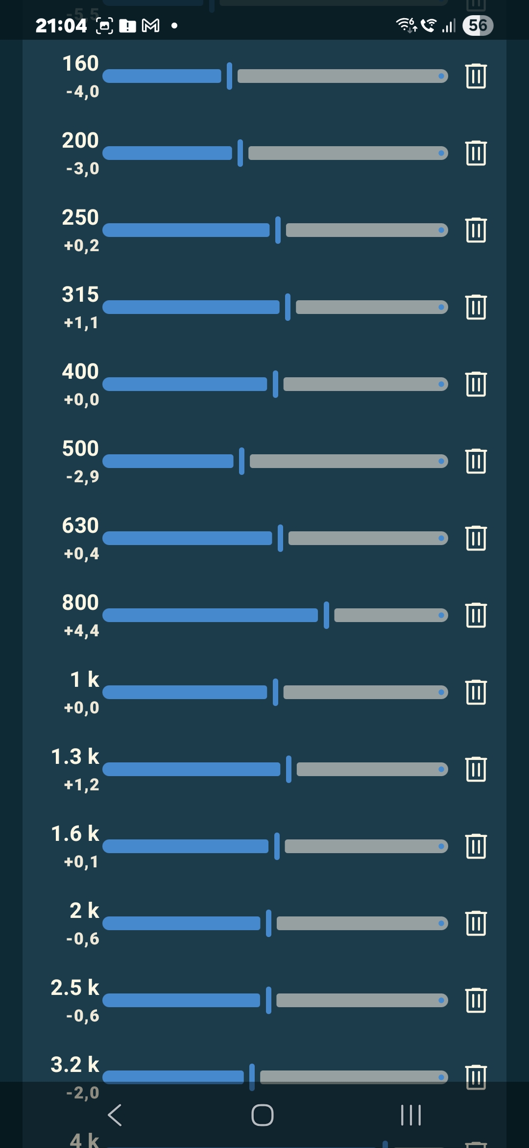

Please show your full equalizer configuration.
Well with such strange values it probably won’t sound correct yes …
Why 32 bands ? Why 0 on 20k why so much on 10k ?

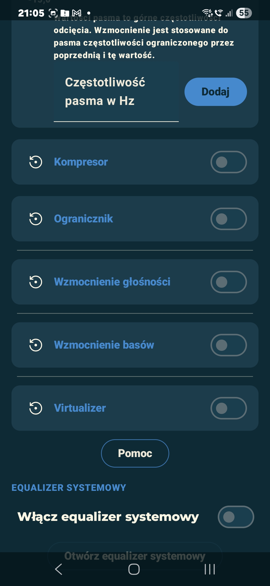

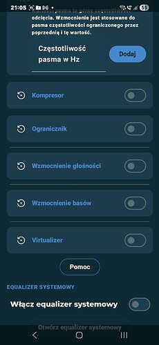

Pre amp + high values and no limiter or compressor also can’t work usually.
32 bands for more precise EQ adjustment,
0 to 20k – I set it like this only temporarily.
The high value at 10k was set accidentally.
But I don’t think the equalizer is the cause of that slightly audible metallic-sounding tone.

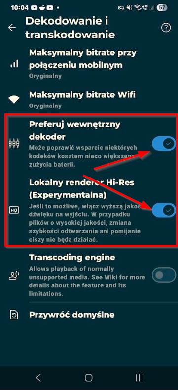

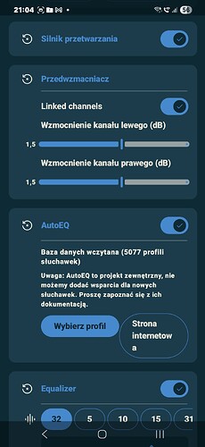

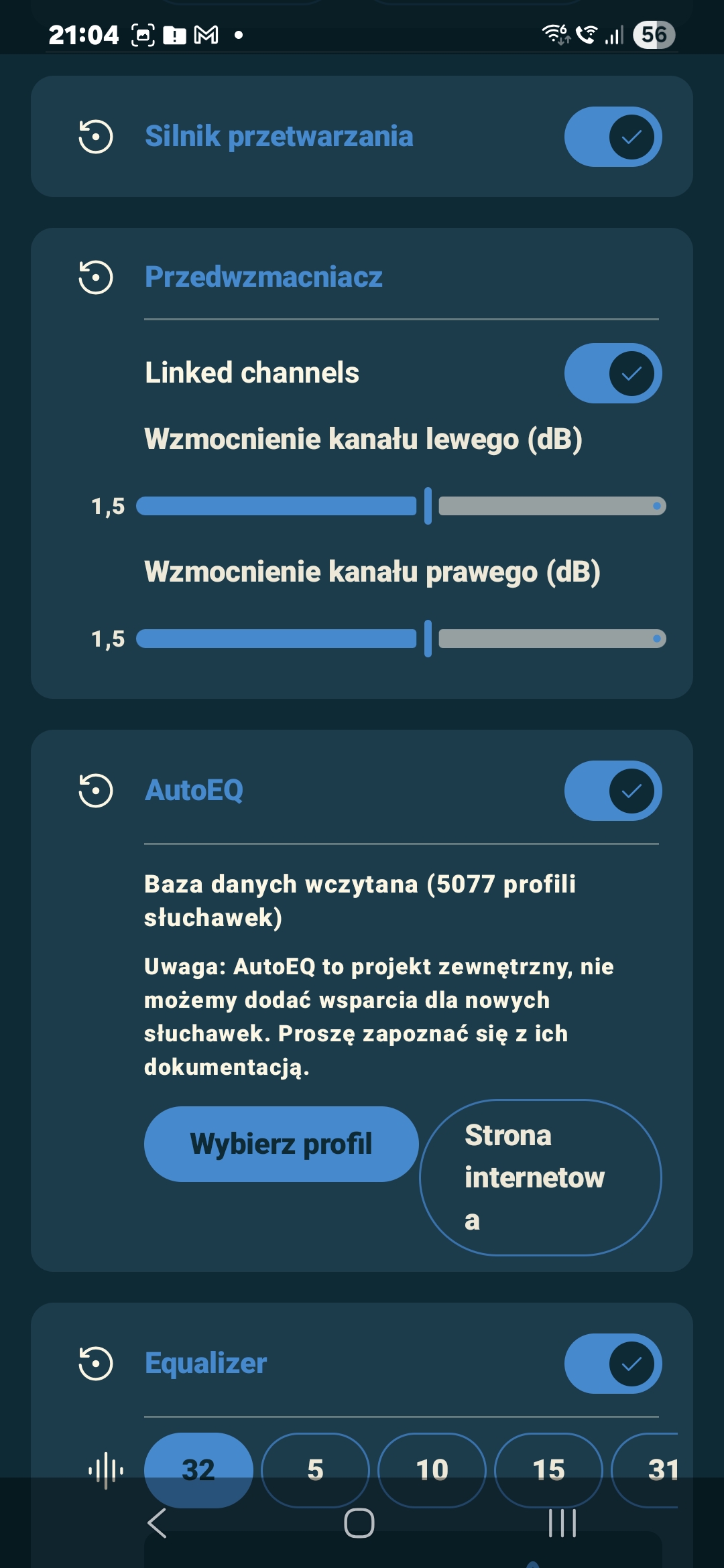

It was enough to just turn off and on the option shown in the screenshot.
