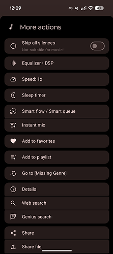

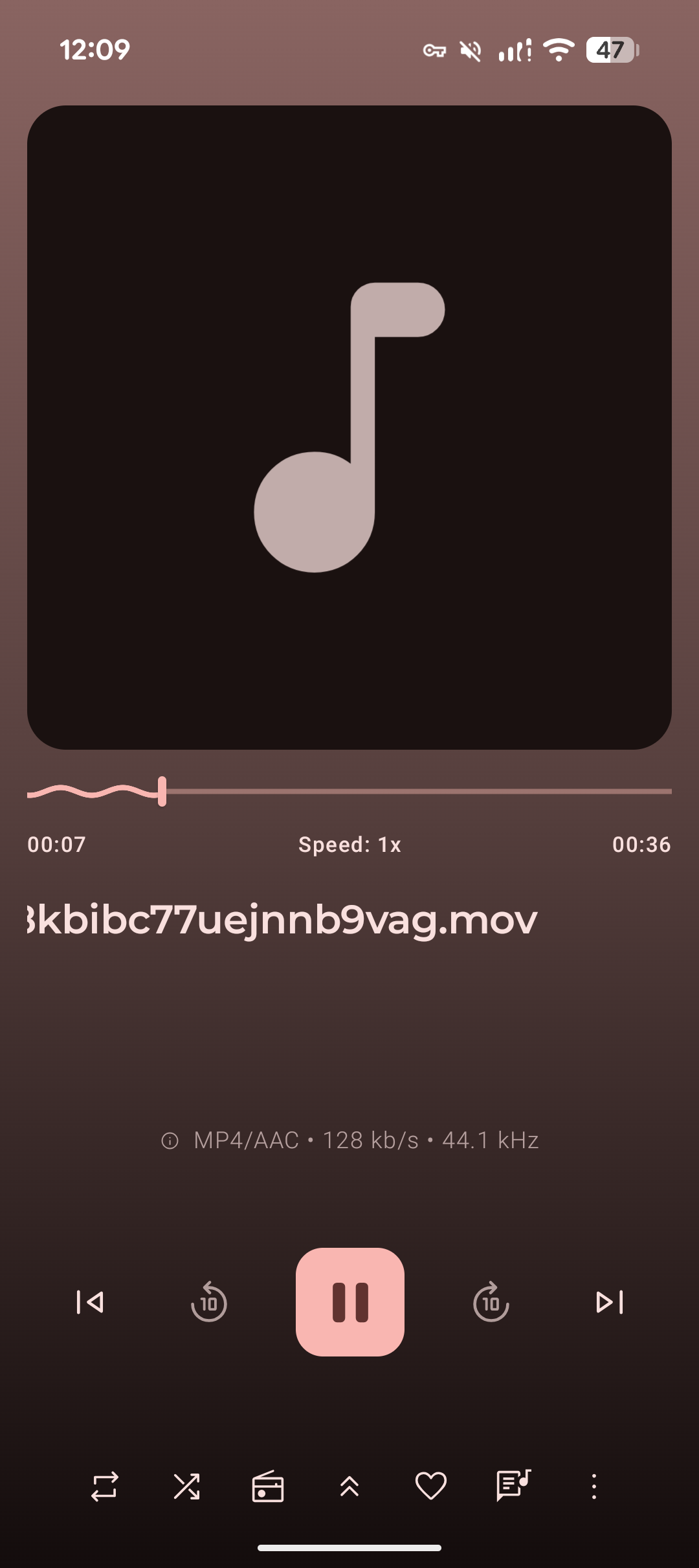

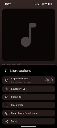

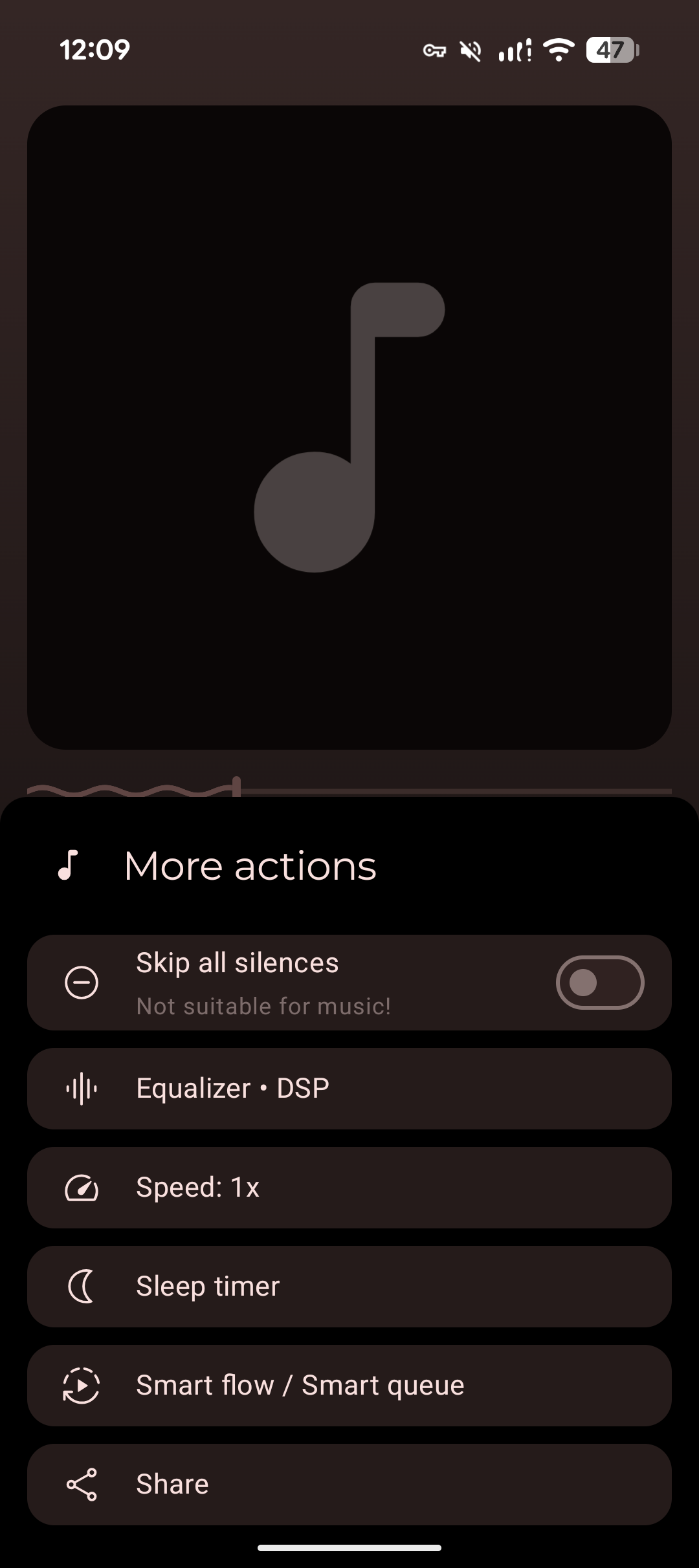

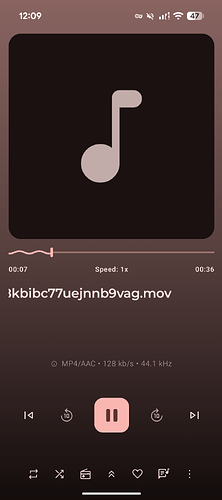

In these attachments you can see, when you tap the “3 dot” icon upon a playing .mp4 video file, it will open up a very detailed “More Actions” page shows everything incl. “Add to a Playlist”, this is correct. But when you tap the “3 dot” icon upon a playing .mov file, only a much fewer info “More Actions” page will show up, no “Add Playlist” option shows.
