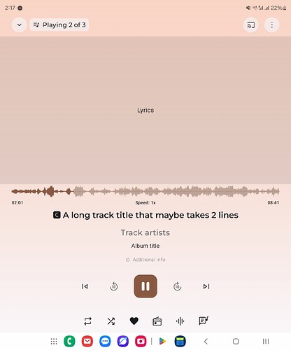

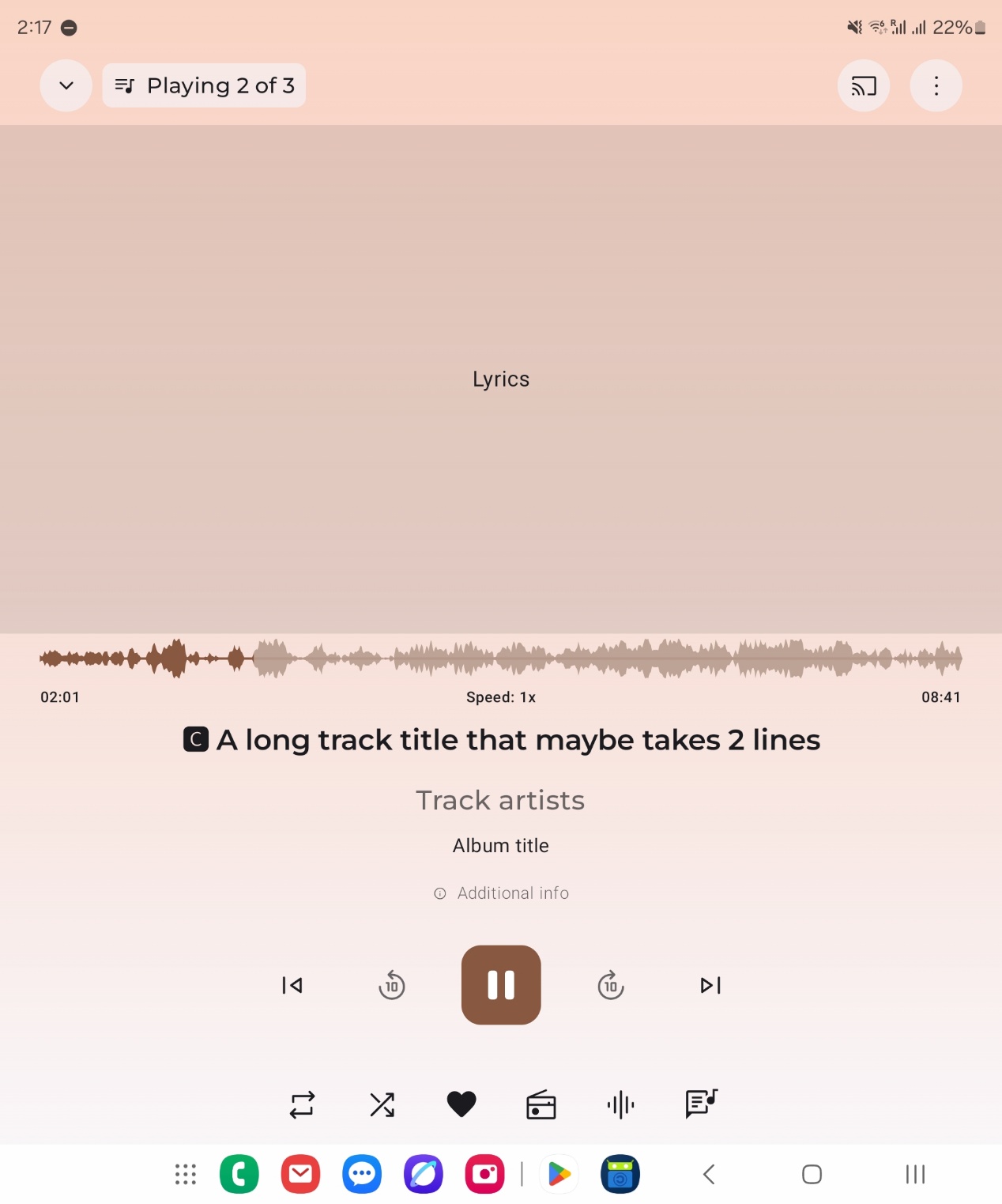

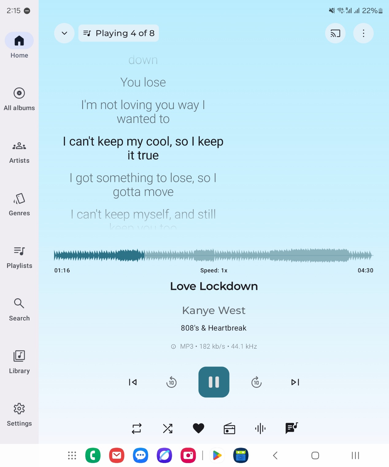

It’s my first time installing Symfonium on a Galaxy Fold 4, and when unfolded the position of the lyrics in the player is offset to the left. I believe it is supposed to use the entire horizontal space..? I haven’t touched any settings other than choosing from one of the default layouts and setting up a server.
Upload description: manatails
On the layout customization preview page the field looks okay, it is offset to the left only in the actual player.
This happens on default install on Galaxy Fold 4

Cam you show how it looks without lyrics and the cover ?
I am using ‘Large Tablet’ right now but the left offset is the same on other layouts as well.

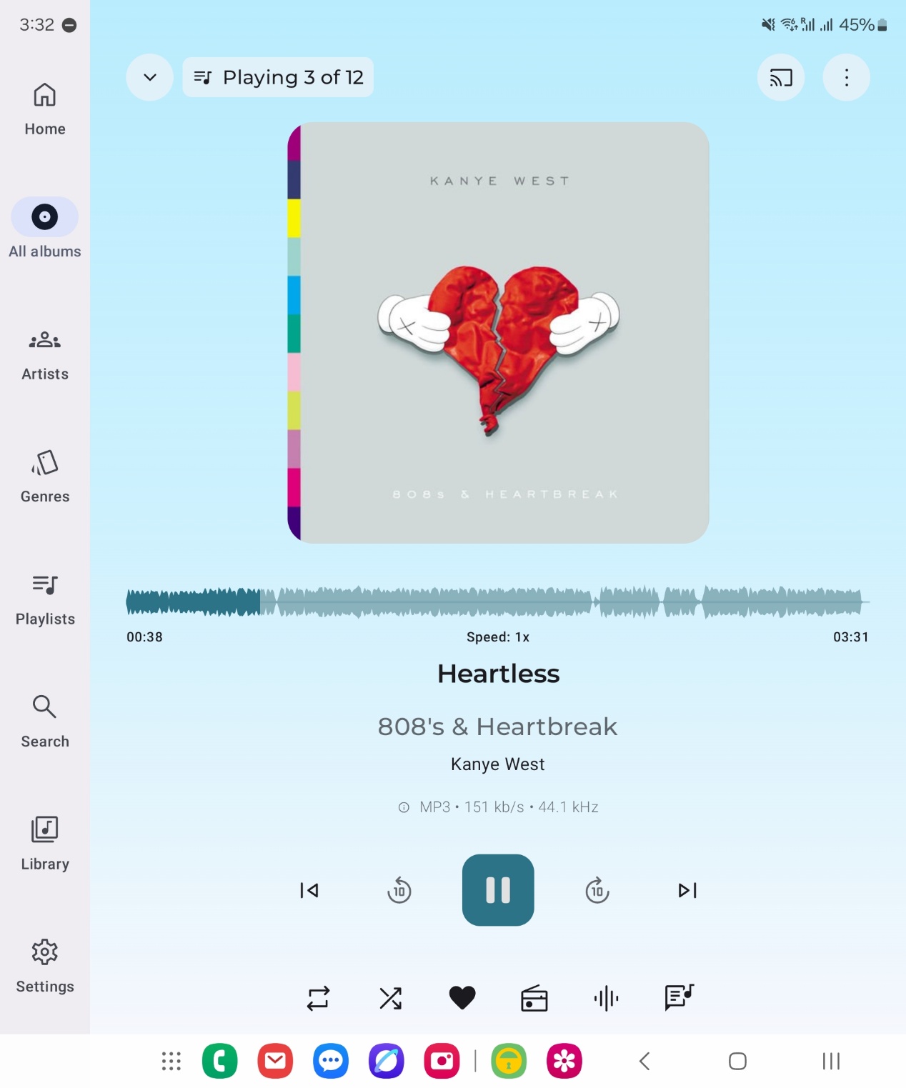

without the lyrics the album cover is positioned correctly.
I can’t reproduce.
Do you first open the lyrics when closed then open? Or do something special to trigger that state?
Does it recover after a toggle of the lyrics or a rotation of the phone ?
I just uninstalled and reinstalled the app and can confirm that it happens without doing anything special and I kept my screen unfolded at all times.
folding and unfolding does not fix it and the folded layout looks just fine.
Ok was able to reproduce via Samsung lab :frowning:
Will investigate. No idea why the previews shows the correct result.
