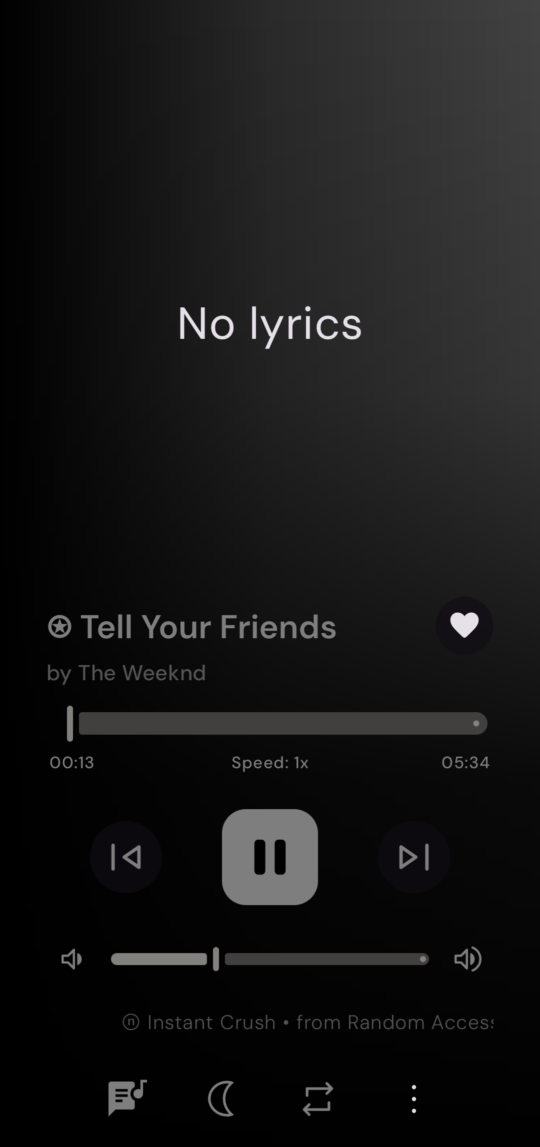

Lyrics don't load when the next song in queue autoplays
When I’m playing songs in a queue, most lyrics load as normal for the first song being played, and any other song I play if I press Next to play it, or select it in the queue. However, if I reach the end of a track and the next one starts playing, ‘No lyrics’ appears. This can’t be rectified unless I skip to another song, then skip back to the old one.

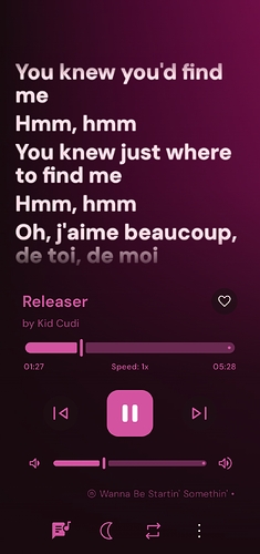

Another related issue: synced lyrics often appear as unsynched blocks of text. This can happen randomly, but it is most likely to occur after the ‘fix’ I mentioned earlier.

This appears to happen more with regular LRC files, rather than ELRC.

Please make a video of exactly what you do and provide some of those files to see the lyrics tags and external files if present.
Screen_Recording_20260109_184150(1)
This video shows correct playback, with a notable lack of Smart Fades (it’s an album being played)
Screen_Recording_20260109_184320(1)
The video displays correct playback of the first track, but when the next track plays, lyrics do not appear, even though they are available.
Screen_Recording_20260109_184320(2)
A continuation of the second video. Correct playback is achieved by pressing Previous, then Next, finally displaying lyrics.
