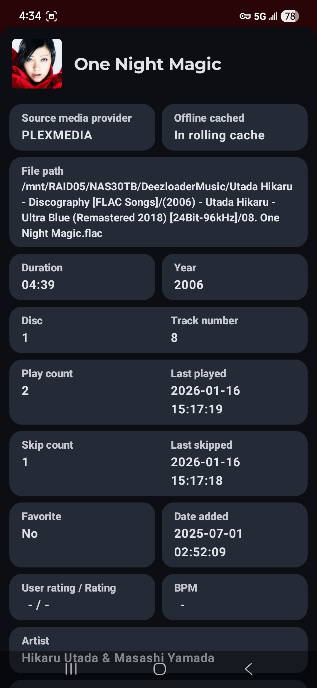

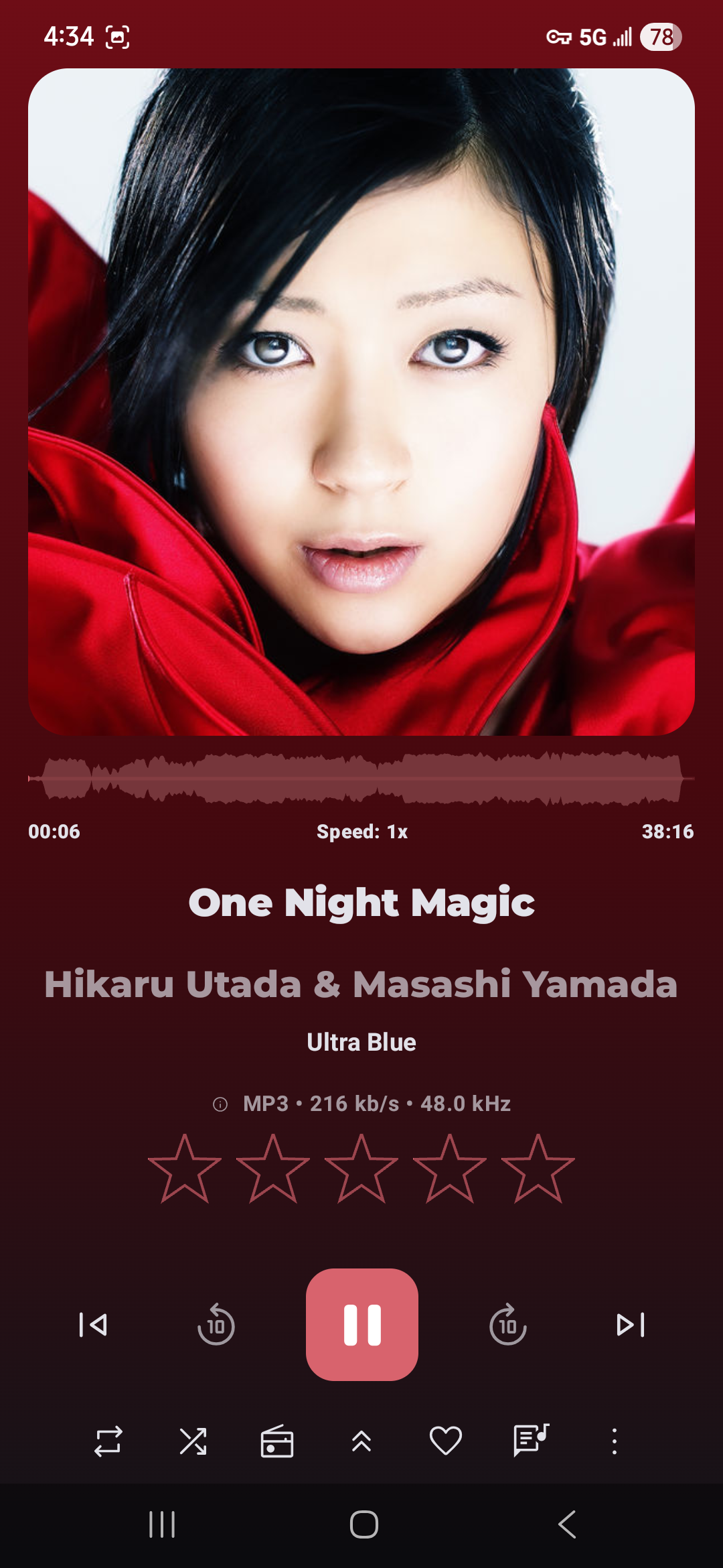

Long playback song times

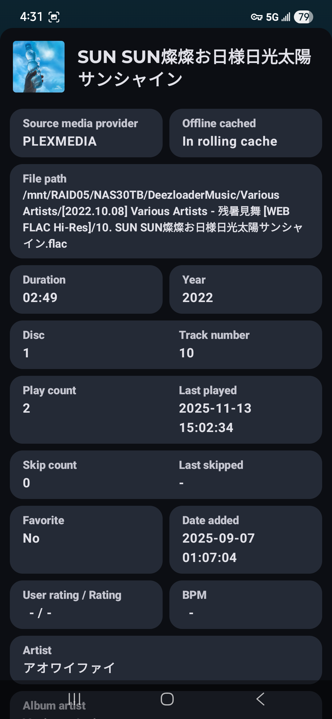

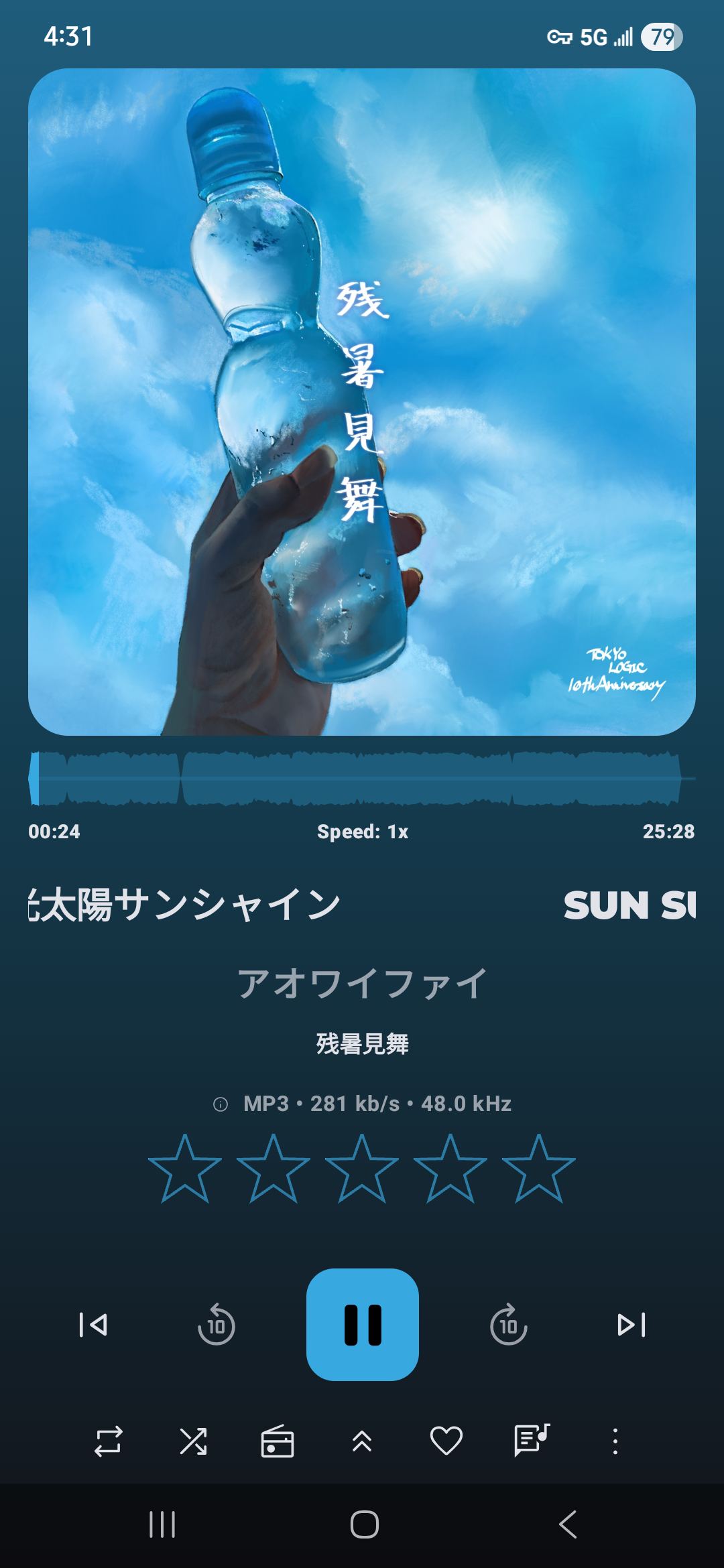

Song playback is longer than actual song length. File type appears as mp3 instead of flac type.
Upload description: littleli
Same as other users post on the subreddit.

I’d check if transcoding is enabled. Welcome to the forum!

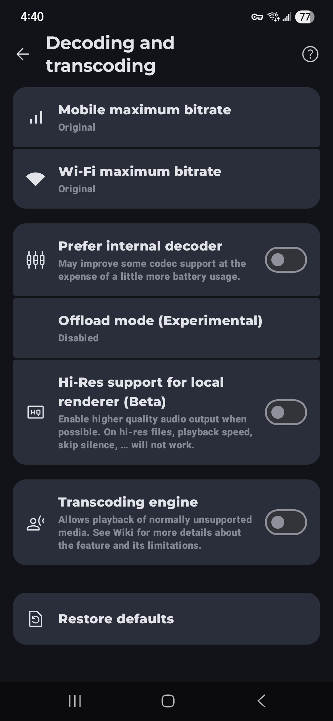

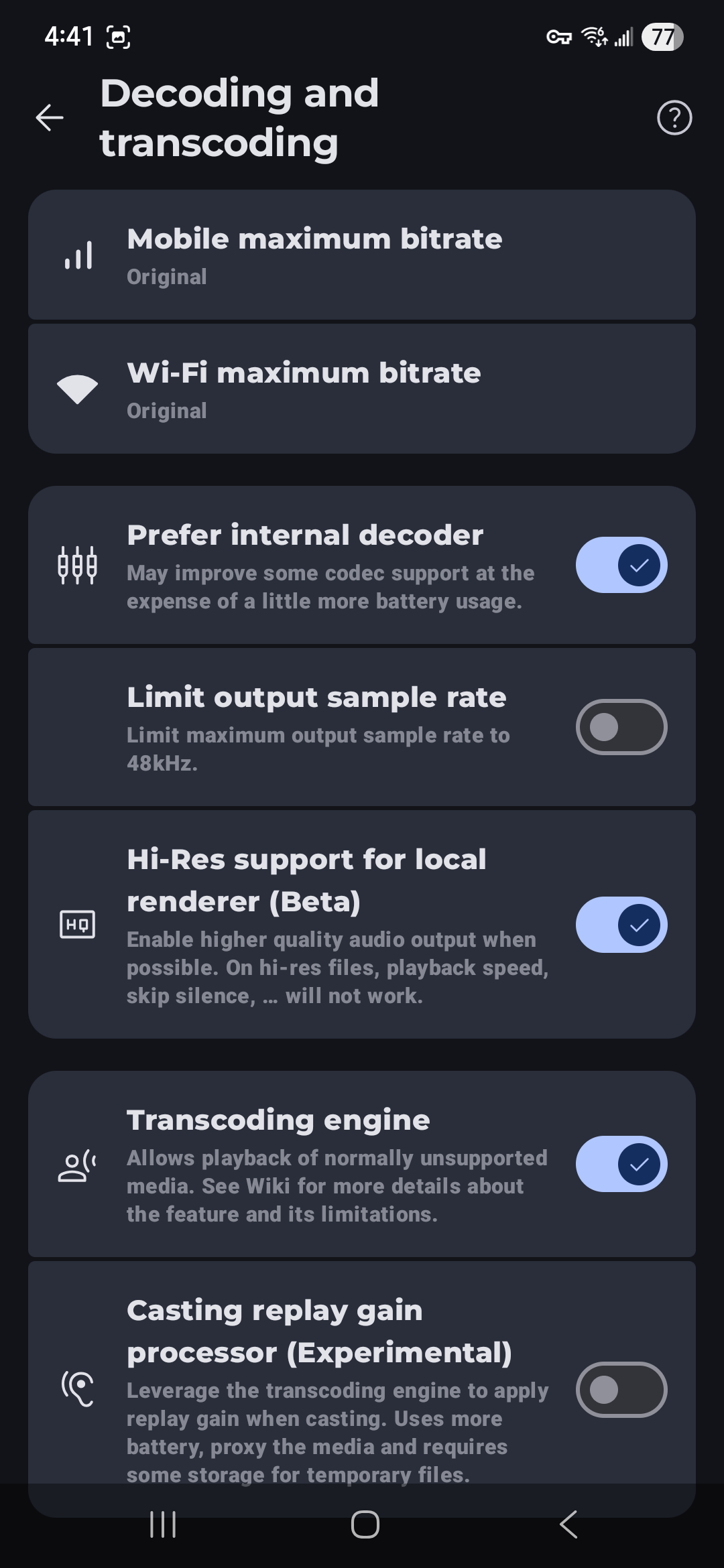

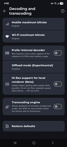

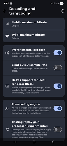

Tried toggling everything on and everything off. Playback issue still remains.
Well, check if Plex forces transcoding on the server side. if that doesn’t seem like the case, just wait for Tolriq.
You are playing files that where offline cached while connected to plex relays.
Plex currently have a bug that will generate invalid mp3s in that case. Remove the file from the cache and cache it again.
Cleared cache. Re added songs to permanent cache while at home. Issue continues.
