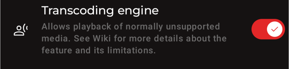

Ok can you try to disable the transcoding engine in settings to confirm this fix this ?

Talking about
Please provide logs with that off and app restarted.

Anyway seems that option is actually also ignored in current release. That would explain the other issue and the delay.
Should be fixed in next release then.
