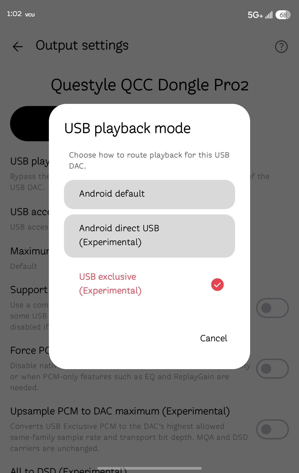

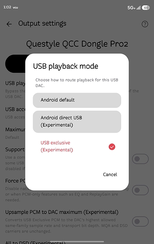

Using a fold 8 by Samsung. Qcc pro 2 usb c dongle with aptx compatible earbuds. Bowers and Wilkine pi8. Selecting USB exclusive playback and using local playback flac files gives me issues. Audio plays either for a second or 2, cuts out, or stops and doesn’t play. Have tried switching absolute volume off and on. Selecting android bit perfect mode fixed the audio problems but I want USB exclusive mode to work. Latest app installed.
I have tried switching to androids bit perfect mode and that works but I want USB exclusive to work. Tried giving popup access and still issues remain.

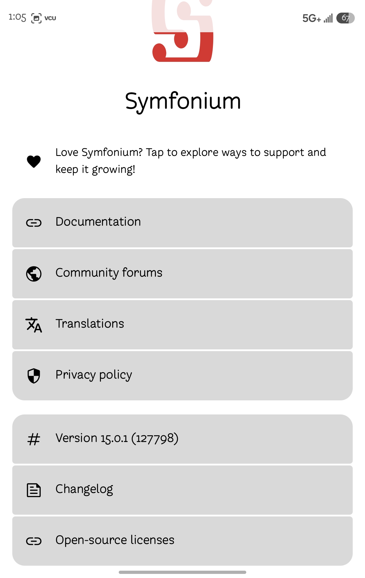

Using the last version of the app 15.0.1. Same issue here with a samsung S23 / dongle Qcc pro (version 1, not 2).

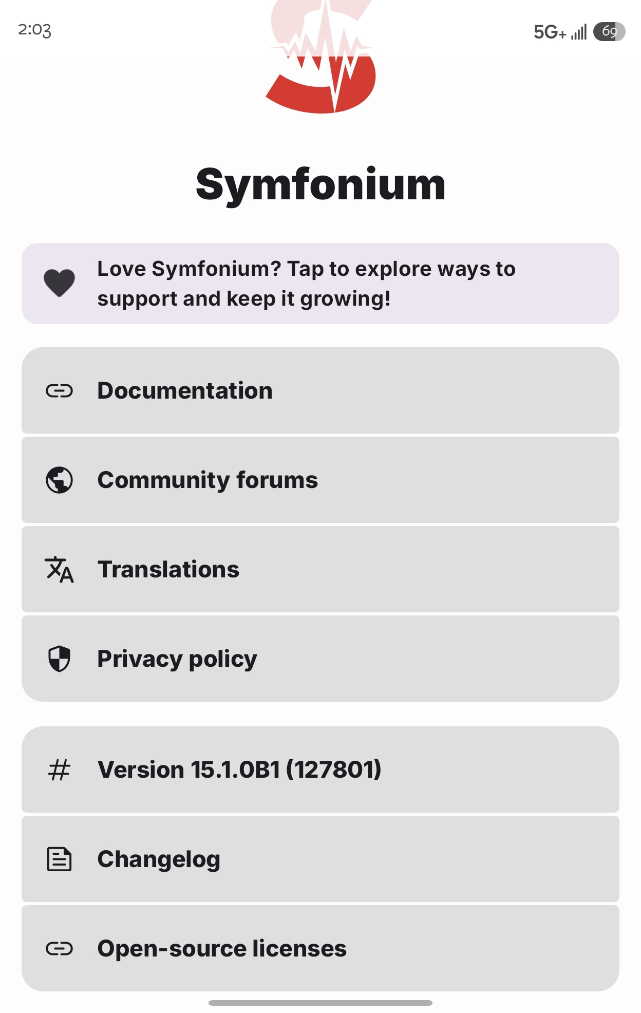

Test with version 15.1.0 beta 1. See changelog for download links.

As written you need to test with version 15.1 … Version 15.1.0 Beta 1

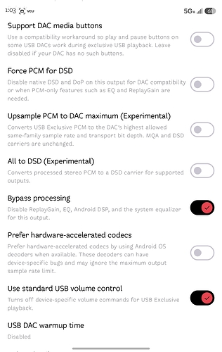

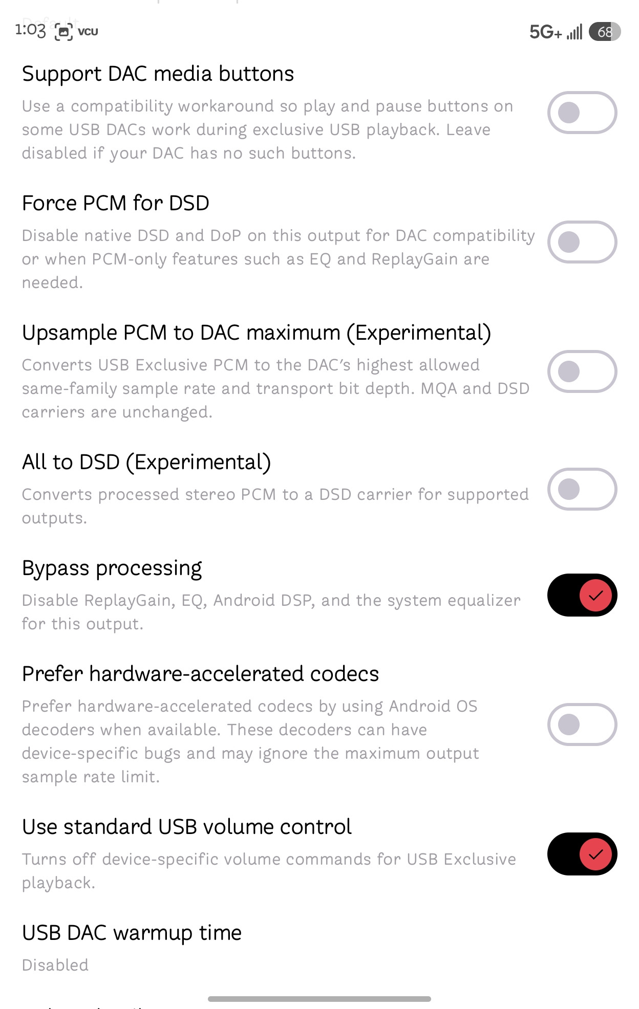

Okay that seemed to fix but I cannot control volume at all. It’s extremely loud by default.
… Provide logs ??? And be sure to not enable the option Use standard USB volume as in your first post ?

No I don’t as the docs explains you need to tell me when you upload and the description.

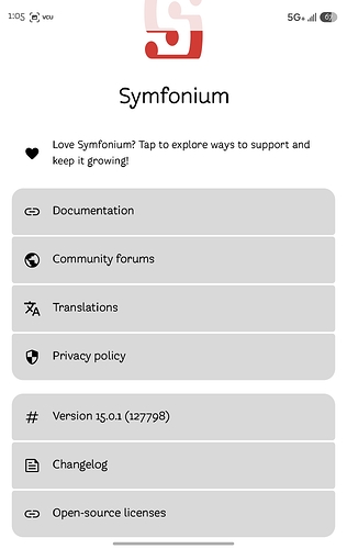

And you are still using version 15.0.1 not 15.1.0 …
Yes I have the latest build. Can you just tell me the volume issue ? Also this app somehow keeps freezing my phone. Causing a restart. I read it’s conflicting with the kernal. Anyways the issue is the volume not working. What’s the problem?
