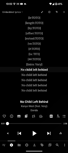

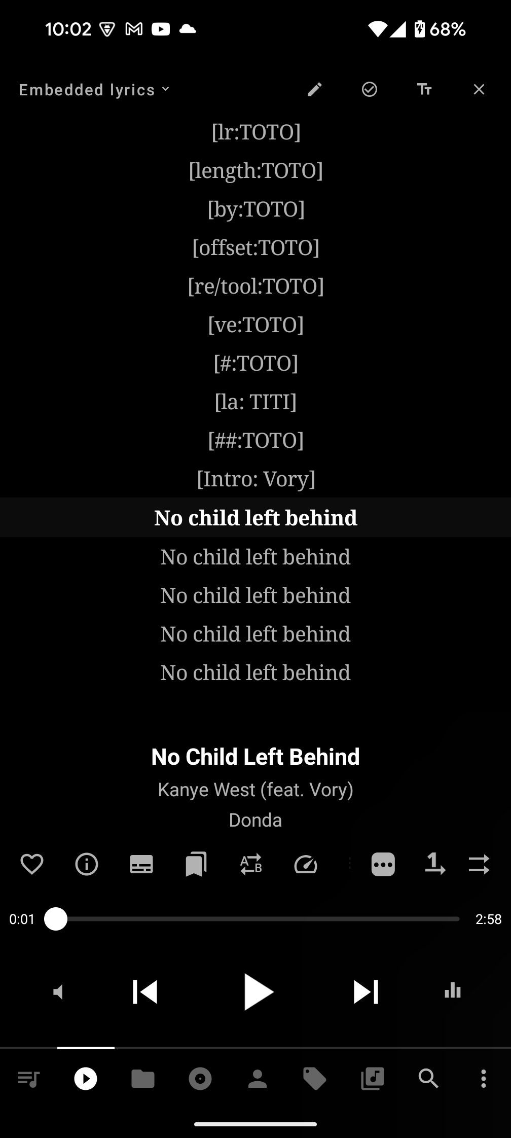

If you take a look at the wikipedia page for the .lrc file format, you’ll find:
ID tags may optionally appear before the lyrics,[3] although some players may not recognize or simply ignore this[citation needed]. The format of an ID tag is [type:value], where type is the tag type and value its value (most often some text).
In my script lyrict for example, the tag_external mode allows adding such tags to external lyrics files. Example result:
[ar:Suzanne Vega]
[al:Beauty & Crime]
[ti:Pornographer's Dream]
[au:Suzanne Vega]
[length:03:24]
[00:16.133]She's a pornographer's dream, he said
[00:20.992]I knew what he meant
The reason why most players I know strip any lines that are enclosed in square brackets is to avoid displaying such tags which is usually unwanted.
The regex to filter could probably be adjusted to something like ^\[.*:.*\]$ (I don’t know the regex that’s used) to only strip text in square brackets that follows the general tag formatting but even then there’d be false positives if the genius information also contains a :. Or a highly specific regex that only matches each of the known/used tags could be thought up but it’s up to Tolriq if he’s willing to go to such lengths.
I remove the genius content in square brackets while syncing lyrics and only leave it in unsynced lyrics if I deem the information useful. But that’s a matter of personal preference.
Even if such text was not filtered, for synced lyrics the highlighting would probably be weird. When should these lines be highlighted? At the time of the next line with a timestamp? Or at the same time as the line that preceded them? I can’t think of either being visually pleasing.

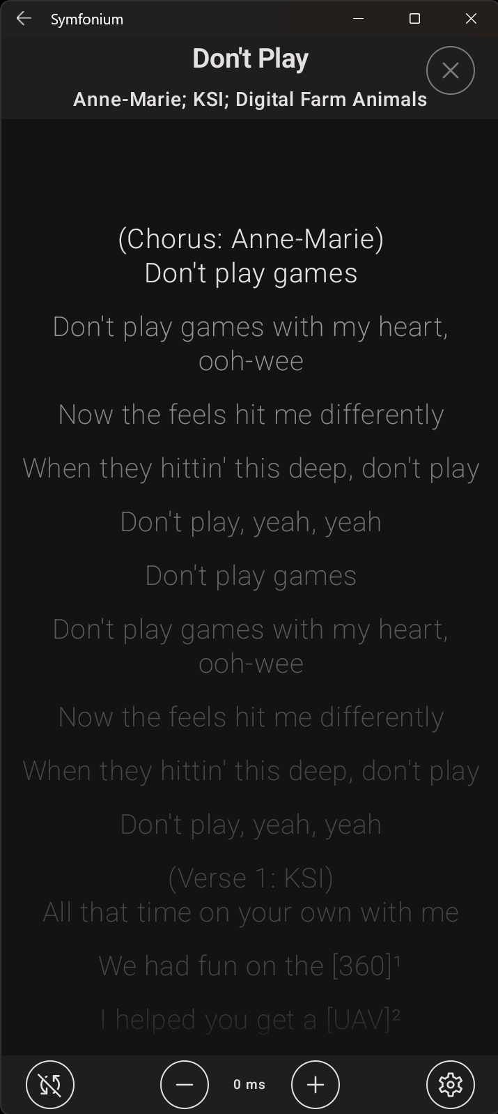

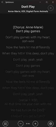

Currently the only workarounds I had were:
  1. Headers immediately follow a timestamped lyric (brackets replaced with parentheses)
[00:03.05] We Lift our Hands
(Verse 1: James Carr)
Here the header is appearing after the lyrics are spoken which is a bit less than ideal.
  1. Hot swapping the timestamped lyric & header (brackets replaced with parentheses)
[00:03.05] (Verse 1: James Car)
We Lift our Hands

That one seems like the most promising workaround to me. Although two limitations come to mind. The first being that the header is highlighted at the same time as the line and the second being that other programs that do not support multi-lines in lyrics might strip everything after the linebreak and only display the header.
With a well built regex this transformation of the genius headers could probably be done automatically for all instances in a file.
If you give me a few examples I can see if I can come up with one (I like regex). Assuming you don’t already have one.
I’d be interested to know if Musicolet hides the tags at the beginning of the file or if it also displays these.
Edit: After thinking about it a bit more, I think it would be better to simply duplicate the timestamp of the following line and prepend it to the genius header like this:
[00:03.05] [Verse 1: James Car]
If I recall it correctly, when 2 lines share the same timestamp, Symfonium directly skips to the 2nd line and only highlights that. Could you try that and see if I’m correct?
With two lines sharing the same timestamp both are highlighted at the same time. When you toggle the setting to show the timestamps there is just one timestamp for the two lines.
If you use the brackets in the header as you have them here
That line gets erased from view

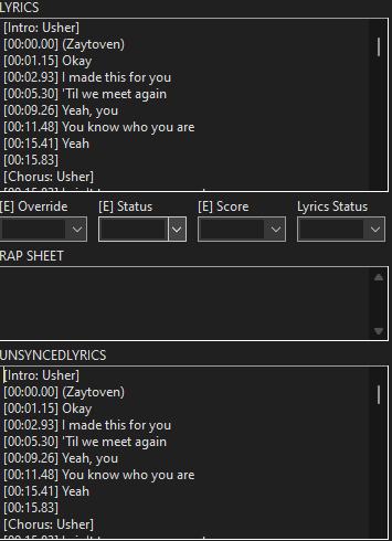

Unfortunately I don’t have a bunch of files for you to test with these are just some of the workarounds I had tried in my library when I was thinking about sort of merging my Synced & unsynced lyrics. I also tried adding a timestamp to those headers manually but that took more time & sometimes there isn’t even enough gap between lyrics to place them so it kind of kills the synced experience TBH
@HaxCalibour may have a number of files in this format:
[Chorus: James Carr]
[00:03.05] We Lift Our Hands
If they are able to provide those maybe you can work some regex magic to mass convert that to
[00:03.05] (Chorus: James Carr)
We Lift Our Hands
OR
or some other format where the header & lyric don’t both highlight

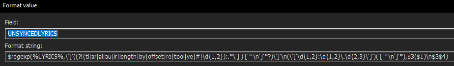

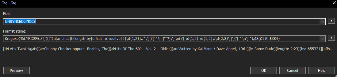

I’ve been playing with it for a bit. One thing that’s lost (unless I make the regex even more complicated) are instrumental passages followed by a header. Example:
[Guitar Solo]
[Bridge: Roger Waters]
[2:57.621]But it was only a fantasy
This would be turned into:
[Guitar Solo]
[2:57.621](Bridge: Roger Waters)
But then again, you should just create a timestamp for such instrumental passages anyhow.
However the lines with a header followed by a line with a timestamp are covered in this regex I’ve been playing around with:
^\[((?!(ti|ar|al|au|lr|length|by|offset|re|tool|ve|#|\d{1,2}):.*\]).*)\]\n(\[\d{1,2}:\d{1,2}\.\d{2,3}\])(.*)$
replace with
$3($1)\n$4
You could probably turn that into an Mp3tag action (if Mp3tag supports negative lookahead in it’s regex implementation) to mass edit embedded lyrics or turn it into a little script/batch file to mass edit external lyrics.
Here is my full example with all lrc tags (taken from wikipedia) which are ignored.
Let me know if you have ideas on how to improve it.
Ok, so I tried to plop this into mp3tag & it did nothing, so I’ve probably done something wrong as I have almost no understanding of regex
As per the MP3TAG documentation:
$regexp(x,e,r,c)
replaces the pattern specified by the regular expression e in the string x by r. The optional fourth parameter c enables ignore case (1) or disables the ignore case setting (0). Please note that you have to escape comma and other special characters in e.
In this case
x = %LYRICS%
e = The Regular Expression
r = The substitution? “$3($1)\n$4”
c = 1 or 0
I’m at a loss here lol instead of learning regex I opted to create massively convoluted simple scripting in MP3TAG to accomplish most of my actions.

For Mp3tag you have to do some extra escaping when you use regular expressions in actions/scripting. Since Mp3tag regex doesn’t seem to support multi-line flags, I had to adjust the regex quite a bit by making some things non-greedy etc. but this works for my example:
$regexp(%LYRICS%,\'['((?!(ti|ar|al|au|lr|length|by|offset|re|tool|ve|#|\d{1,2}):.*\']')'['^\n']'*?)\']'\n(\'['\d{1,2}:\d{1,2}\.\d{2,3}\']')('['^\n']'*),$3($1)\n$4)
The only thing that’s ignored are the specific lrc tags I’ve taken from the wikipedia page. What’s in the genius headers should not matter unless it happens to match one of the tags or the syntax of the start of a timestamp line exactly. That ought to be relatively unlikely tho.
You might want to change the square brackets to round ones as well to avoid that, yes.

This means that:
and
We Lift our Hands
would be displayed identically in Symfonium. In this case I think this action would be better as it retains the timestamp in front of the line it belongs to and only prepends the same timestamp to the header while exchanging the square brackets with round ones.

For me this is producing a carbon copy in MP3TAG
LYRICS at the top is what I started with & when using your regex to format the value of UNSYNCEDLYRICS at the bottom it’s the same.
EDIT:
The above regex from @655321 does work for standard synced lyrics with these “headers”. My lyrics just have extra line breaks in them.
Did you use it in an action or in a converter? ̶I̶ ̶t̶h̶i̶n̶k̶ ̶t̶h̶e̶r̶e̶ ̶m̶i̶g̶h̶t̶ ̶b̶e̶ ̶d̶i̶f̶f̶e̶r̶e̶n̶t̶ ̶e̶s̶c̶a̶p̶i̶n̶g̶ ̶n̶e̶e̶d̶s̶ ̶d̶e̶p̶e̶n̶d̶i̶n̶g̶ ̶o̶n̶ ̶t̶h̶a̶t̶.̶
I’ve tested the regex in a Tag → Tag converter where it works. A carbon copy means that no match was found.
The Preview is especially useful to test regexes before applying them.
Anyhow as this is not the Mp3tag forum, I think we should take this to DMs if you have further questions.
Edit:
It also works for me as a Format Value action:

Adding a couple of kown tags in those lyrics will make Musicolet show everything after the first one it does not recognize.
Musicolet does not understand the lr value in the LRC tags and it makes it ignore all the tags after leading to this.
As you can see this is ugly and wrong, and since the list of tags is not 100% defined this cause a problem with the way Genius works since [Into: Vory] is actually a valid way to describe a tag in lrc is never to be shown.
So if we respect LRC the [Intro: Vory] Should never be displayed since it’s a valid tag before any synced data.
So this is not a coding issue, this is a problem of wanting something that is not supposed to work the way it’s supposed to work.
Anything would have side effects, the best solutions are to fix the lyrics and the other users have done all the work to allow you to do that easily.
With a fresh head I’ve prettied up the Mp3tag regex to this:
$regexp(%LYRICS%,\'['(?<header>(?!(?:ti|ar|al|au|lr|length|by|offset|re|tool|ve|#|\d{1,2}):.*\']')'['^\r\n']'+?)\']'(?<newline>\r?\n)(?<timestamp>\'['\d{1,2}:\d{1,2}\.\d{2,3}\']')(?<lrcline>'['^\r\n']'*),$+{timestamp}($+{header})$+{newline}$+{timestamp}$+{lrcline})
It’s longer but with named capturing groups it should be easier to follow what it does. This version also handles both cases of \r\n (CR LF) and only \n (LF) as end of line characters.
Assuming that the synced lyrics are stored in the tag LYRICS, this action would alter them in-place:
Action type: Format value
Field:
LYRICS
Format string:
Let me know if it changes something it should not. I’ve also posted this workaround in the Mp3tag forum.
