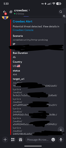

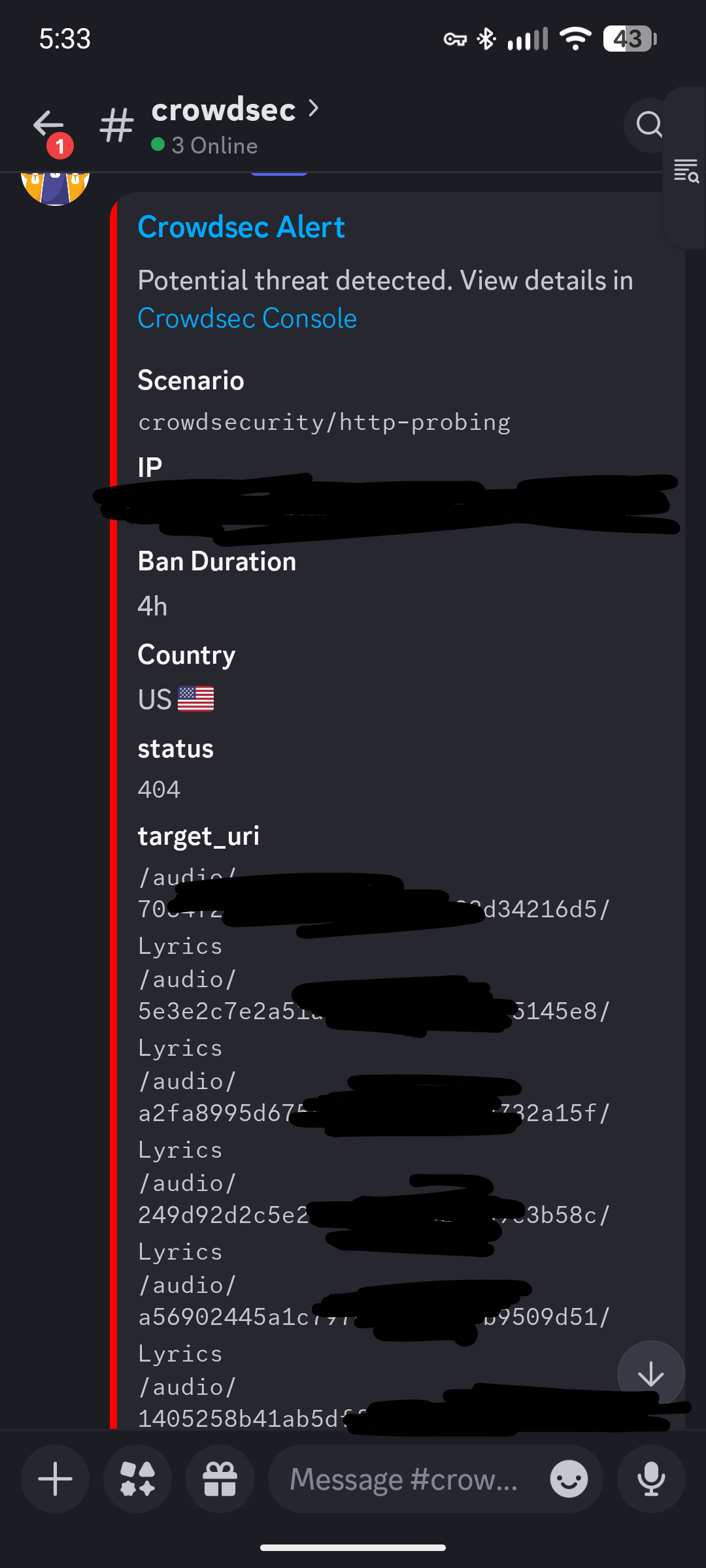

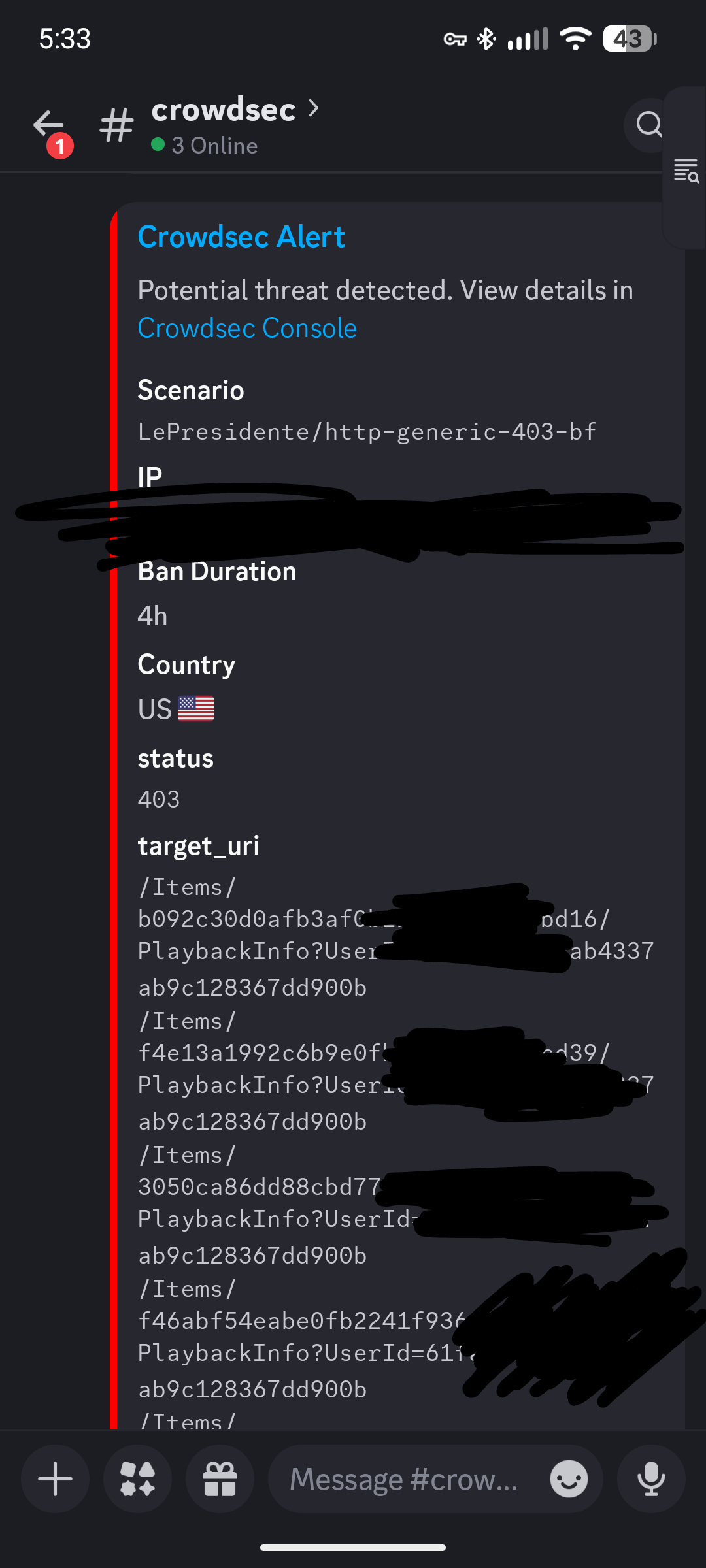

Check on Jellyfin / your auth system logs, it works and give a token and then the token is refused.
You’re right: I found the problem.
Is there any way I can prevent synfonium from making all these invalid requests to prevent it from being rate limited?
The calls are not invalid … They check if your server have lyrics and it report the playback state to the server.
Fix your security tool.
I asked Claude, and he provided this fix for me (for whoever else is running into this niche situation):
    s01-whitelist:
       whitelist-jellyfin.yaml: |
         description: "Whitelist false positives from Synfonium/Jellyfin normal API usage"
         whitelist:
           reason: "Jellyfin API - Synfonium legitimate requests (lyrics 404s and playback 403s)"
           expression:
             - "evt.Overflow.Alert.GetScenario() == 'crowdsecurity/http-probing' && any(evt.Overflow.Alert.Events, {.GetMeta('http_host') == 'example.com' && .GetMeta('target_uri') startsWith '/audio/'})"
             - "evt.Overflow.Alert.GetScenario() == 'LePresidente/http-generic-403-bf' && any(evt.Overflow.Alert.Events, {.GetMeta('http_host') == 'example.com' && .GetMeta('target_uri') startsWith '/Items/' && .GetMeta('target_uri') contains 'PlaybackInfo'})"
