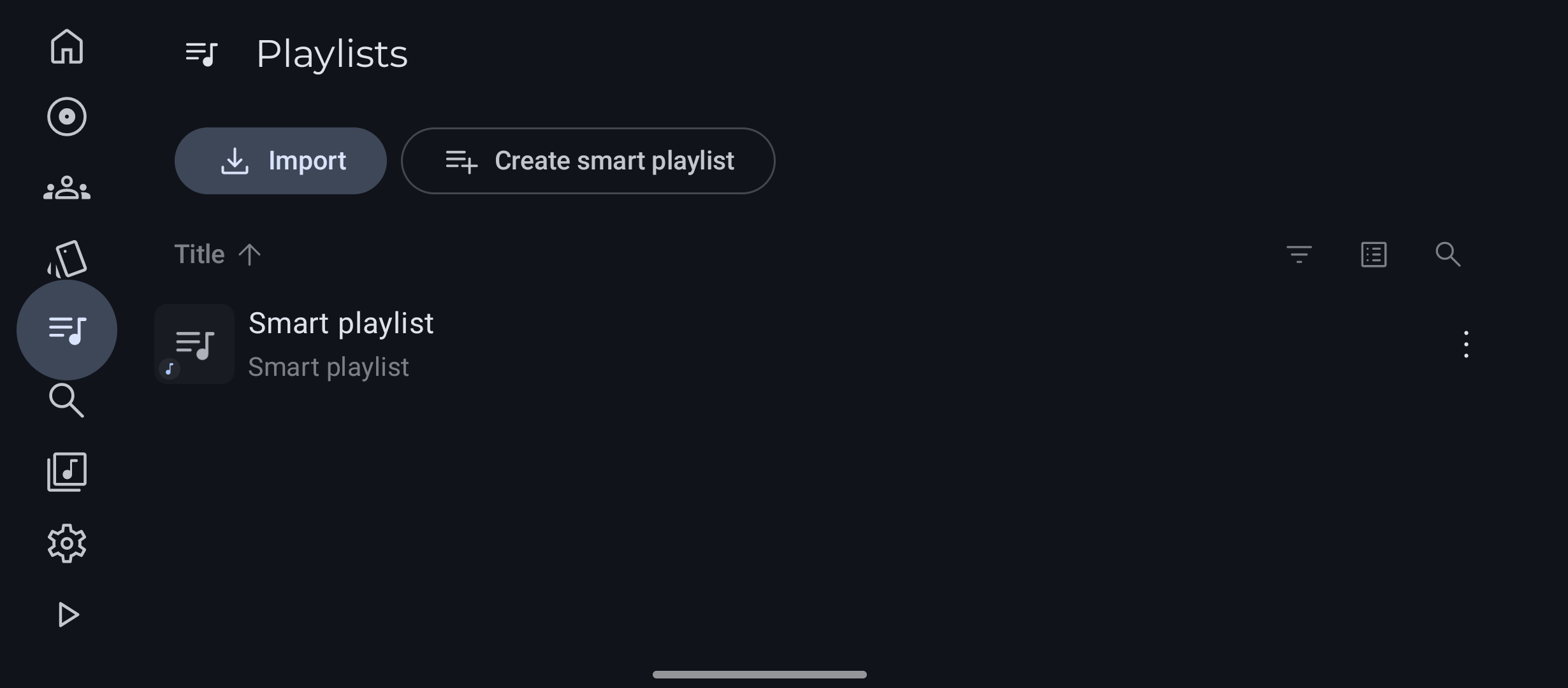

Hi, thank you, but unfortunately that does not work. I went to settings and removed back button from those two places as well as a couple of others and the back button is still there in the playlist screen.
I just double-checked on the latest TV build. After toggling all the settings I said, the only place I see a visible Back button is in the app settings.

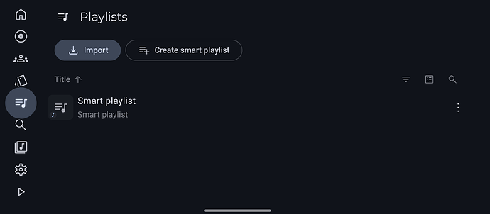

Just to be clear: are you seeing the back button on…
  1. the list of playlists?
If so, double check the setting at:
Settings → Interface → Media lists → Hide back button in lists
The toggle should be enabled
  1. or the track list, after you open a playlist?
Settings → Interface → Playlist page → Hide back button
As you can see in my screenshots, the button can be successfully hidden in both screens.

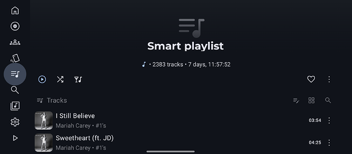

That’s strange. For me, when I open a playlist (or anything else) the highlight is immediately on the Play button. Pressing Enter again begins playing the media, just like you want it to.

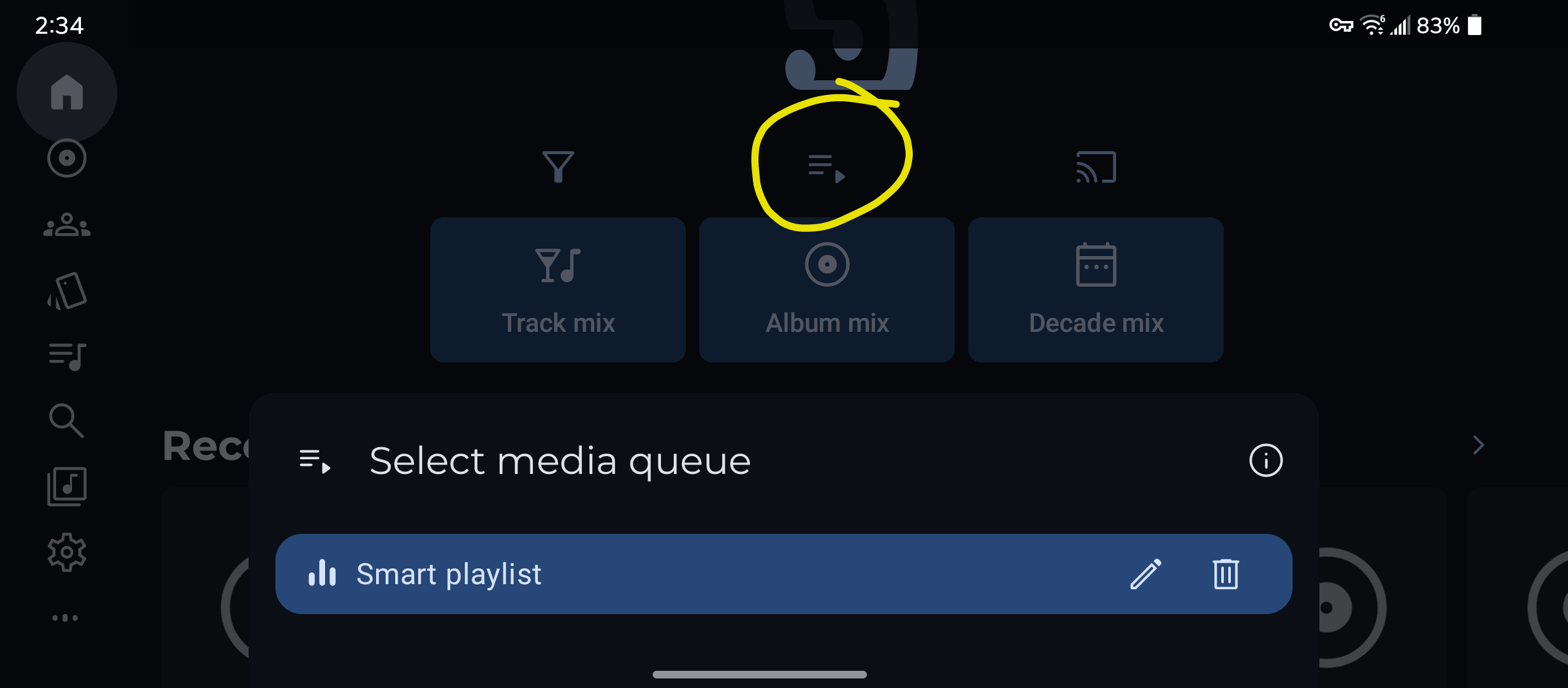

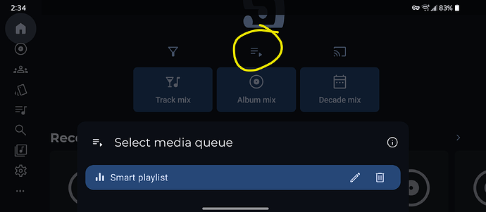

Yes the playlist screen does not remember where you left off in the list. If you want to resume from where you were, you actually want to look for the Queues menu.
You can add the Queues button to the app’s Home Page shortcut buttons or to your Now Playing screen.
This menu will list the last 15 play-sessions you have started. Clicking any of them will resume the session exactly where you left off. (After 15 queues, the oldest ones will be removed for new ones.)

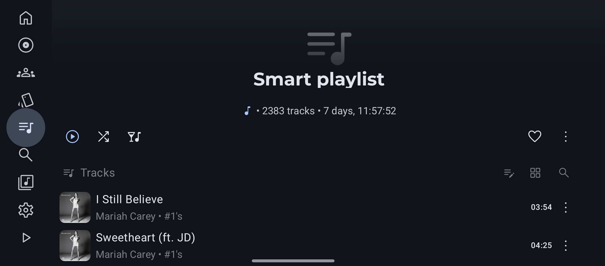

Here’s a quick video of it working on v15.1.0:
