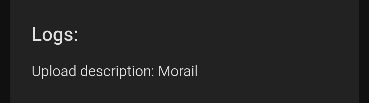

Upload description: Morail

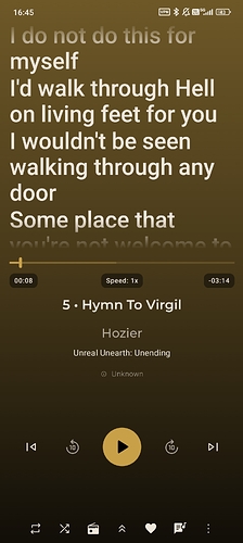

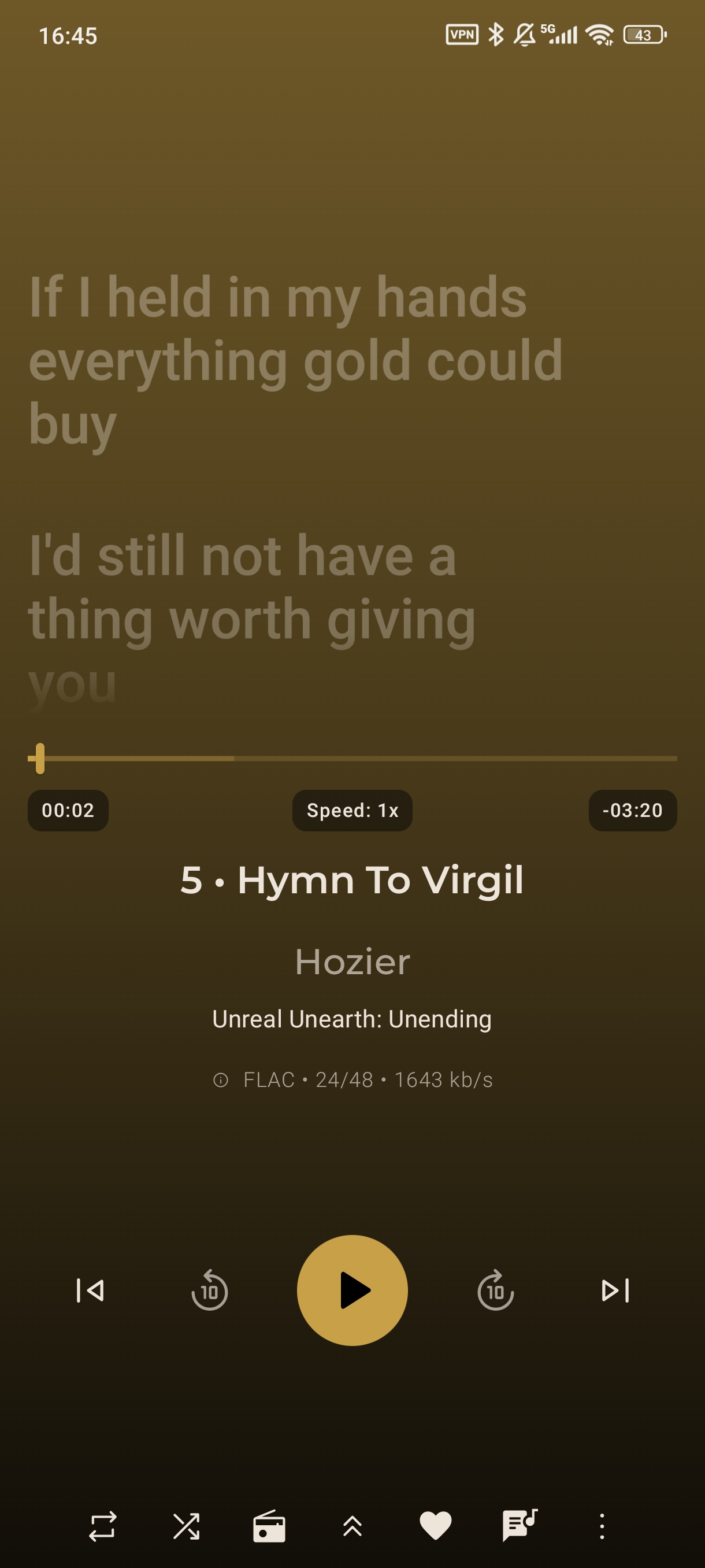

When the wifi is on, play the song and then see the synced lyrics.

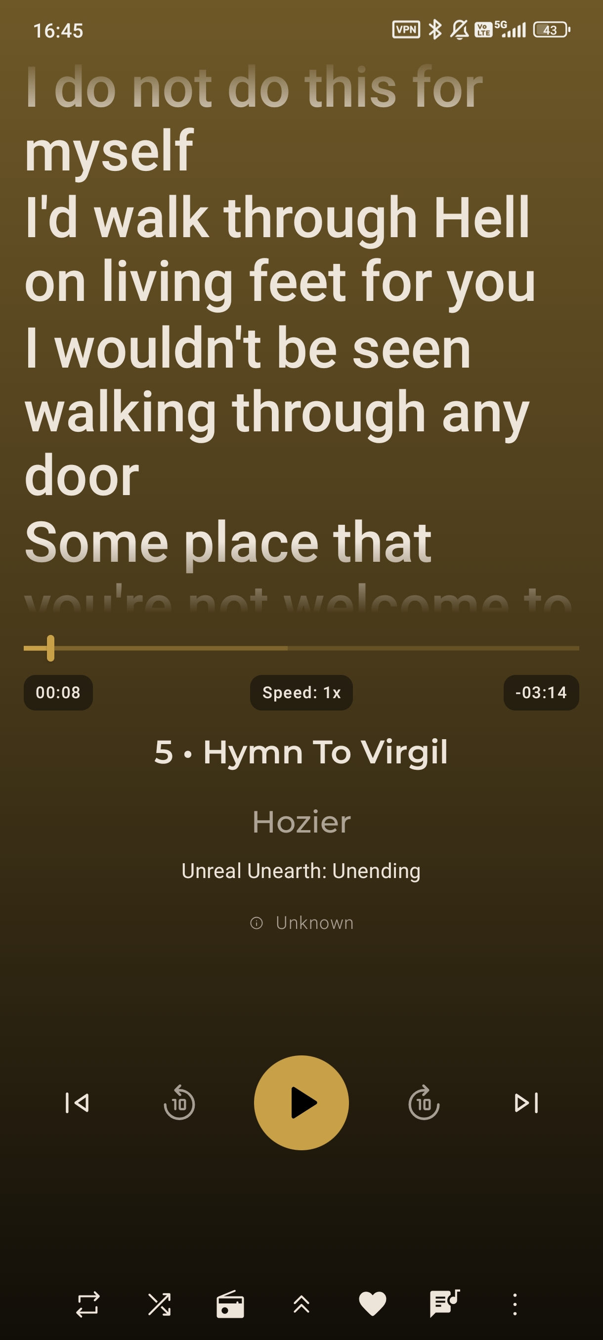

When wifi is off, play another song, but if you play the first one again, now its will be a plane lyrics, unsynced.

I tried it, delete the song file, and then downloading it again, same problem. I also tried to clear the media cache, but still the same, everytime I got offline, the lyrics will be plane again. I uploaded two reports: ”Morail010326” and “Morail010326-A”, the second one is after clearing the media cache.
