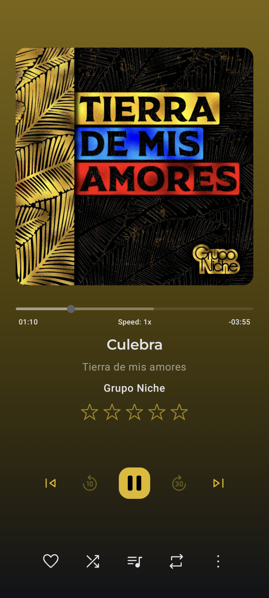

I can’t move the slider anymore. I can’t move back and forth in time with the slider.

You are probably transcoding with a server that is not OS with support to seek during transcoding.
But unfortunately I’m not a magician and can’t guess from a screenshot …

Anyway yes you are using a server that does not yet support seeking during transcoding. Next release of Navidrome will support that.

Thanks for the hint that it’s transcoding. I was able to seek in the past year. I had this issue once before but I just resetted symfonium back then which solved the issue.
I do not know what setting I changed in order to be in this situation now. I just know that I can’t seek anymore. I try a lot of settings but nothing seems to work.
I reset the playback settings.
Seeking works again.
