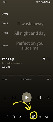

I somehow activated that the Lyrics are shown instead of the cover art on the Now Playing screen and I don’t know how to turn it off again

I’m on the now playing screen and can’t get rid of the lyfics

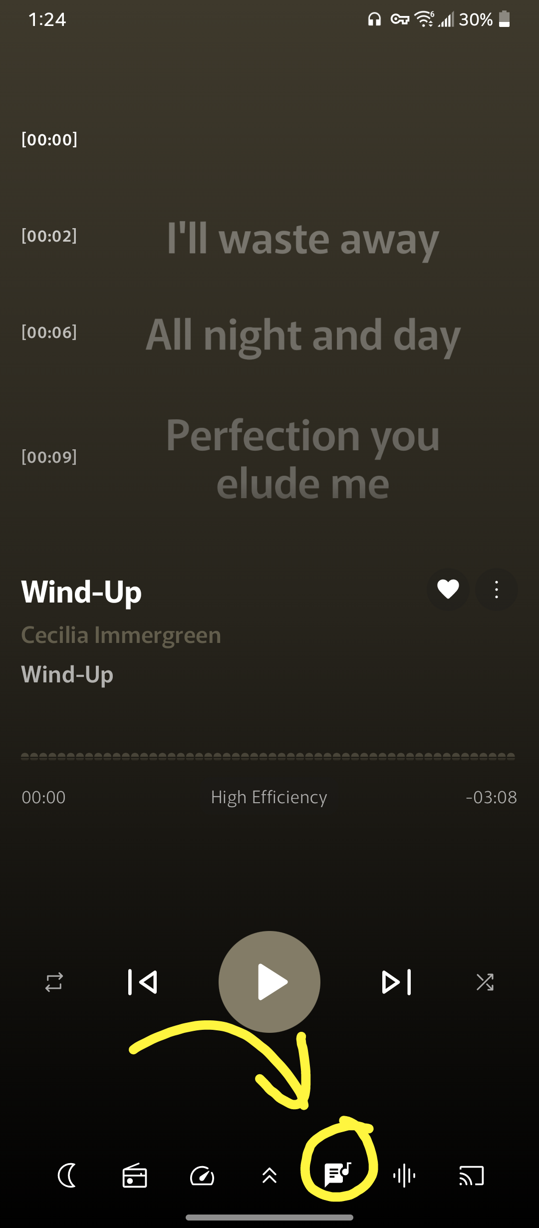

That’s the default “Modern” theme? Click this button here:

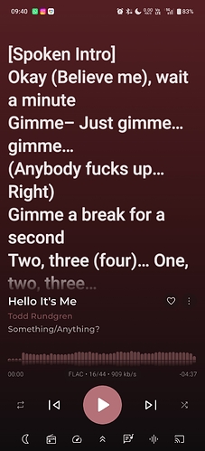

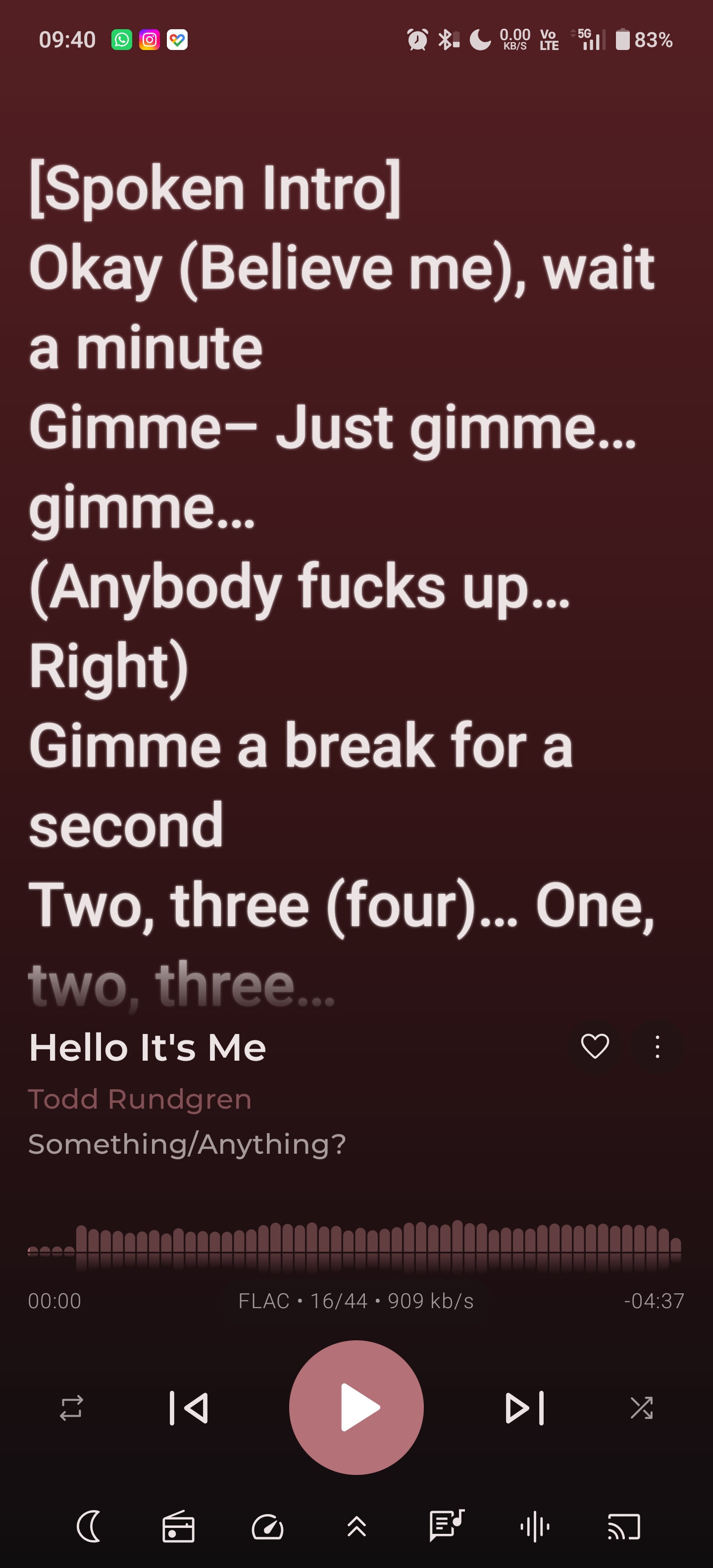

If that doesn’t work for you, you’ve got a few options:
  1. reapply your NPS style – unless it was saved in this mode, it should go back to showing the cover art
  2. edit the NPS style – easiest option is to change your “Swipe up action” to “Toggle cover and lyrics”. Then return to your NPS and just swipe up. (Anywhere on the lower half, not on the lyrics/art section)
I had the lyrics button set to “Lyrics” instead of “Toggle lyrics and cover”. Once I changed that everything worked :slight_smile:
