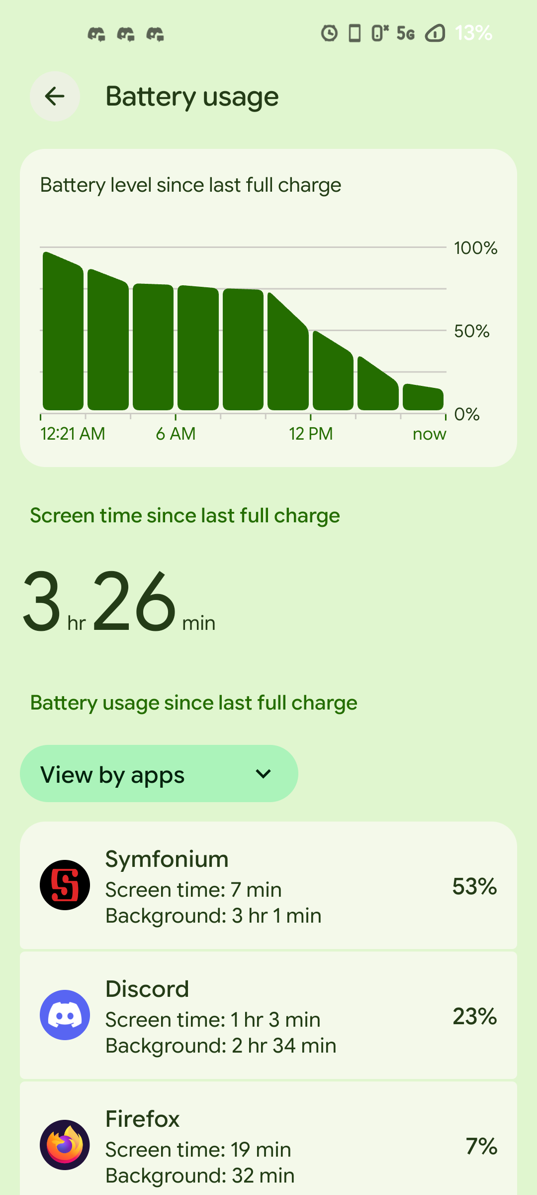

High battery drain during background listening
i’m on a OnePlus 9, LE2117, Android 16
the app uses vastly more battery than I’d expect during background listening on data
transcoding is turned off completely
i checked other issues that were similar but the only one that has any actual solutions i tried and it didn’t change anything
Navidrome

The logs confirm transcoding is disabled. They also show a 10-band EQ, USB headphone adapter, and some uncompressed WAV playback. I don’t see a repeated playback failure explaining the drain.
Please compare 30–60 minutes of the same downloaded tracks in airplane mode, keeping the same adapter and EQ settings. Disable debug logging during the battery measurement and note the starting/ending battery percentages and duration. This will help separate mobile-network activity from playback consumption.
If offline playback still drains heavily, repeat with EQ disabled. Please also specify which Android ROM/build you’re using.
Please also capture an Android bug report immediately after a listening session showing the drain, before rebooting or recharging. Keep your usual mobile-data, USB adapter and EQ setup, with Symfonium debug logging disabled during the measurement.
Note the session’s start/end times and battery percentages, then use Developer options → Take bug report and select Full report if offered. Upload the ZIP through the private support upload service, since it contains system-wide diagnostic information. Please include your Android ROM/build too.
i sent the bug report but forgot to note i’m on lineageOS 23.2, the latest nightly found here
