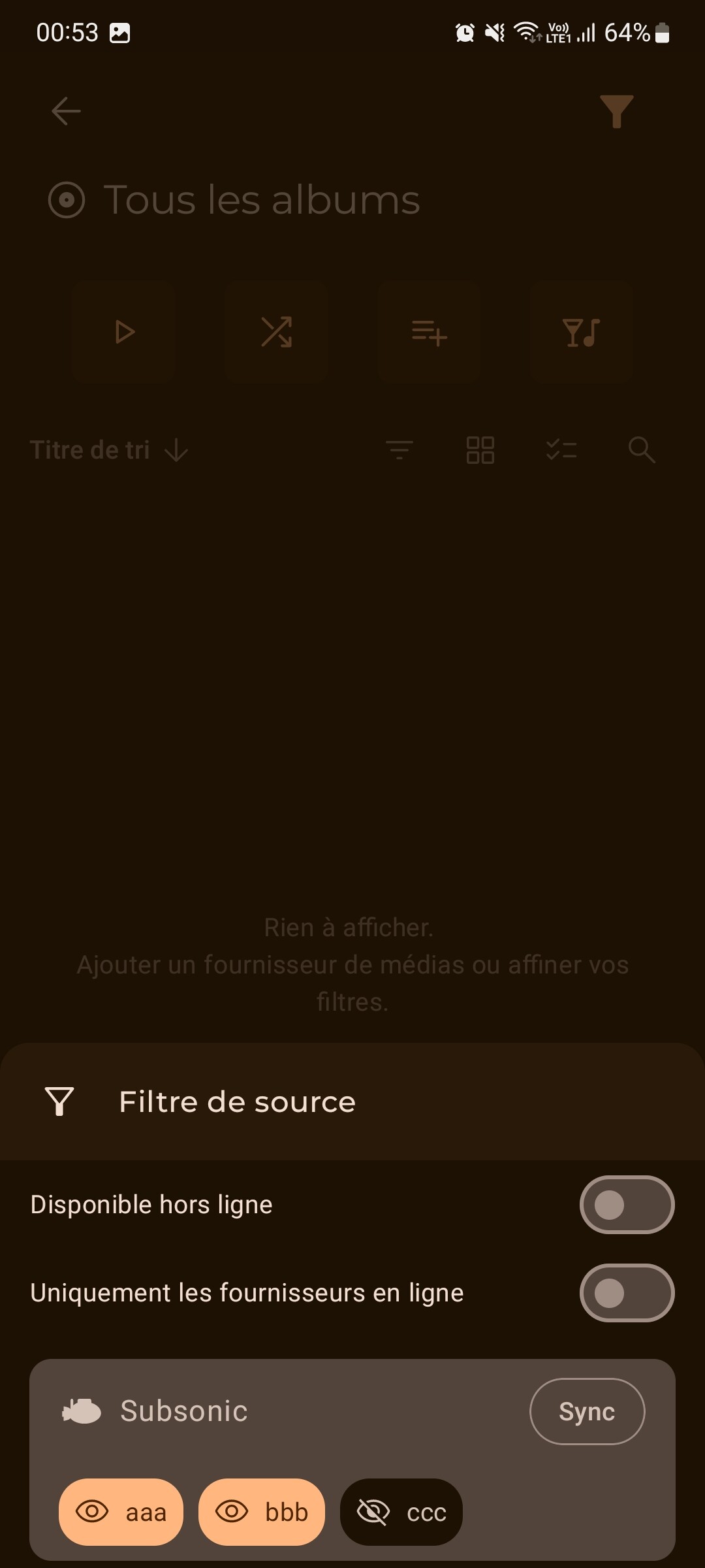

Hi,

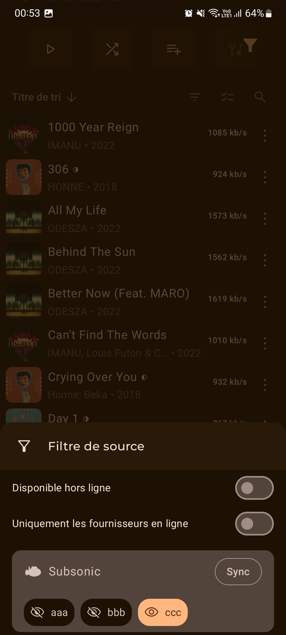

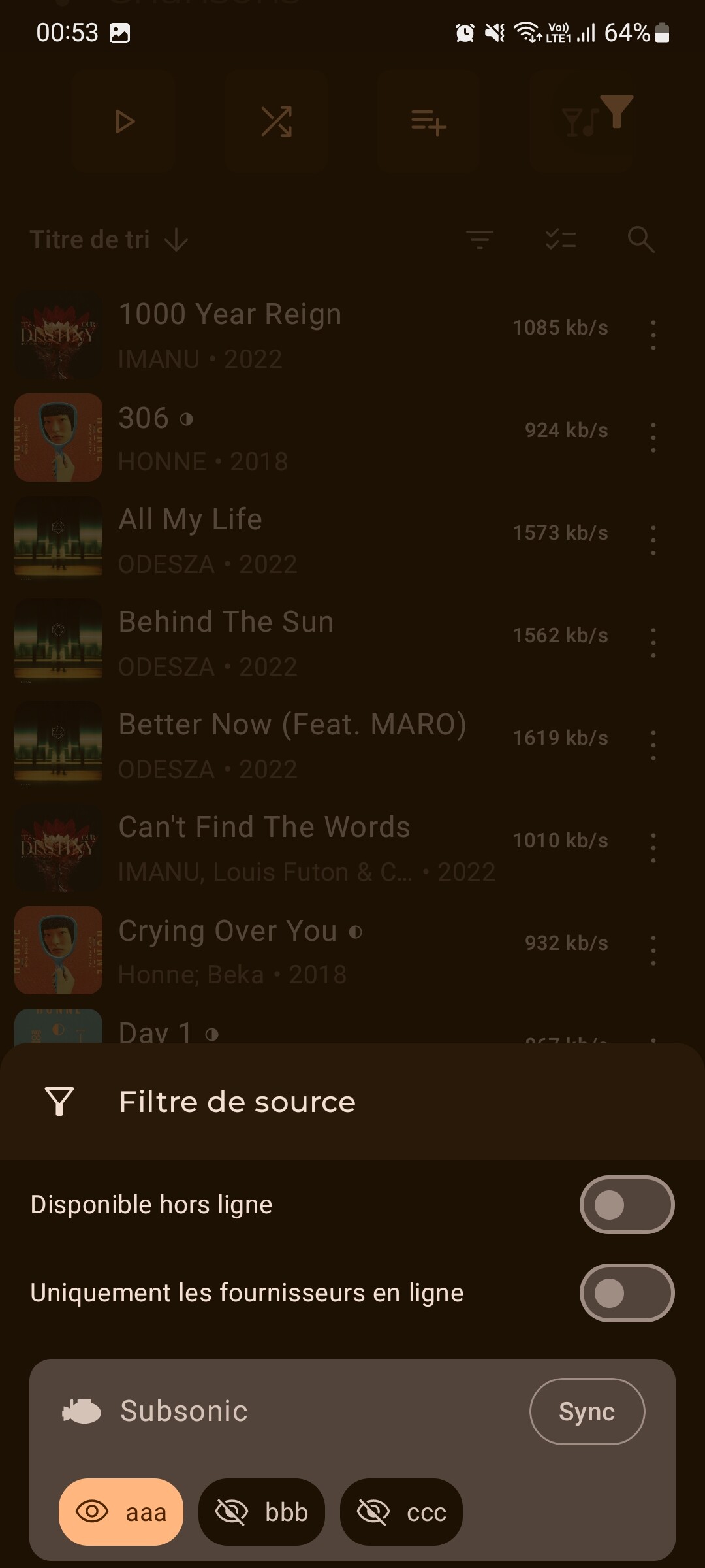

When I try to hide a library from the source filter view, it does nothing.
I can still see and play a song from a hidden library.
And the weirder thing, if I hide the last library, I can still see all the songs, but there is no albums showing up in the album menu.
I am using Ampache. I tried with gonic and it works just fine.
Is this a limitation with Ampache? is there a setting I need to change?
Thanks for your help.
debug.log (13,4 Ko)
For context, each library contains one album.
