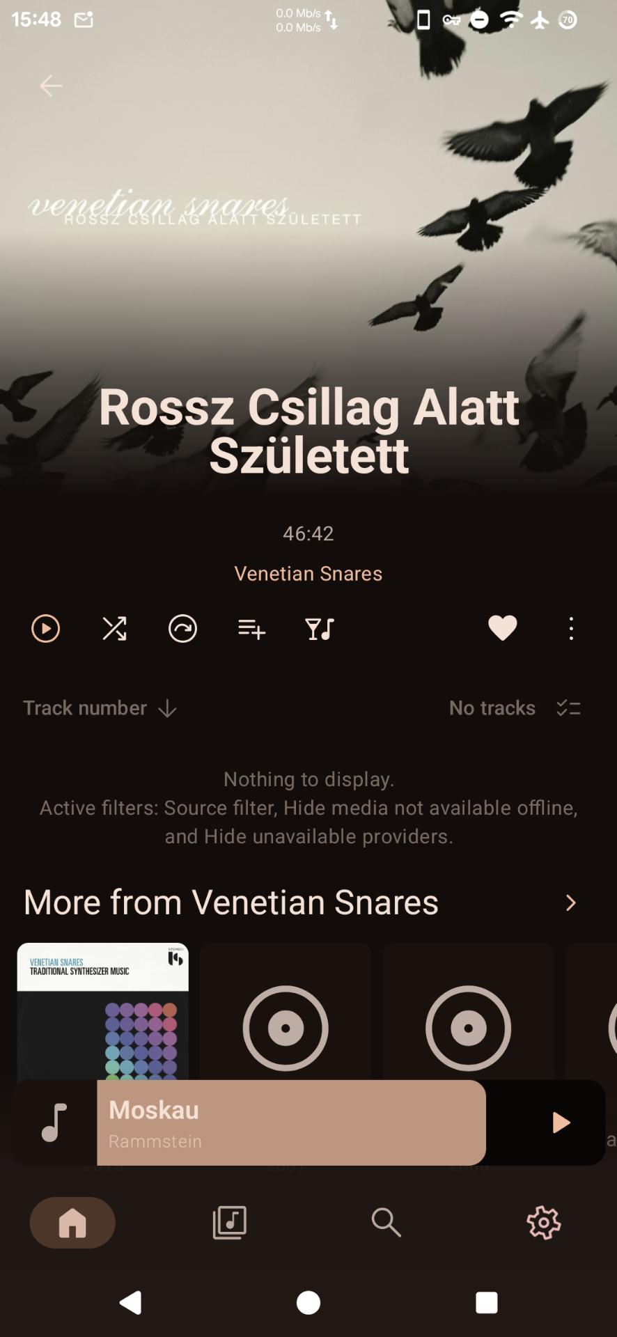

    Actual:
  5. “Nothing to display”

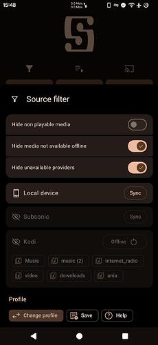

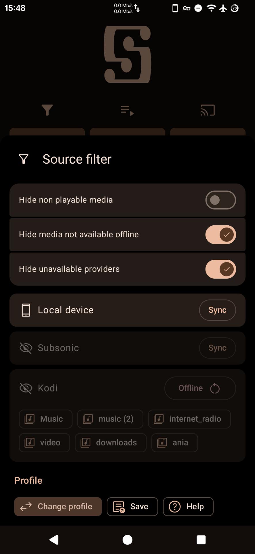

  7. Click Source Filter
  8. Uncheck “Hide media not available offline” (while still being offline)

Scenario 2:
  1. Play some music from your SD card
  2. Go offline
  3. Search for some other music (while the music from your existing queue still plays just fine)
  4. GOTO 4 in scenario 1.
