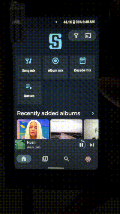

Uploaded from the app directly under my name… let me know if you dont see it. Here is a video as well… pretty straightforward forward… no audio while on youtube and scrolling is hosed when symfonium is on and once I kill symfonium youtube works flawlessly.
IMG_0257
There’s no YouTube on that video.

There is youtube video in the browser. I can send you the entire video… this wont allow to upload… how can I send the whole video. And i paused the music on symfonium. I can kill the app and just restart it and not play music and it will still mess with youtube playback. The mere fact that symfonium is running alone interferes with youtube / other video playback. If there is a workaround am good with that
