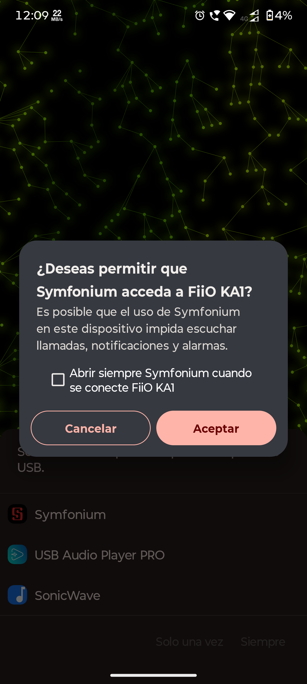

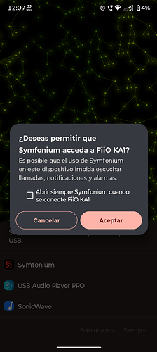

When I connect the DAC, a popup notification appears at the bottom of the screen asking what app I want to use when there is more than one app with USB DAC support, if I want, I can select Symfonium from that menu and it will open automatically.
However, there is an issue where the popup notification from the app also appears on top of the other menu and that should not happen, the only notification that should appears is the one at the bottom, you can see it on the attached screenshot.
The other issue is, if I dismiss the bottom notification and then open Symfonium, the popup notification never appears to get connected to the DAC, so I have to disconnect the DAC and re-connect it to try to get connected.
Therefore, this is the correct behavior:
When I connect a DAC and the bottom notification appears, I should select Symfonium as the app I want to use.
If I dismiss the bottom notification and then I open Symfonium, the notification to get connected should always popup.
If I dismiss the popup notification when I open the app to get connected to the DAC, when I exit the app and return, the popup notification must appear again until I get connected.

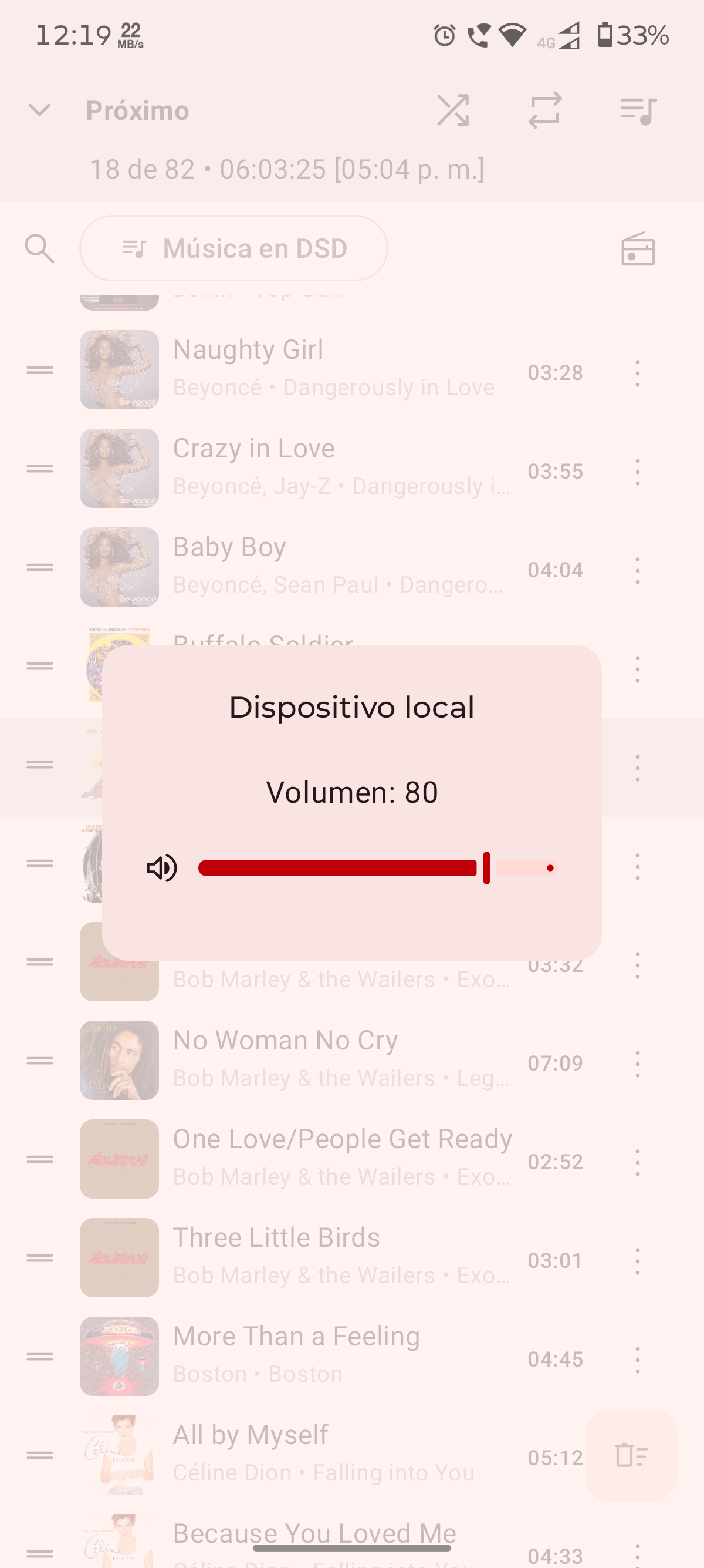

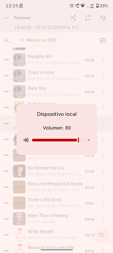

Issue # 3:
I wouldn’t call this an issue but an enhancement, it is related to the volume level control for the FiiO DAC. The FiiO DAC has a very loud volume level when I set it to maximum, however, with symfonium, the volume level seem to be limited to some degree, the problem is, I’ve been unable to test this thoroughly because of the issue # 1.
The steps to reproduce the issue are explained above.
