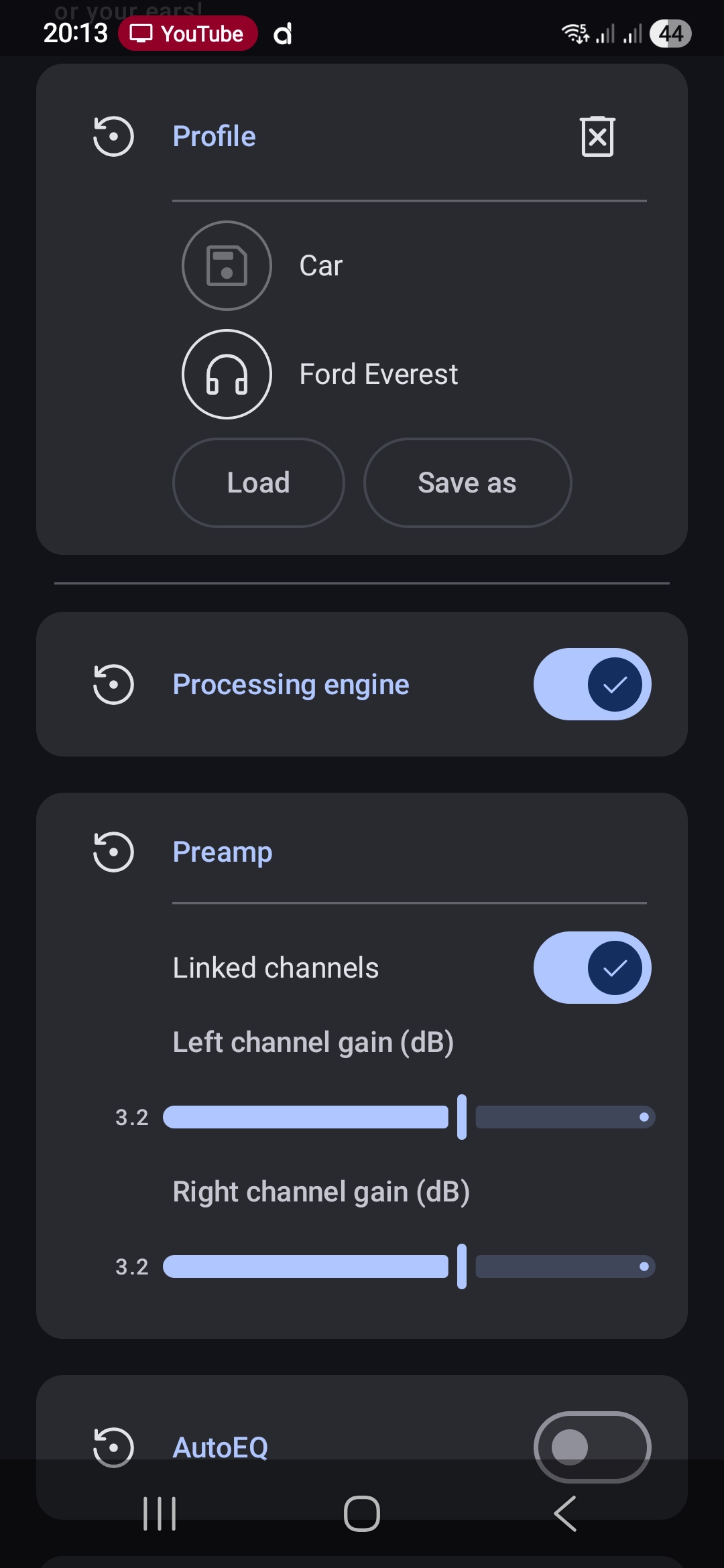

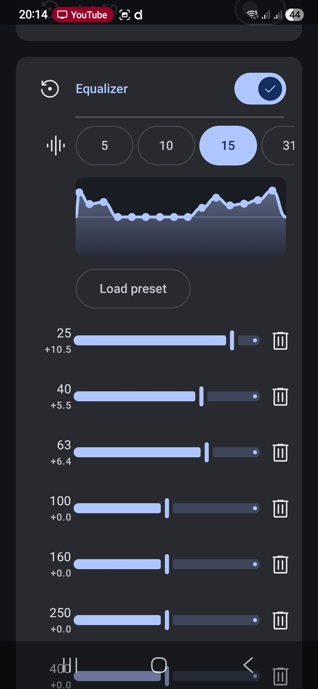

When contecting via Bluetooth to AA, whilst the correct profile is being used, the EQ settings are not being applied. They do seem to work for a split second but are then not used. To make it work, I either turn off and on again Eq or do the same with the processing engine and then the settings work on AA.

  3. Open up symfonium app, go to setting>playback>playback>eq DSP> turn off processing engine, then turn back on again. Can also to the same with the equaliser slide switch.
  4. Settings are applied , as music is noticeable enhanced.

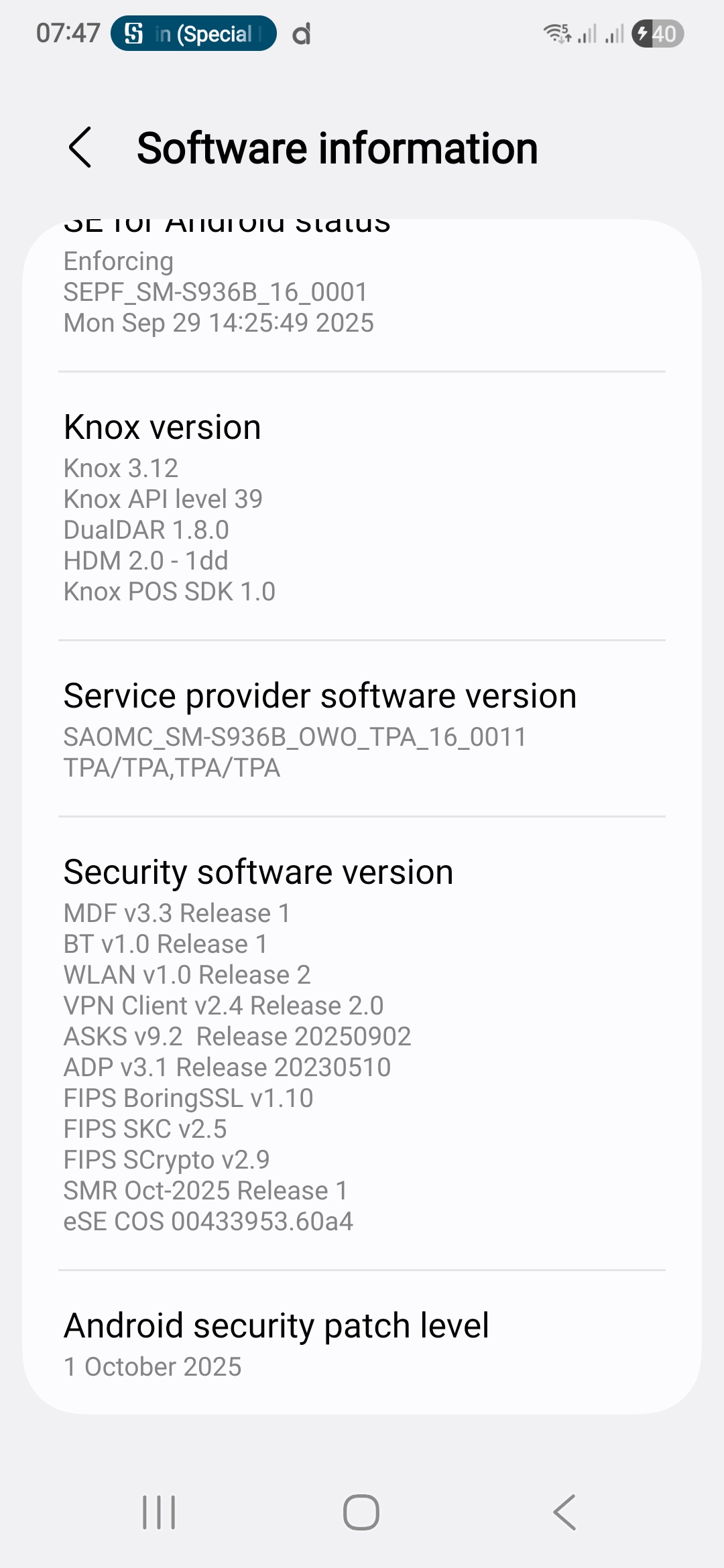

Did you get an AA or Samsung update 3 weeks ago ?
Yep. Looks like I did.
And to make matters worse, AA updated last night and the QUEUE button has gone again, and music is stopping, so I have bigger problems now. :zany_face:

Not just you, but probably a Samsung bug as often. I guess the s22 is not on Android 16 and so not the same level of patches and so not with that bug.
