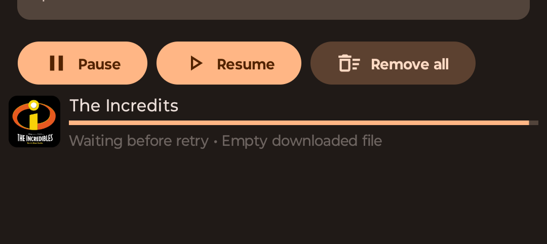

"Empty downloaded file" when caching songs
When caching tracks from my Jellyfin server, roughly one in ten downloads fails with a “Empty downloaded file” error.
Usually upon retrying once or twice it can download the track successfully, but sometimes it breaks and the track seems cached but does not actually play when offline.

From the logs seems your server sometimes just does not send data.
Symfonium is relatively aggressive with downloads, check Jellyfin/Caddy logs for errors or security triggering.

Well yes 1 by 1 and slower protocol version. But this confirms a server side issue :frowning:
Anyway the workaround is added as an option and will stay starting next release.
