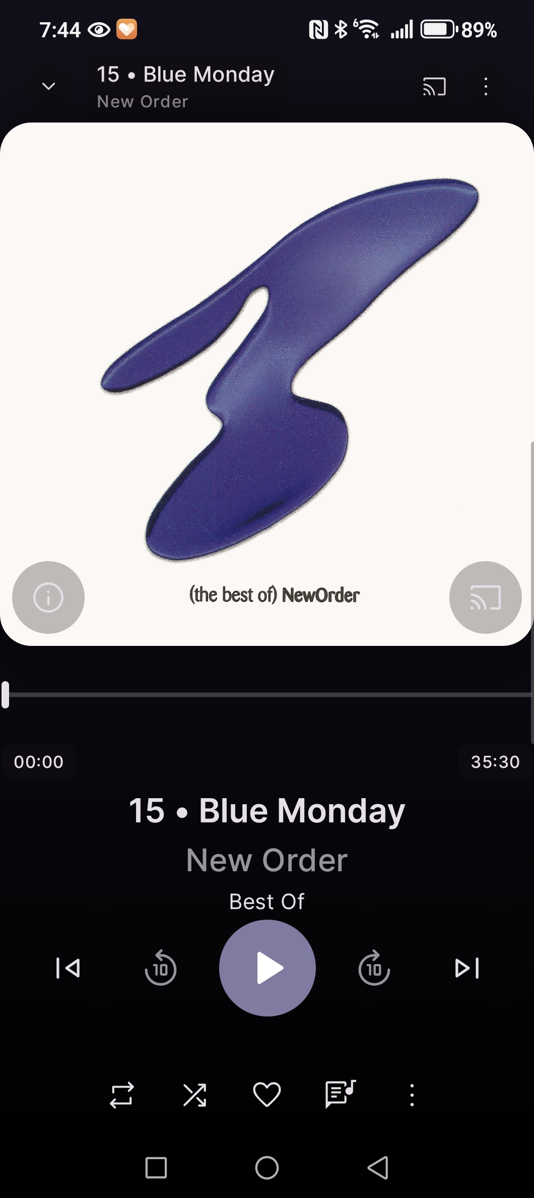

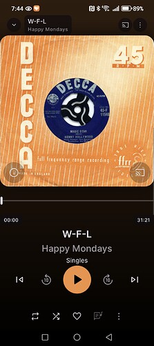

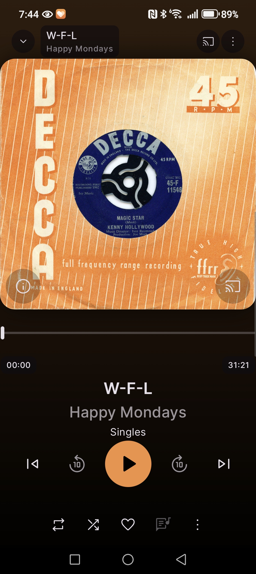

When I download the 200+ songs of my “Late Night Dance Party” playlist about two-thirds of them show the wrong length. They’re showing as much longer than they are, and usually about double the correct length. Worse, they play for this amount of time, usually adding the extra (silent) time at the end of the song and making the playlist useless.
Downloaded songs are a mix of FLAC and mp3.
UPDATE - This is also a problem with tracks played from the server. And when played, songs with the wrong length play normally (but NOT for the time shown) and a few minutes of silence to the end, but NOT the time shown (for example, Blue Monday will not actually play for 35m30s, but will add 2-3 minutes of silence after the song ends).
Interestingly, I notice that when looking at the original albums of playlist songs they are now showing as the wrong length there, too. Again, this is not the case in PlexAmp - song lengths are all showing correctly there.
Upload description: StuPC
Screenshots below show the stupidly long track times. The track times in PlexAmp show correctly as 4m07s and 6m13
Literally just downloading and playing the music files OR playing them from the server.
