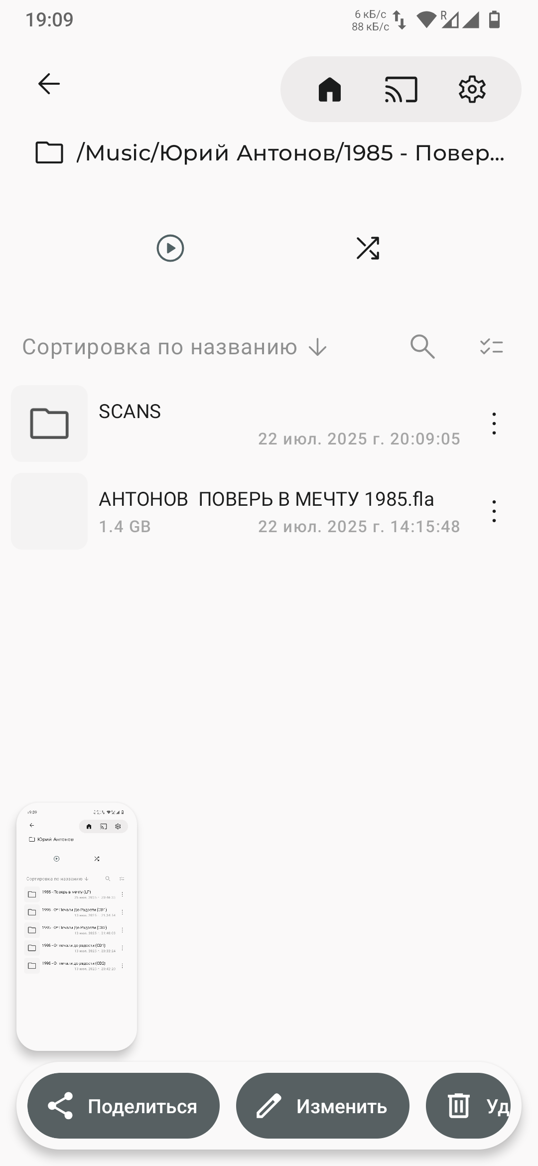

Anyway yes it’s supported in library mode, and thanks to the logs I can confirm that yes there’s a problem with detection.
Probably due to Cyrillic. Can you upload the cue file to https://upload.symfonium.app (And eventually the flac too) so I can reproduce ?

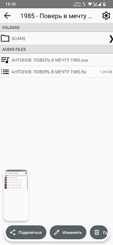

So TL;DR; the file is named .fla and so not a music file and so not scanned.
