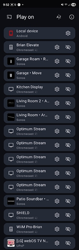

@Tolriq I’m having a very similar issue. I’ve uploaded logs as “bigmack3000”. One small and one large (sorry).
When I check the wiim app, it sees and is connected to wiim pro, but in synfonium, it can’t be found. Occasionally, it finds the chromecast for it, but not upnp.
The small log is just there incase you can see why the unpnp isn’t being found. Its just me opening the app and checking casting options. The reason I included the much larger log is because after one restart attempt of the wiim pro, symfonium finally picked it up. I played music for awhile, but then the upnp option disappeared from the list again:
However, it continued to stay connected and play music. I then stopped the current playlist, incase it was just cache, played a brand new song. It continued to work as if it was connected. Despite not being an option under casting:
It had been working perfectly for months. I know upnp can be very finicky. I don’t know what’s changed. If it’s something I did, or not.
Thanks! Again, sorry for the larger file. If it had not disappeared during that session, i wouldn’t have uploaded it.

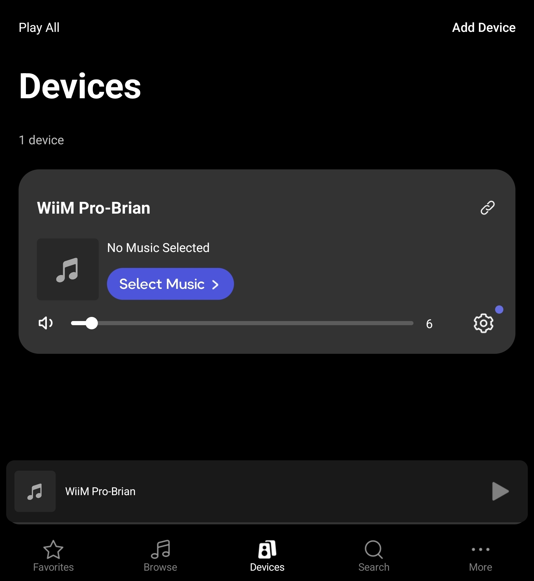

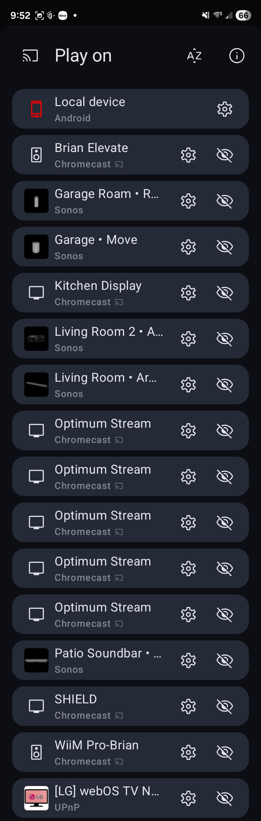

For me my Wiim is still nog visible in the device list. Do I need to change some settings? Or is this still a bug?
Thanks!

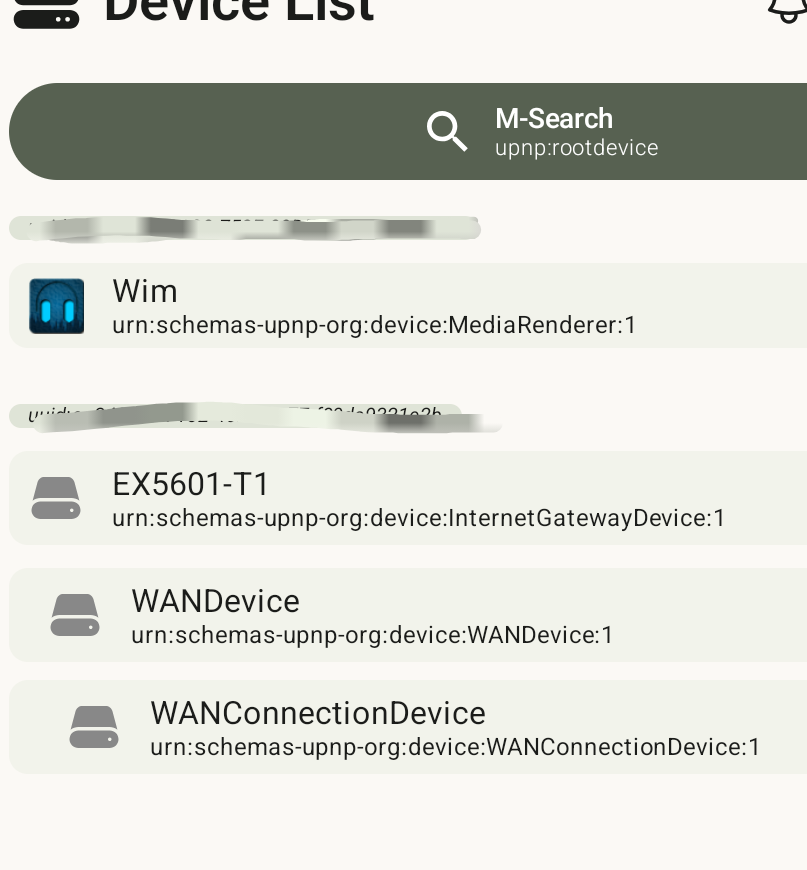

Is your WiiM listed (immediately) in the Android app UPnP Tool?
Yes, instant!

You haven’t accidentally hidden it have you?
Found it. It was apparently under the hidden devices. Did not know I ever pushed the hide button. Thanks!
