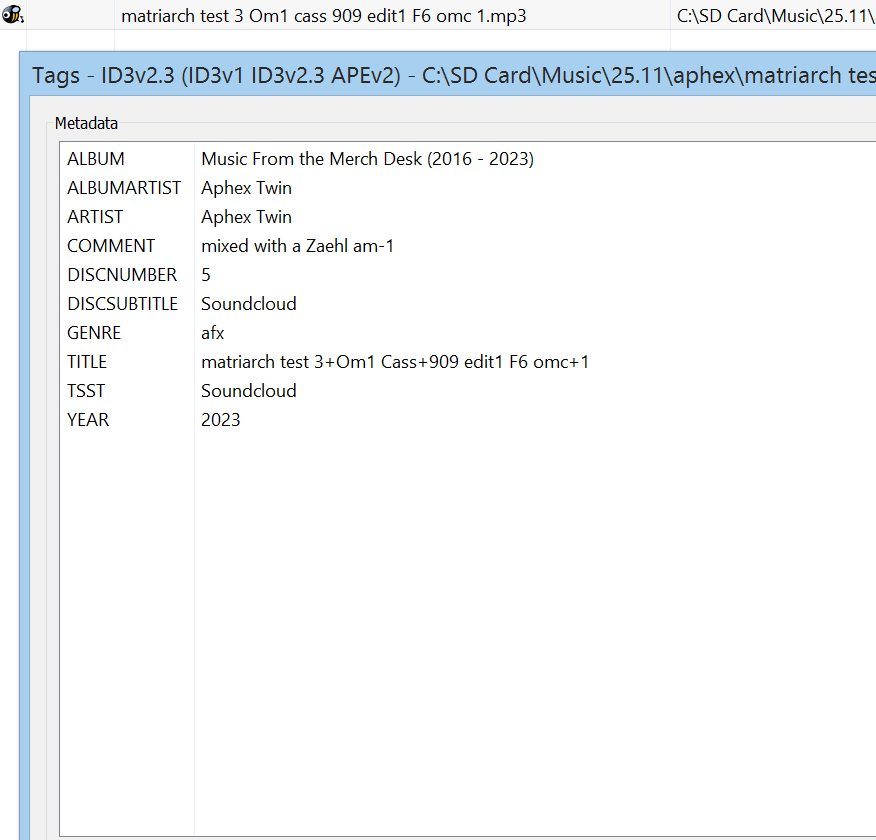

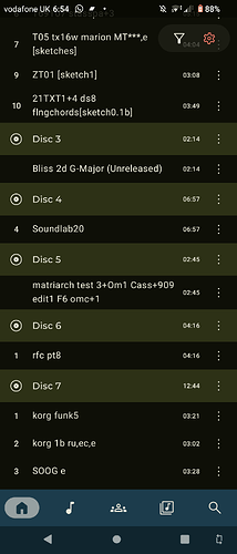

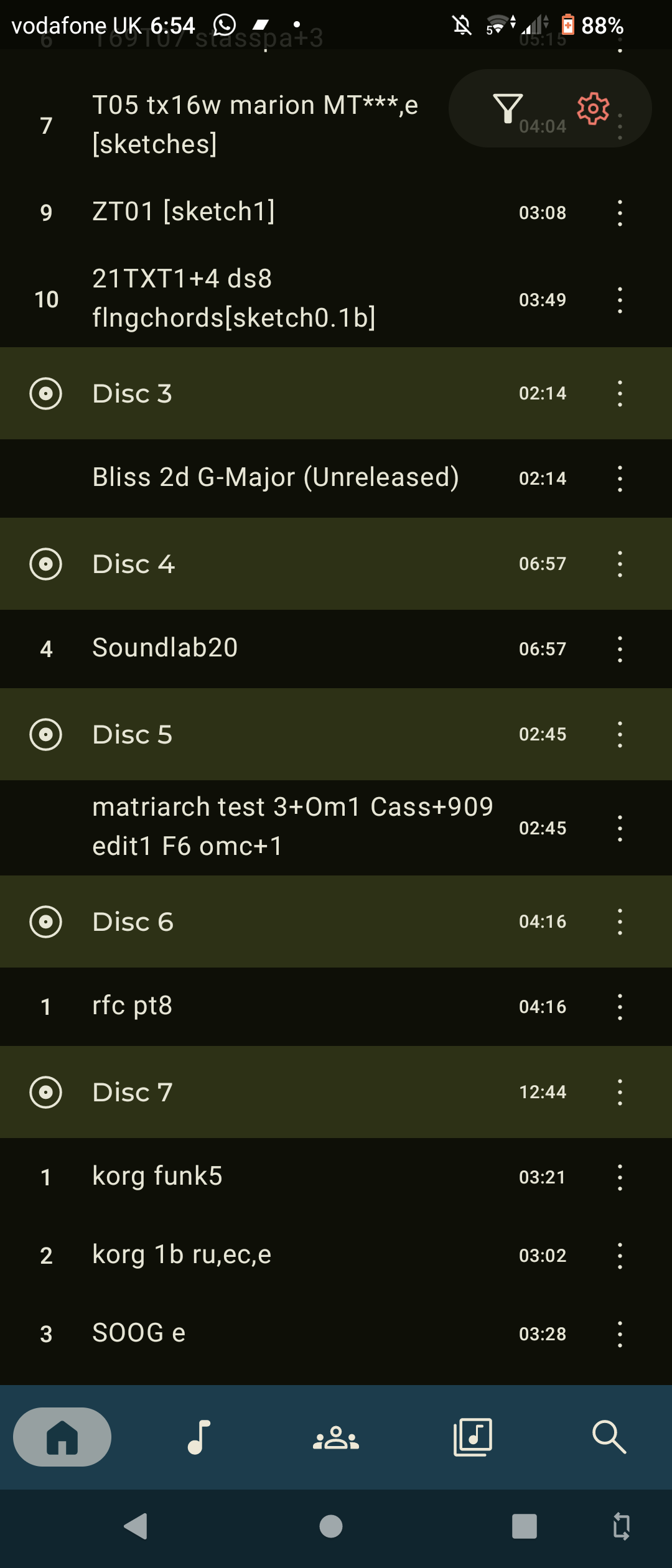

Hello, added disc subtitles for the first time, and they are not being displayed in Symfonium, the regular disc number is still being shown.
I have rescanned after clearing tag cache.
I have tried using the tags TSST and DISCSUBTITLE.
I have uploaded a file for you to look at the tags under the label “tobyburton96 disc subtitle not displayed”.
Thank you
Upload description: tobyburton96
Your tags are wrong.
The TSST is added as a TXXX:TSST and not the proper TSST frame.
In ID3 you normally use TXXX:SETSUBTITLE as an alternative as TSST is DISCSUBTITLE.
And do not put 3 different TAG format in the file, they have ID3 V1 V2 and APE tags.
