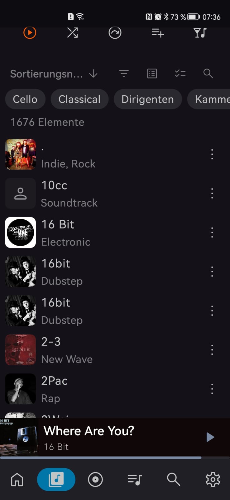

I have written correctly the artist tag, the album artist tag and also the folder in the media library are different folders.
Nevertheless, they are listed as a single artist in the Symfonium library.

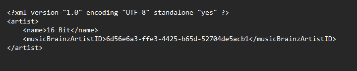

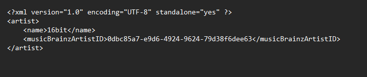

In folder ArtisInfo i have created two folders with one file named artist.nfo.
The IDs are originally copied manually from MusicBrainz.
pls see Screenshots:
Music/ArtistInfo/16 Bit/artist.nfo & Music/ArtistInfo/16bit/artist.nfo

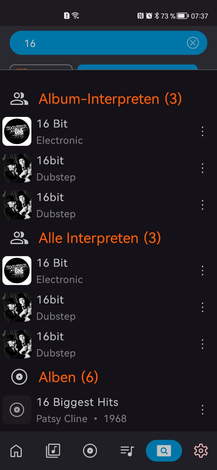

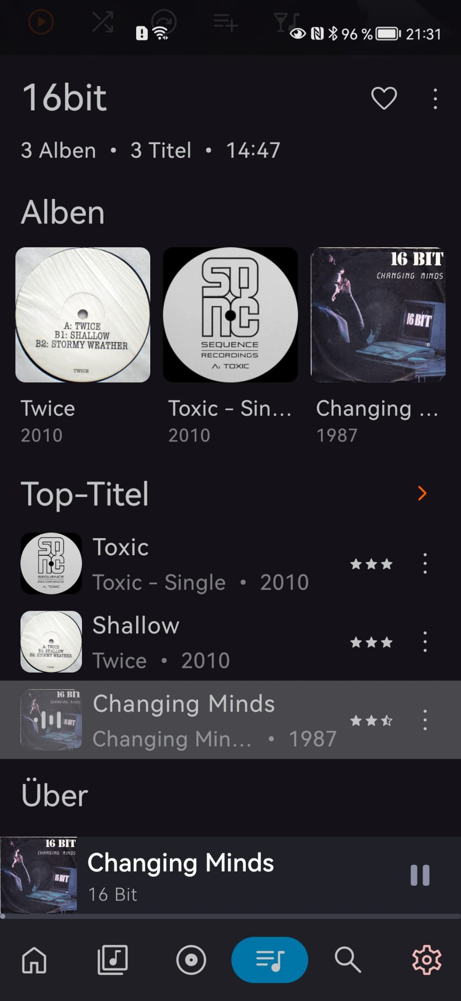

Now I have three artists in the artist view and in the album artist view although I only have two original musicbrainz artist ids.

Only the display in the Symfonium app always shows 3 different artists. (See the photos above)

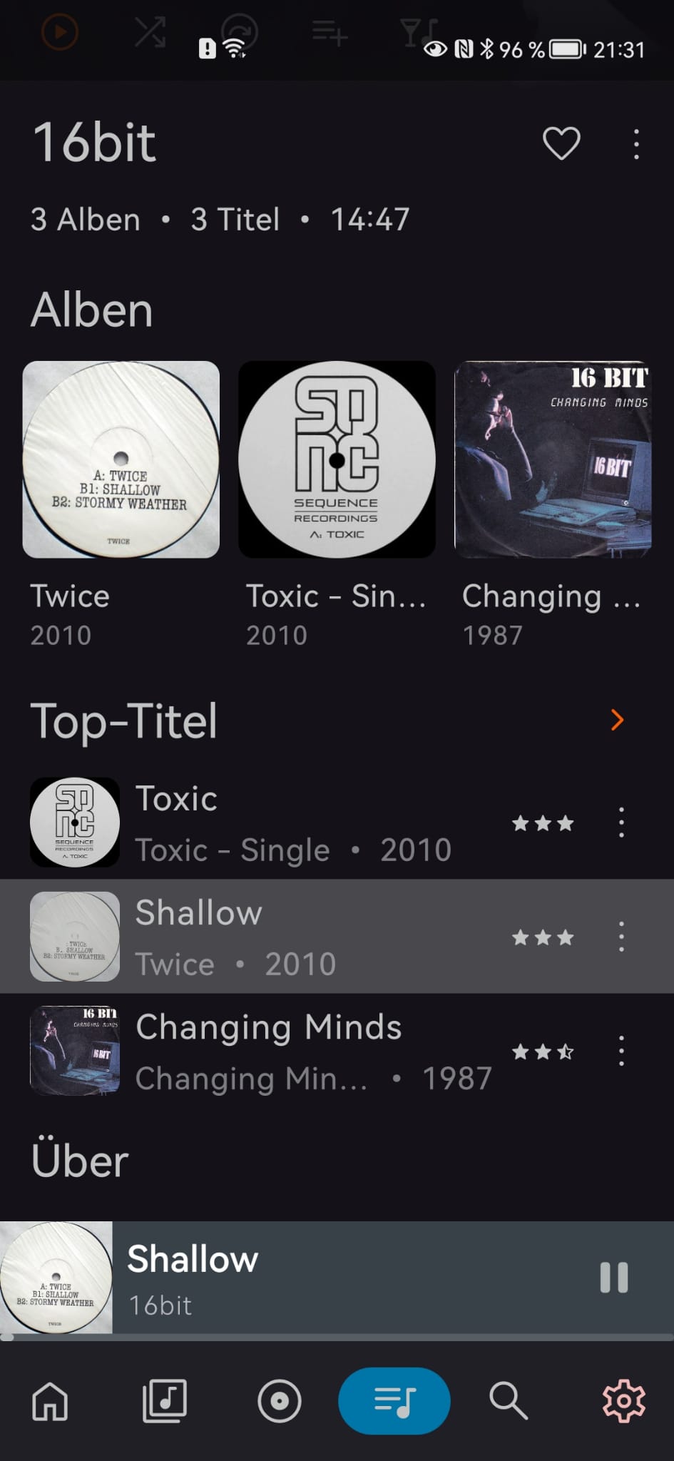

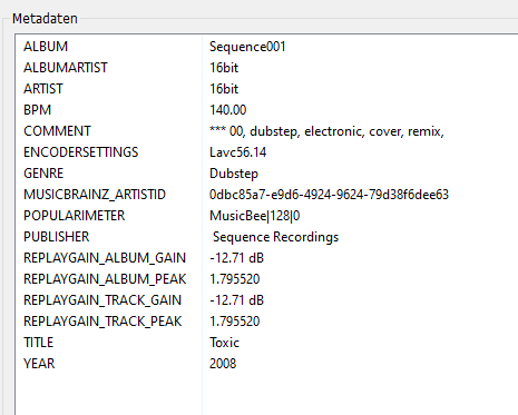

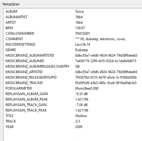

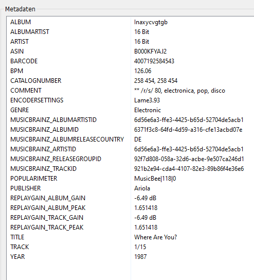

The last two pics are from the two files of 16bit and should be listed under an artist. Unfortunately this is not the case.
As you can see, the Musicbrainz artist ID is identical, as are the artist tags. The files are also in the same folder.
The difference is quite visible :wink:
The one in the middle have an album artist but not MB album artist ID.
Add the MB album artist ID to that one…
