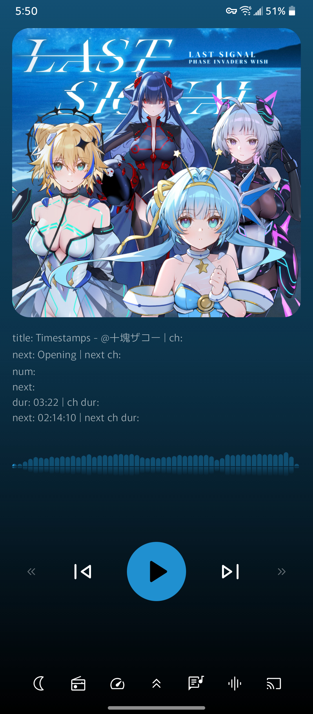

Skip back to track 1. Chapter strings should be blank but may instead show values from track 2. (Doesn’t happen every time. Just change tracks a few times until it does.)
This doesn’t happen every time but it does happen often.

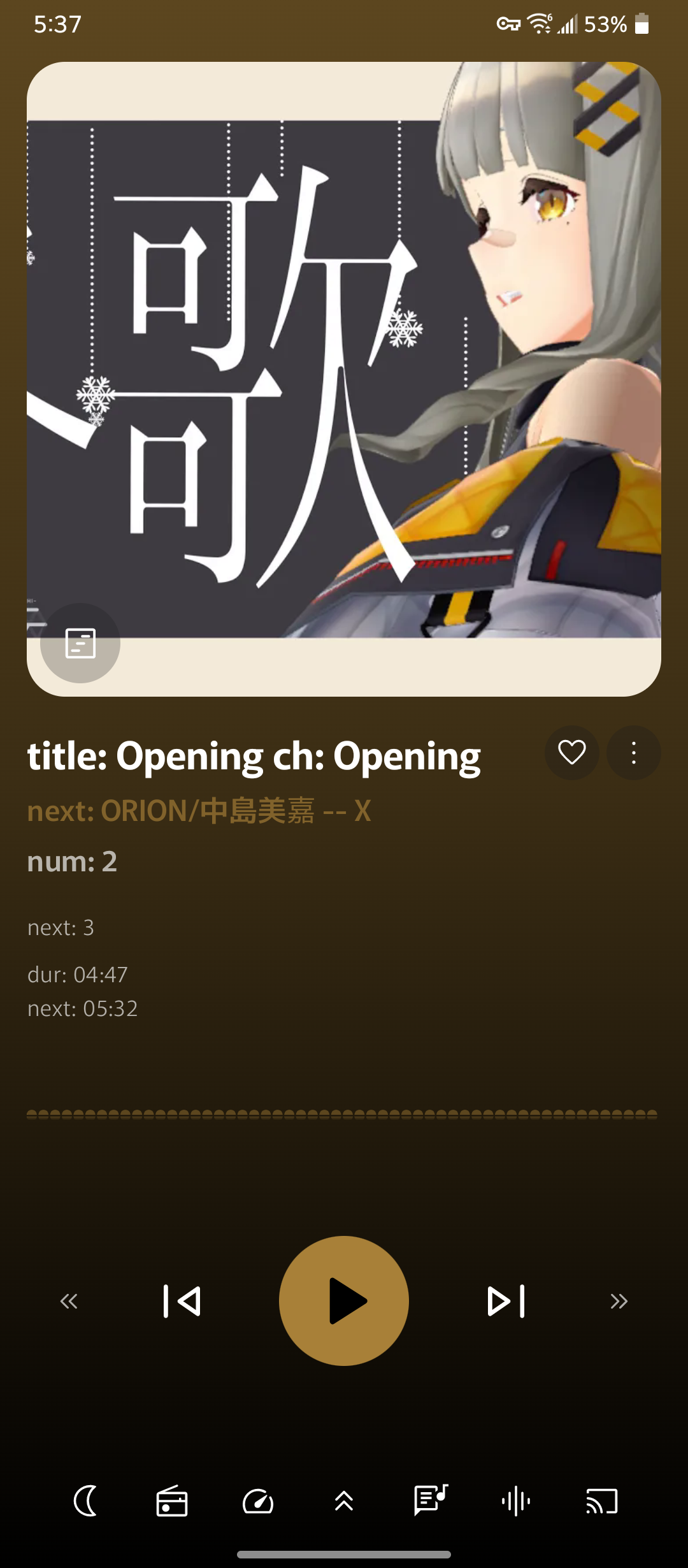

Update: issue only occurs when %title% and %chapter.title% are both used in a single string slot. (Optionally with “next” prefix.) The value of %chapter.title% is used instead of %title% for the track with chapters:
“Opening” is correct for the Chapter name, not the track title. String shown is this:
{title: %title%}{ ch: %chapter.title%}
Then skipping to a non-chaptered track (forward or back) behaves as I said above:
Only title strings are affected. Once affected, values remain until playback is stopped.
