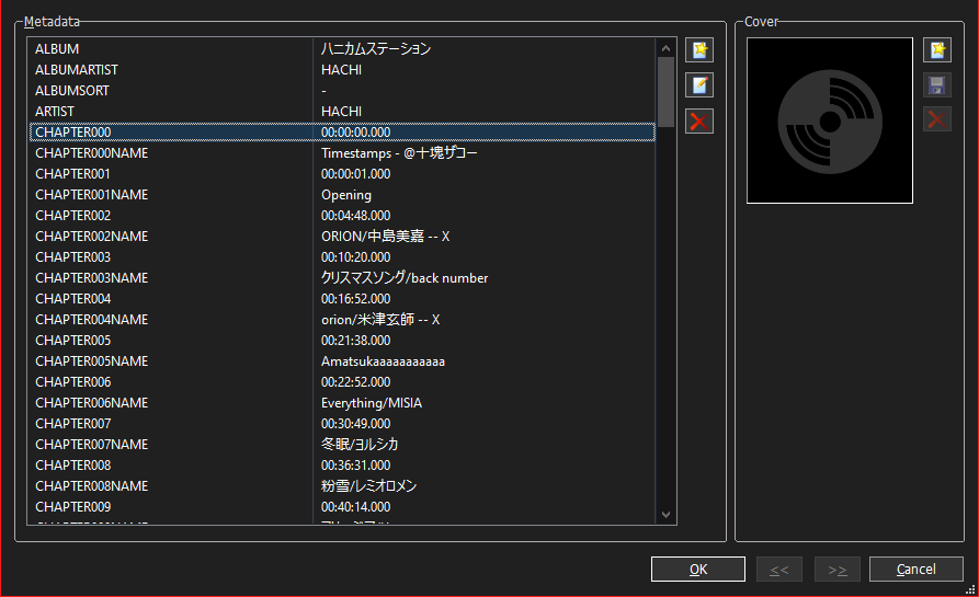

Tag format:
Specifically, the issue is that both CHAPTER000 and CHAPTER001 are indexed as Chapter 1.

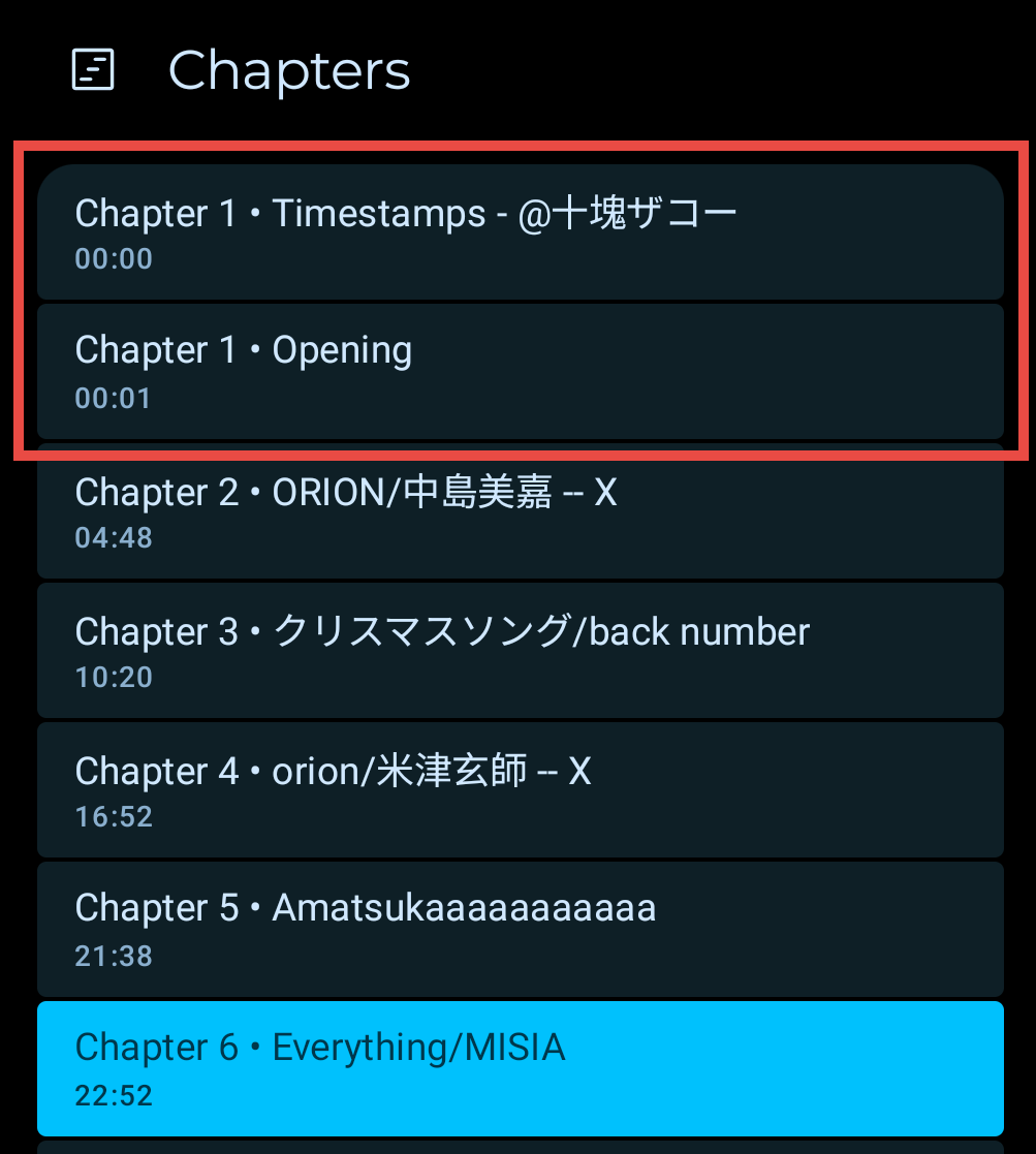

Taken from your own screenshot:
Aside from CHAPTER000, the chapters match the value of the tag when they should instead have value of “tag +1” (e.g. CHAPTER002 should be index 3, not 2.)
Tag an OGG/OPUS file with 2+ chapters, including CHAPTER000 and CHAPTER001. (Or use the file I uploaded yesterday, with description Celorien_Chaptered_Opus)

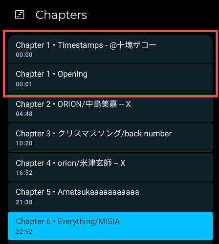

View chapter list in Symfonium. Both of these will show as Chapter 1.
The final chapter in the file I uploaded returns %chapter.index% == 23 but %chapter.count% == 24, breaking my last-chapter conditions. (The count is correct, there are 24 chapters.)
