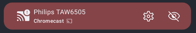

If the file is present on my phone I still get this for the first 10-15 seconds:
After that, the file sometimes starts playing, sometimes not.
Disabling the transcoding engine didnt help.
