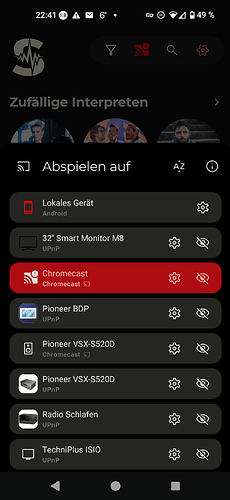

Hey, I’m trying to stream my music from my navidrome (subsonic) on my TrueNAS to my Pioneer VSX-S520D Receiver. But I can’t get a connection to it from Symfonium App 1.35.
I can play the music localy on my Pixel 5 with GrapheneOS, but not on any Chromecast or UPnP-Device.
I have a Google Chromecast mit Google TV HD, a build in Chromecast Audio in the Pioneer and some UPnP Devices.

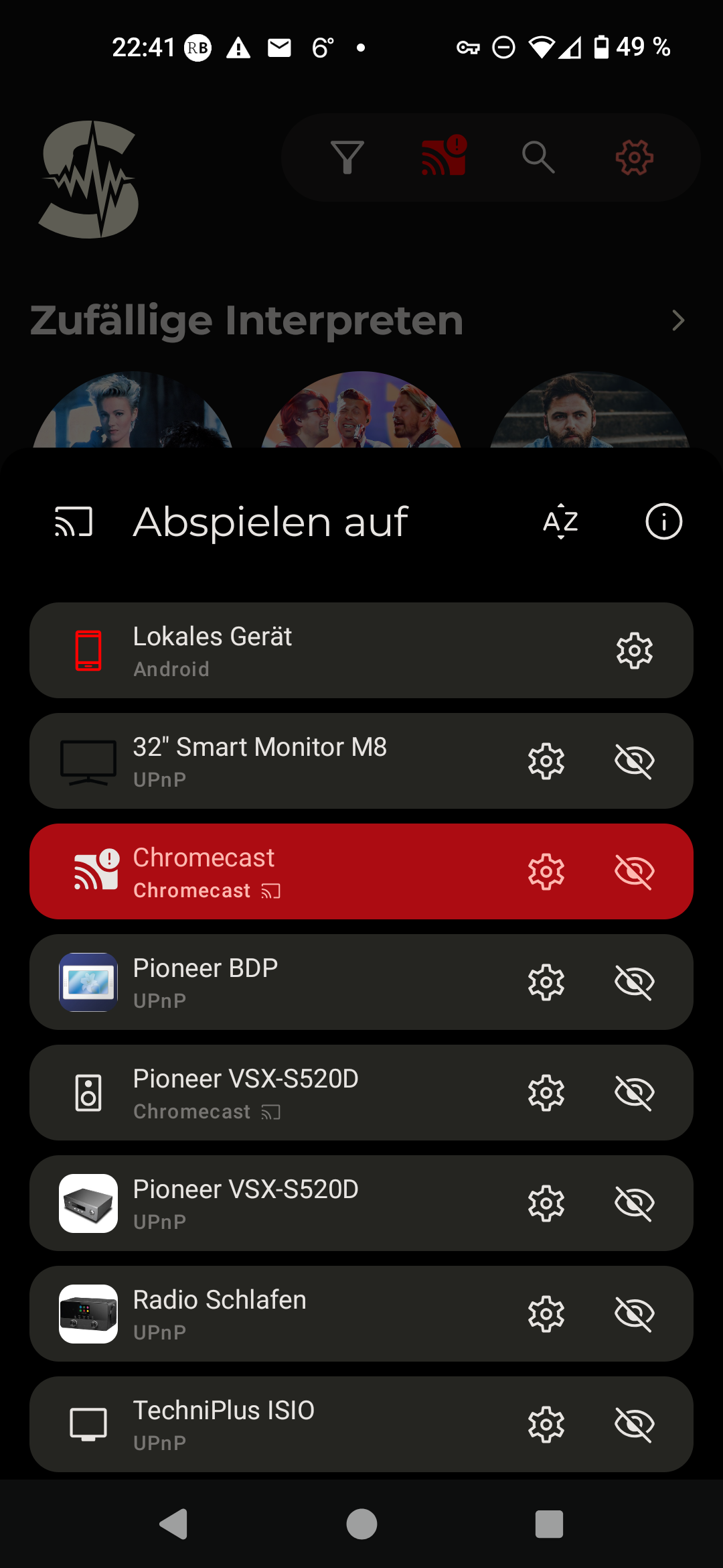

When I choose the Chromecast it turns red in the app and the casting-icon gets a !

2025-11-16 18:40:44.136 Error UPnPRenderer  Error SetAVTransportURI: error response: {faultcode=s:Client, faultstring=UPnPError, UPnPError/errorCode=716, UPnPError/errorDescription=Resource not found}
The upnp device can’t reach the server, you need to fix the dns or the network configuration or enable the proxy option in the renderer setting in Symfonium.
It’s probably the same issue for Chromecast, but I don’t understand why the session would disconnect without being disconnected on the TV that’s very strange, maybe you are using some special non official GMS ?
I’m running Headscale/Tailscale. Enableing the proxy otion made it work with UPNP and Chromecast.
