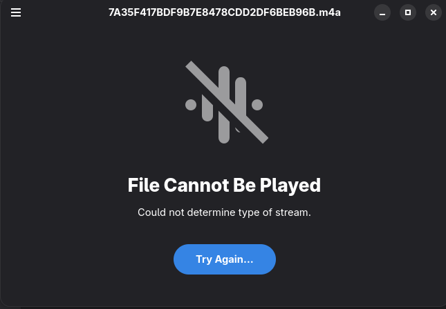

@Tolriq Thank you for your help and all the patience! The internal storage worked perfectly, but the SD card didn’t work as well. After I downloaded to cache (on SD) the file works perfectly, but after exiting Symfonium the file becomes corrupt. This doesn’t happen on the internal storage, and I verified this via my PC (i.e., the file turned corrupt right after exiting).
I’m still not sure what’s the issue, but the first thing I’ll try is buy another SD card and report back if I face the same issue. Thank you!!
