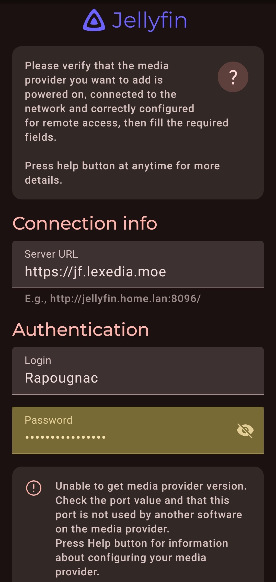

Cannot login with Jellyfin from Symfonium
I’m trying to log in from Symfonium through my jellyfin instance, but the app receives a 401 status code with the correct credentials. Logging in through other clients works flawlessly.
It used to work fine some months ago.
Upload description: Lexedia’s log file, using https://jf.lexedia.moe

I really don’t know how this is happening, tho, especially since JF sends no error whatsoever.
In that extract that is better the auth call timeout, are you sure there’s no issue with your proxy or some security that triggers with cloudflare ?
Okay, this is rather embarrassing, but apparently my firewall config got reset and so did WireGuard.
I didn’t really notice since “everything was kinda working” until I received this error from Symfonium.
So no issues from your side, I’m just really dumb, thank you for your time though, appreciate it.
